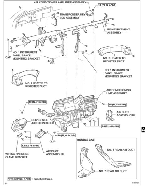

    Have you check if the tube that connects to pass side is correctly connected ?
    There is no setting for Pass side or Driver side. they are connected to the same system and air is pushed through them the same way.
    What if you set for air to come out through bottom vents ? are they doing the same thing (driver side colder ?)TruckACSetup.jpg

    How would I check the tube that connects to the passenger side , can I just crawl under the dash? Or would I have to remove the dash partially to have access to it ?

    You should be able to check this after removing glove box.
    Take a look at the picture I posted it shows you how that tube looks like.
