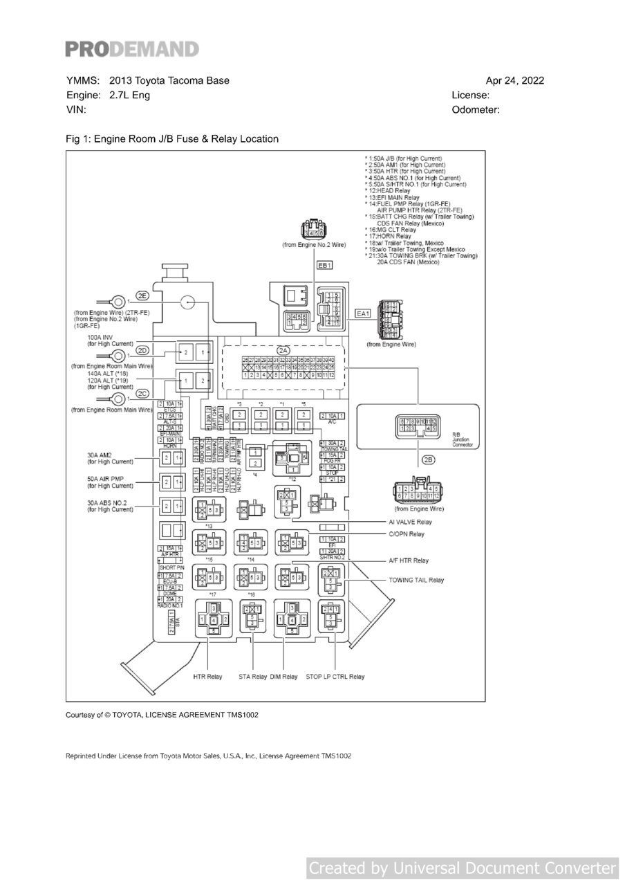

    There is no low side pressure switch, there is a combination high/low pressure cutout switch on the high side but it will not cause a flashing light.
    Does the compressor turn on for a few seconds and then turn off with a flashing A/C light?
    The flashing A/C light is when the A/C amplifier does not detect a speed signal from the compressor lock sensor after commanding the MG CLT relay on.
    Possible causes are:
    Open or shorted wire(s) in the lock sensor circuit
    Bad lock sensor
    Internal problem in the compressor
    Open or shorted wire(s) to the MG CLT relay
    Open in the wire from the MG CLT relay to the compressor
    Failed compressor clutch
    Belt slipping
    Failed A/C amplifier
    You will need to check your wiring
    The MG CLT relay should have power on pins 2 and 5 when the ignition switch is on, the A/C amplifier grounds pin 1 to turn it on.
    You can momentarily jump pins 3 and 5 of the relay to see if the clutch engages.
    Also check the wiring between the lock sensor and A/C amplifier.
    The sensor signal itself can only be effectively checked with an oscilloscope.
