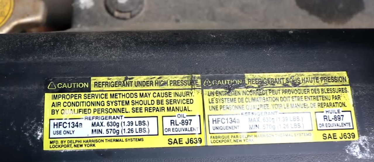

    On my friends pre facelift (pre 2012) 2nd gen it is on the passenger side of the fan cowl... I assume the specs are the same.
    This is just a screen grab from a chris fix video where he does the AC on a 2nd gen. I looked for mine right now and could not find it lol.

    Maybe they come off easy with the engine bay heat and such... I couldn't find mine either. Mine didn't have a clear outline like that though.

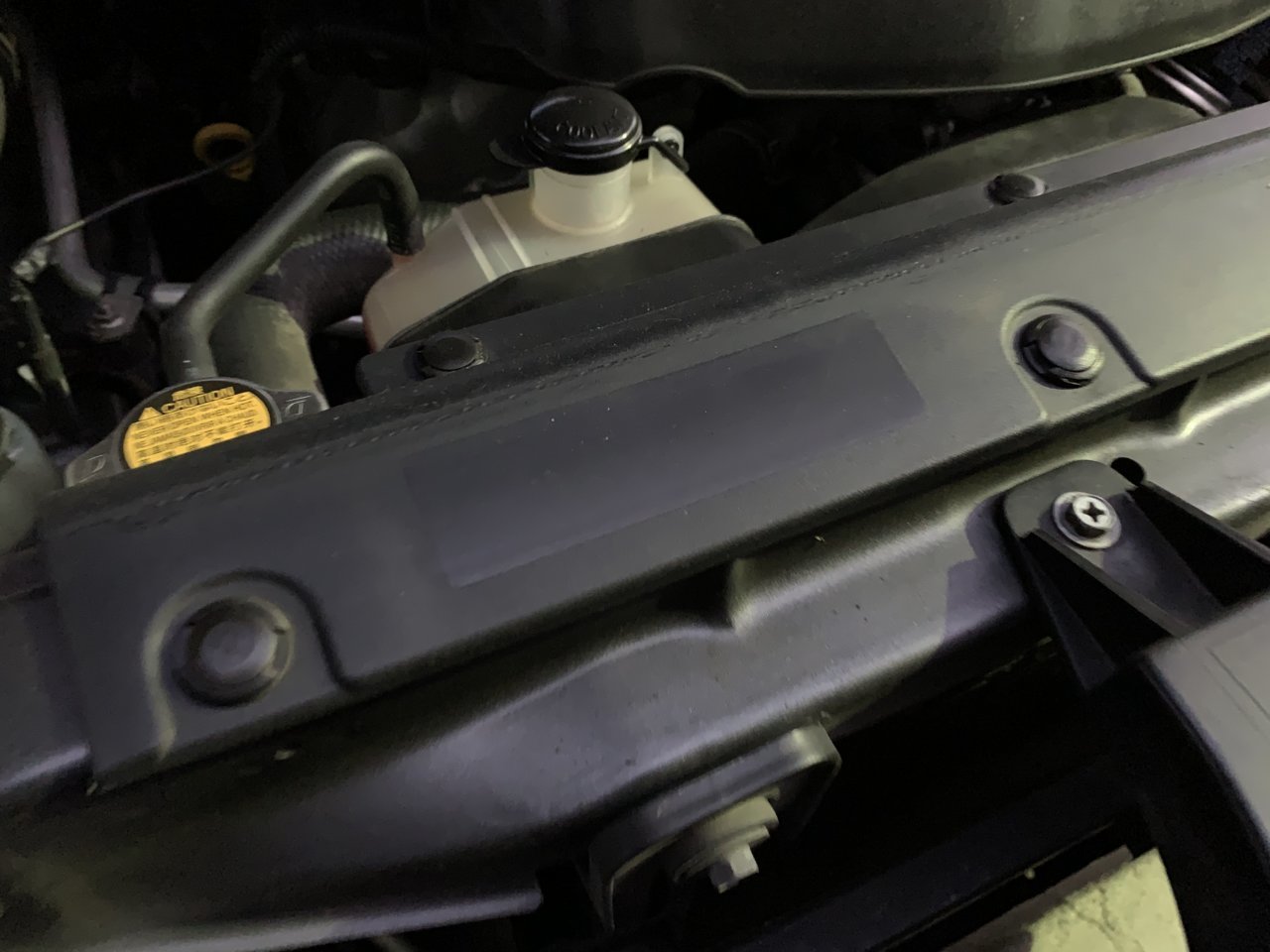

    This seems new. Like newer than the rest of the truck under the hood. Everything underneath it though is not.
  13. Aug 7, 2019 at 7:12 AM
    Taco'09
    Taco'09 Well-Known Member
    Dec 31, 2008
    #12073
    1,876
    See that nice shiny rectangle area on the plastic cover? Go get this part number, 11298-7570, and you too can have the label.

    22 oz of pure R134A. Unless you are sure you lost oil, and how much you lost, don't add any.
