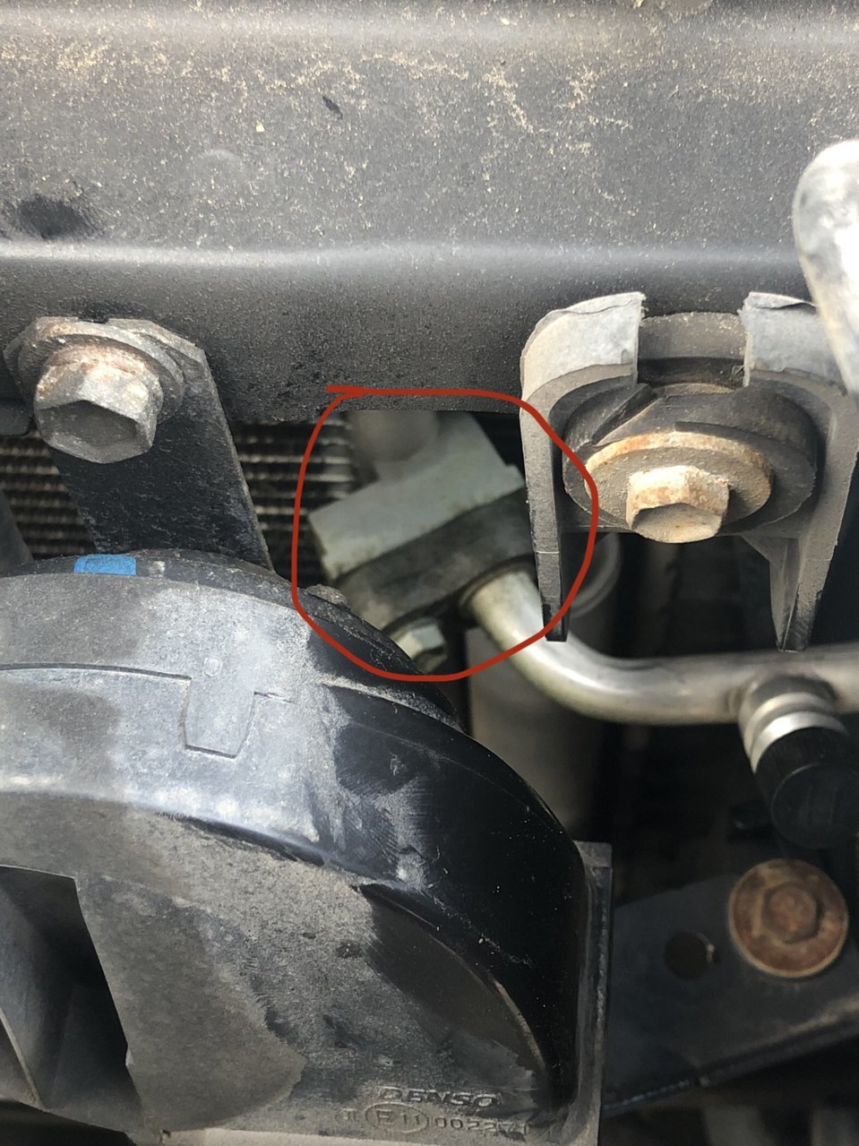

    81BCCF9F-EEEC-4C73-B272-EE5D9C336724.jpg So I took my truck in because my AC wasn’t working very well and come to find out a have a leak from this line here where it connects to the condenser.Toyota is saying I need to replace the whole line.
    What I’m wondering is if there’s a seal behind that fitting that may not be good anymore or if i actually need to replace the whole line .
    If it is the line I’m going to change it myself and I’m wondering if it’s as simple as unbolting and bolting on the new one. Any tips are appreciated.

    There is a seal but it may not be one your can source by itself and I'm not sure where your would even find the part number of the dealer is saying that the whole line needs replaced. Repairing the AC system requires some specialized tools and equipment that the average home mechanic wouldn't have.

    There are usually special O rings connected to that line. Unfortunately, out of personal experience, just have an AC pro take care of it. Replacing the line is worth it in case there is a rupture you can't see.

    There's probably an Oring under there. But I, like others have never had a good time with messing w AC systems. Changing the part is one thing. But charging etc, I always struggle w.

    Recovery, cleaning, vacuum drawdown and testing are things most shade trees can’t or don’t know how to do properly. Professionals will know how to test, and more importantly will know what ALSO needs to be replaced (hint: should also be the receiver/dryer).

    That’s crap replace the pipe. You should just need the seal. It comes with the pipe, but appears also available by itself. You will need a certified a/c guy with and Evac and Recharge machine to get a vacuum on there to suck down and left freon and store it, replace the part, then fill and charge. The standard labor for an a/c evac and recharge is 1.4 mechanical hours. The part should be cheap as the labor to replace it. If the say you need the whole line, ask exactly why the seal cannot just be replaced. You will probably have to pay extra for lost Freon, usually $40-90.

    Unless there’s damage to the line I can’t see from this pic, I would try replacing the line seals since they should be a heck of a lot cheaper.
    Definitely try an independent shop that can recover your Freon since this type TOYOTA Freon is crazy $$ expensive.

    There's a $3 O-ring in there: https://parts.toyotaofnorthmiami.com/p/PACKING/69345100/8181704010.html
    However you need to take it to a shop with an A/C cart to drain and fill the correct amount of refrigerant. The O-ring mating surfaces need to be sanded clean of corrosion or it'll leak again within a year.
