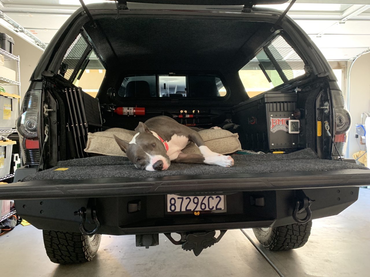

    OP what kind of box is that on the right side of the bed?
