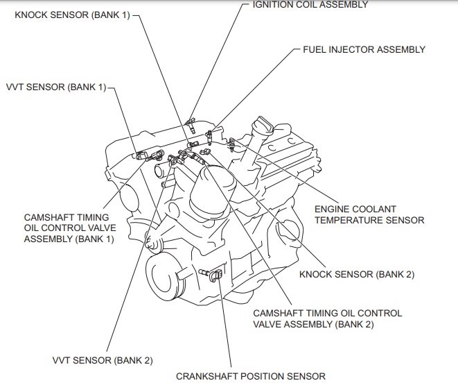

    Have you looked under the hood in the valley of the engine for rodent damage?
    Those codes are circuit codes, I bet your gona find some chewed wires.
    The P0020 is for the Bank 2 (Drivers side) Oil Control Solenoid.
    The P0348 is for the Bank 2 (Drivers Side) Cam (VVT) Sensor.
