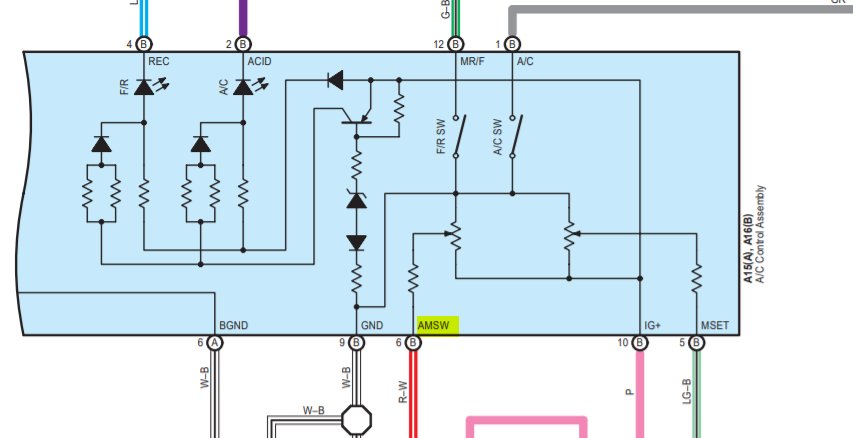

    Since toyota doesn't use vacuum, you may add a voltage sensing relay to energize a solenoid valve with a pickup close to 13V, since the recirc you will expect 13.0 to 13.5V in max cool position at AMSW terminal.
