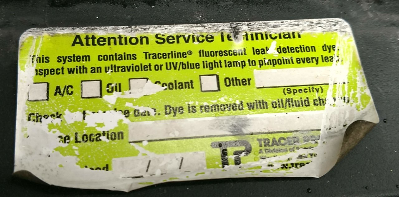

    Look under your hood e.g. above radiator where a dealer may even have put a label/sticker indicating tracer has been added. Possibly the recharge guy at dealer added tracer, in 2015 my toyota dealer recharged my leaky system and put the sticker shown here on. Of course my recharge lasted 2 weeks.
    If the magic additive/tracer that glows under UV light is in your leaky system, a $15 UV flashlight (walmart even) will make things around the leak glow green. (attempts to capture this w/camera are foiled by some scientific/wavelength reason).
    If yours failed like mine did, and has tracer, try to find the glow around the compressor front shaft seal .....visible all around the pulley/side. If so, buy a Denso compressor from RockAuto BUT you'll need a buddy or shop with a vacuum pump and recharger+gauges?(i forget)..., and even an extra O-ring last-minute that for some reason didn't come with the compressor, if you dare do it yourself. The compressor attachment bolts are are not real thick... I felt like I almost broke my bolt removing it, IIRC I gave the engine block a brief heat/oxy-acet torch and got it. Dealer quote including compressor AND condenser because they THOUGHT i might need one: $2500. My cost around $300. I'm amazed it's still holding its charge 3 yrs later.
