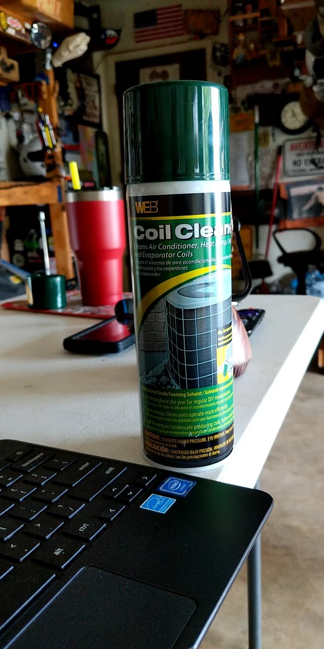

    They actually make a condenser coil cleaner for cleaning residential AC units that you can get at HD or Lowes. Comes in a spray can. I have used that with good results. Spray it on and try not to get it on the paint. I highly recommend removing the grill (it's two bolts and two plastic pins) so you can get better access to the area. Let it sit for a bit and then take a spray attachment on the hose and blast the hell out of it. You should be able to see through it when you're done. If there's stuff inside that keeps light from shining through air won't get through either.
