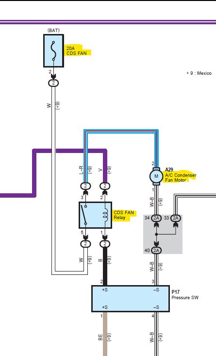

    Here is the fuse and relay for the condenser fan. Upon a closer look, the AC fan fuse and relay are "Mexico" only. I don't know if that means the truck was built in Mexico or sold there.

    If the diagram @HAVOC posted is correct pin 2 Blue/Red should be fan power and pin 1 White/Black should be ground.

    Should just be a 2 pin connector.

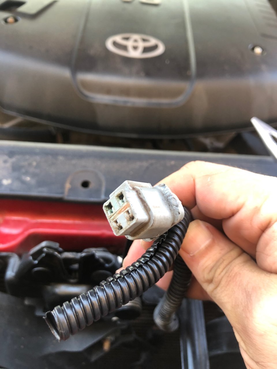

    Ohhh good to know .. In my case it is a 4 pin female connector on the fan side and 4 male on the wiring, But there is a connector just hanging next to that 4 pin male, So what I think now it must be a fan adapter from previous owner on a possible failure with the factory(I guess), I will get some pictures later today and post it here for better understand. Thank you people, I appreciate it

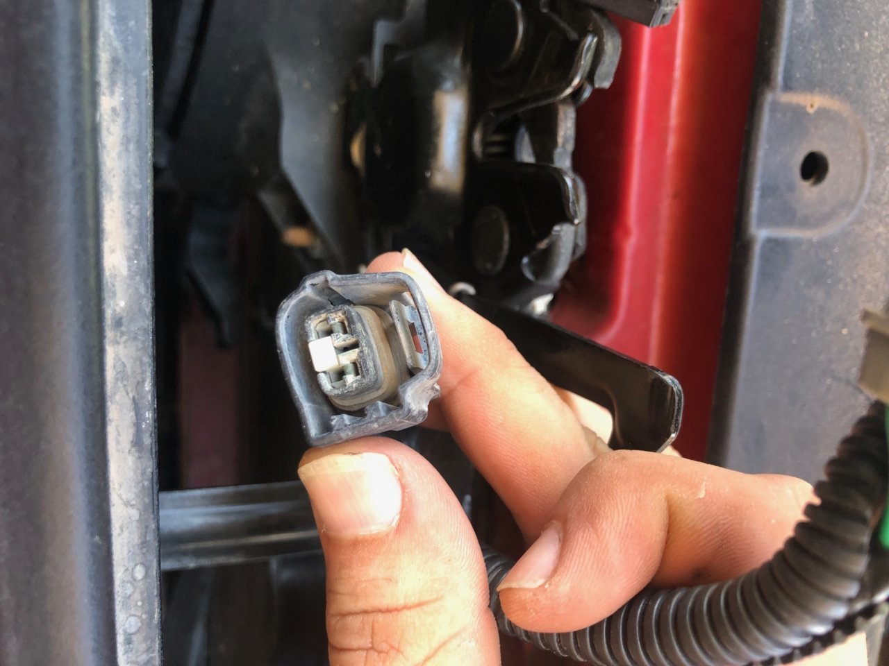

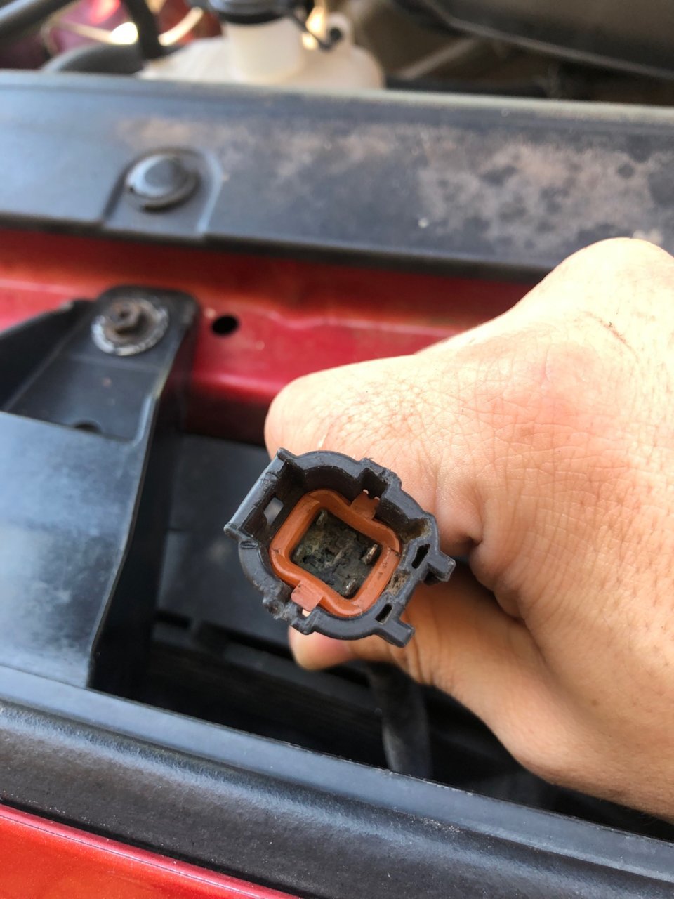

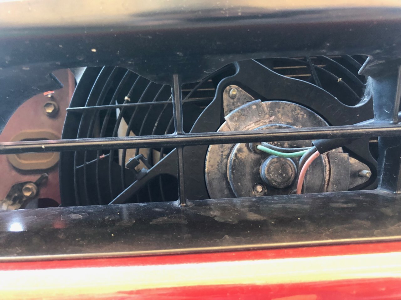

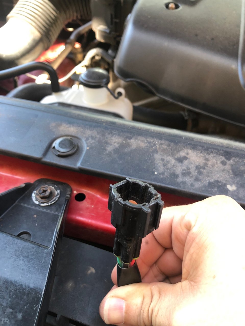

    Hey Guys this is what I got. This is the fan installed on my truck, 4 pins connector, I assume it is not OEM Condenser fan.
    This connector is the one is hanging next to the one is connected to that 4 pin

    Weird looks like an OE connector, those pins look awfly corroded though your problem might be right there.

    What color wires in the 2pin plug?
    The 4-pin does not look like a factory connector, typically a denso/weatherpack style connector
