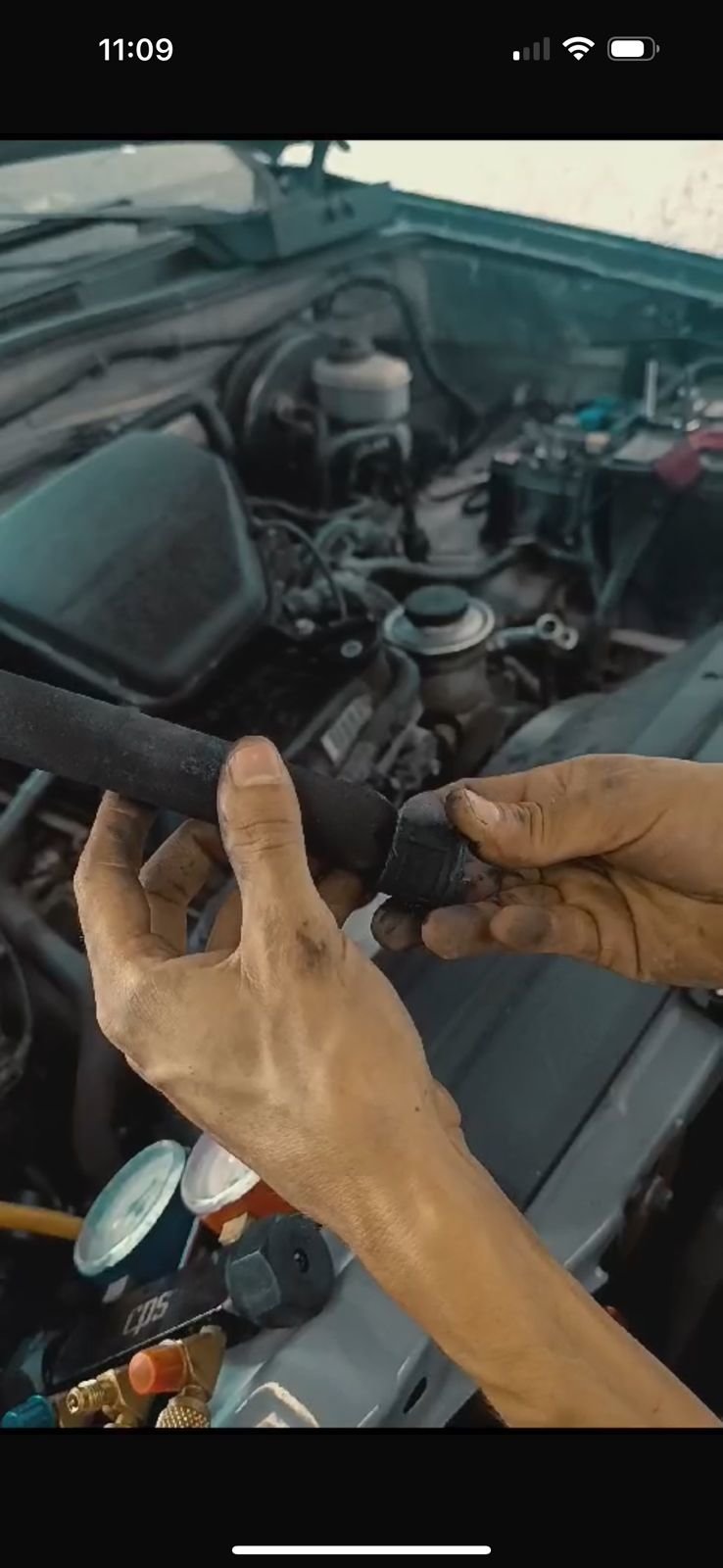

    Update:
    Well I took the truck to a mechanic to check inside the AC lines and the condenser. Looks like the compressor is damaged due to overheating, the oil is all dirty so the receiver drier filter and condenser. I will order new compressor, condenser and filter sadly. The will need to clean the AC lines and hope the evaporator is still in good condition. For some reason I am not surprised after 200K miles of use.
    WhatsApp Image 2024-08-15 at 12.10.11 PM (1).jpg WhatsApp Image 2024-08-15 at 12.10.11 PM.jpg

    That will do it, filter/dryer is completely plugged.
    Kinda looks like someone may have put stop leak in it at some point, that stuff will kill an ac system like that.
