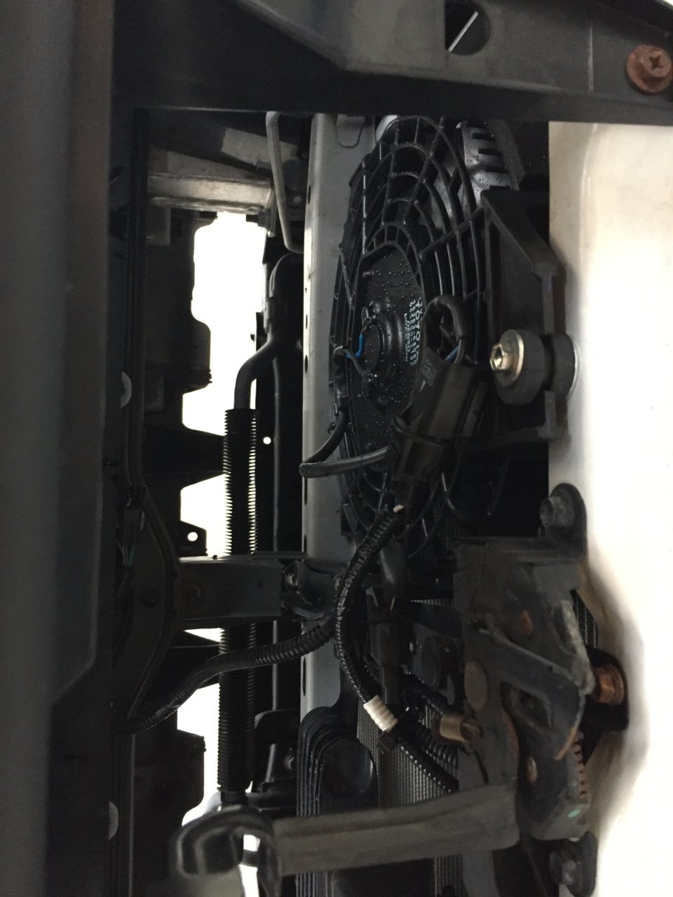

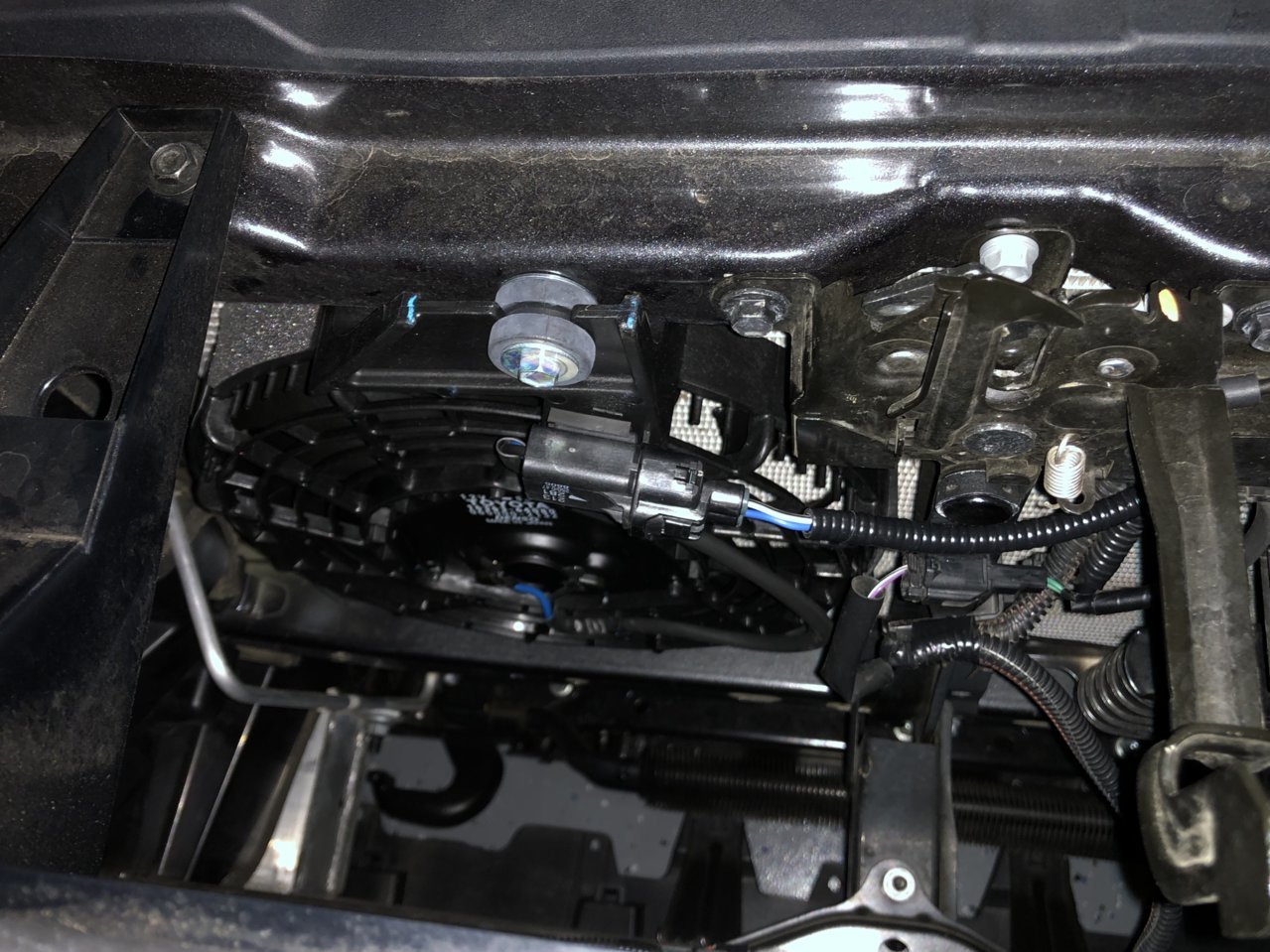

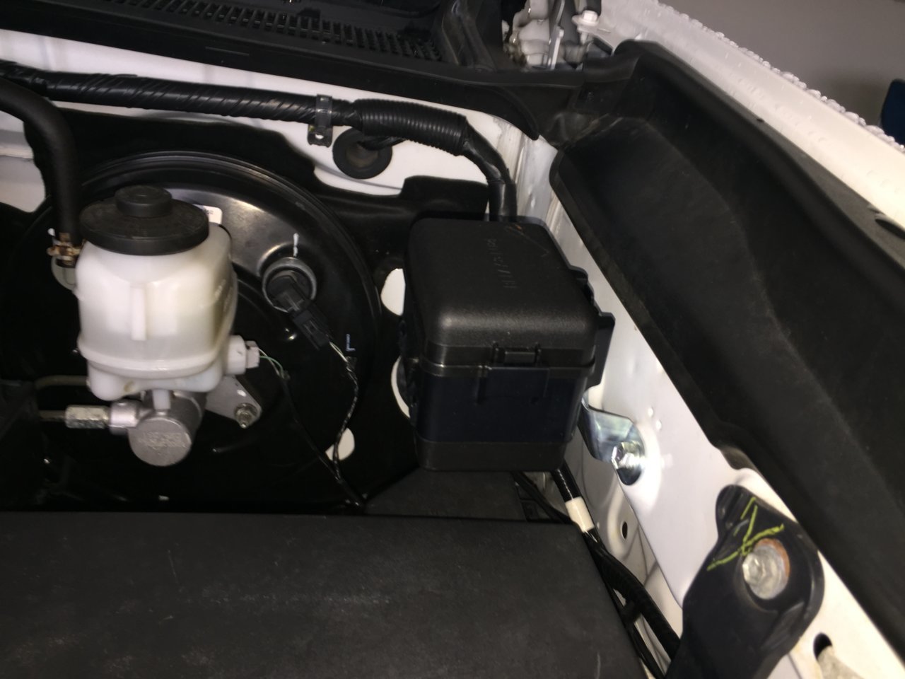

    Got the truck back after two days. They installed an auxiliary fan in front of the radiator and the accompanying relay box on the driver's side. Invoice is included. Cant really testIMG_9232.jpg IMG_9238.jpg IMG_9243.jpg it as it is 45 degrees outside.

    Picked up my truck tonight after they performed the tsb 0063-18. It took them 3 days! It will probably be a while before it’s warm enough to test though. I included a pic of the new fan they installed and the work order.
