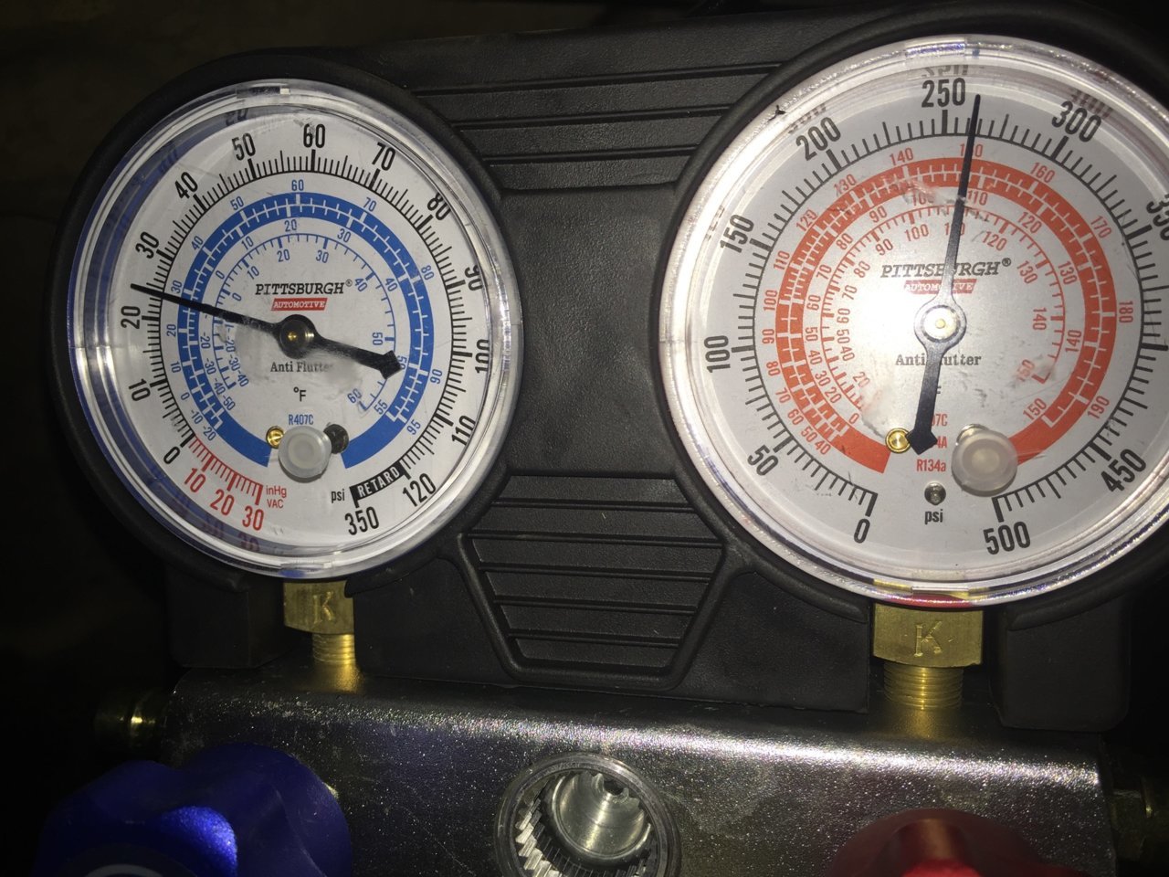

    2002 Tacoma 2.7L 4x4 Manual. All stock.
    My AC has not been getting real cold at idle - 56 to 60 degrees. Get's pretty cool going down the highway. I checked the L/H pressure tonight when the temp is 85 degrees and this is what I am showing which looks to be in specs? Did this at around 2000 rpms.
    I replaced fan clutch last week hoping that would help, I have much better air flow under the hood now, but still not staying cold at idle.
    I used gentle water pressure to wash condensor down and my vent temp went down to about 45 degrees, but climbed back up once it dried off.
    Not really sure what to do next? Not real big on taking stuff to mechanics, but I understand AC's is sometimes one of those things better left to the pros.
    Anything else I should be doing before I take it to a shop? Hope the picture attached correctly.
    Thanks!

    Are you suggesting I need to charge the AC? I have a can of refrigerant, I just thought my numbers were in spec.

    I'm just simply wondering if any other shade tree mechanics like myself would check anything else prior to taking it to a shop?

    you have your answer but did recognize it...
    "I used gentle water pressure to wash condensor down and my vent temp went down to about 45 degrees, but climbed back up once it dried off. "
    modern auto AC condensors are made up of lots of really small tubes and they get blocked not allowing the gas to shed its heat. The condenser is the garbage collector of the system.
    you have a set of manifold gauges all you need now is a vacuum pump and you can do the job yourself. If you go to a shop they are going to want to replace everything to reduce the chances of a come back. If you do do the job yourself look at the o rings on the lines very very carefully... sometimes the o rings the come with the component look correct but are just a bit to small to seal properly.

    High does look high and Low looks low.... Whats the Low side rising to and falling to?
    I have a mini cooper which was barely blowing anything earlier this summer. I hooked up the manifold gauges and they literally did not move while the compressor was always running. I put a good 8oz of freon into the system and began raising and falling. You should get a good 30 psi rise on the low with a correctly charges system between compressor kick ons.

    My compressor isn't kicking off and on much, constant run. I am seeing it drop probably by 30 when I rev it up.
    Should the low side be 40-50 when running at 2000? It will probably jump up to 60 or 70.
    I am going to research more on the expansion valve. Thanks for this idea.

    Drz I think it just doesn’t allow it to dissipate the heat. So driving around my ac temp is 52 degrees and it takes forever for it to get there. Sitting still it climbs up to mid 60s and is just unbearable.
    I’m adding me Freon and re cleaning condenser. then if that doesn’t fix it off to shop. I have a feel they may tell me condenser.
