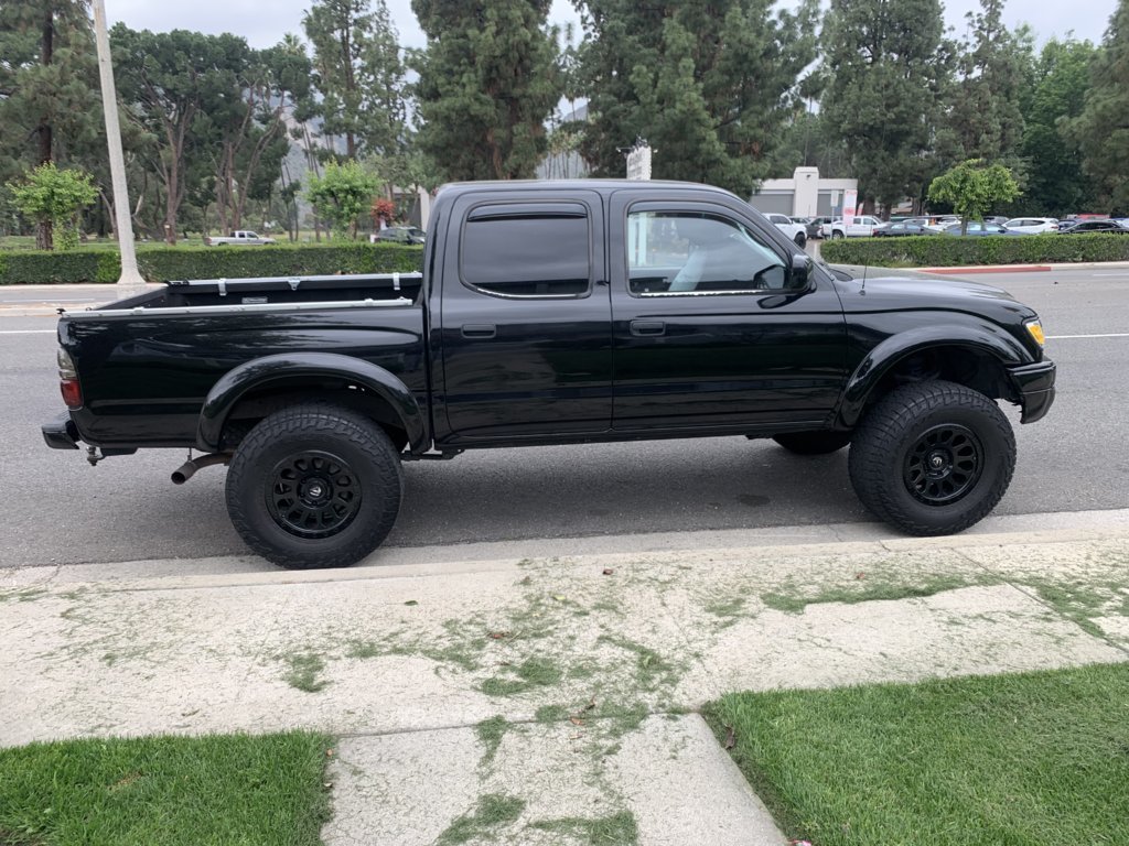

    IMG_2812.jpg Hey there everyone, I have a 2003 3.4v6 4 door Tacoma with 251,000 on the odometer, the AC blows slightly cool air. I weld for a living so after work I would like my AC unit to run cold. I live in Southern California so summer is pretty hot here. Can anyone recommend what to do about my AC. I don’t want to sale my truck yet but I don’t think I can go another summer with it being so hot . Any info would be greatly appreciated.
