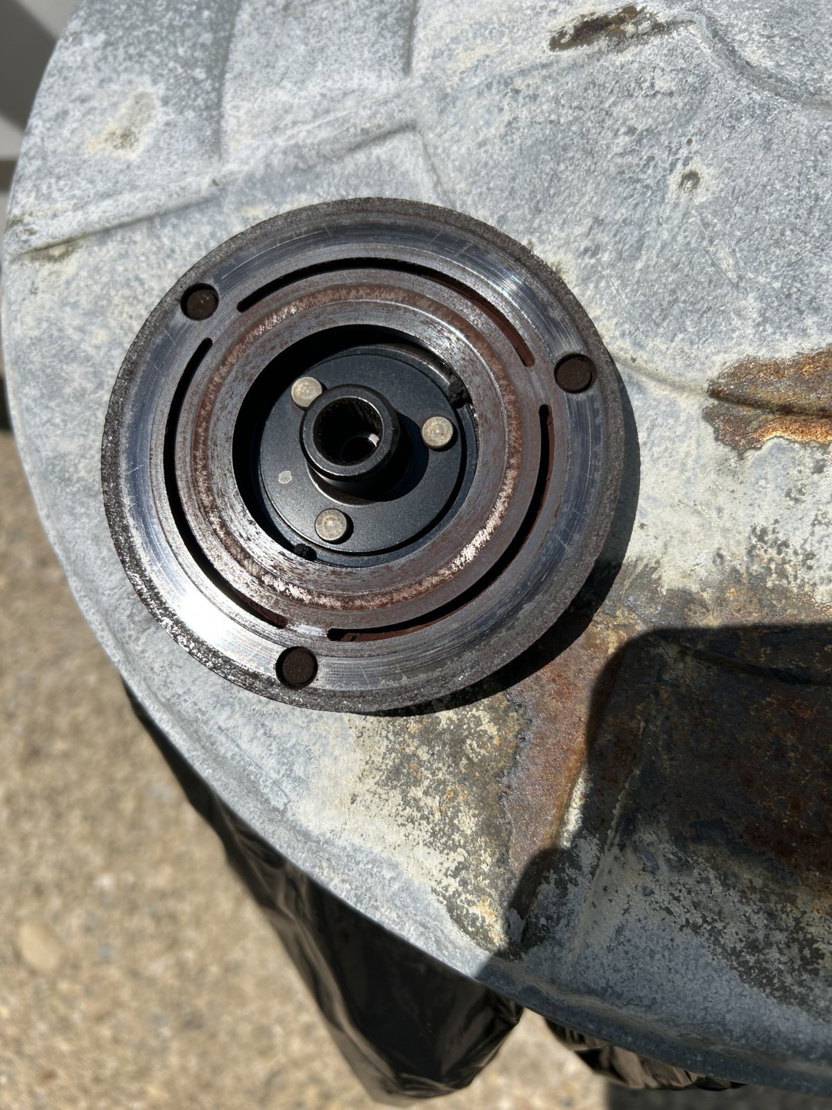

    Mine AC went out also. Every time I turned on the AC it sounded like belt grinding. I changed just the front plate as shown in the pic and no grinding and works perfectly!
    I bought a new belt and going to change it while i am here. quick question...
    I of course had to take off the skid plate. One of the bolts snapped off so I was just thinking about leaving it off. Is that ok to do that? I won't be doing any off-roading so no worries there. Just worried about if it will affect the cooling of the motor without it being on there.
    thanks!!

    Congratulations!
    Might you describe how difficult/easy it was to replace and get the shims right; for others to better understand how easily DIY this fix is?
    I do not think leaving the skid plate off will make a noticeable difference to cooling. Mine has been removed from an '09 for allowing a plow frame, and although the frame makes a turbulence, that is different from just removing the skid plate alone; I can say that I have had zero overheat issues, and my experience includes HEAVY towing.
    Again, congratulations on saving a Bundle by replacing only the part of the compressor that failed!!!

    The hardest part of if all was routing the new belt.....until...wait for it......after confirming it worked great i went back under to to make sure to snug up everything and i snapped that small bolt that holds it all together. F**ck!! of course with not much room i spent 3 hours trying to extract what was left with some Dremel tools and prayer. It was the difference between a 2 dollar bolt and 1,000 for new compressor install at a shop because that bolt threads into the end of the actual compressor shaft. I finally got 4-5 threads with the new bolt and put a few washers and some RED Loctite. at 136,000 miles it should last another 100,000?
    the original had 2 shims in it so i just put those in the new one and it seemed fine and didn't bind at all.
    Hell after that mess I will appreciate extracting out just one skid plate bolt that you can actually reach. I kinda like the look of the skid plate the more that I look at it.
    Reminder to buy a 90' drill next time. Maybe Harbor Freight has one.
