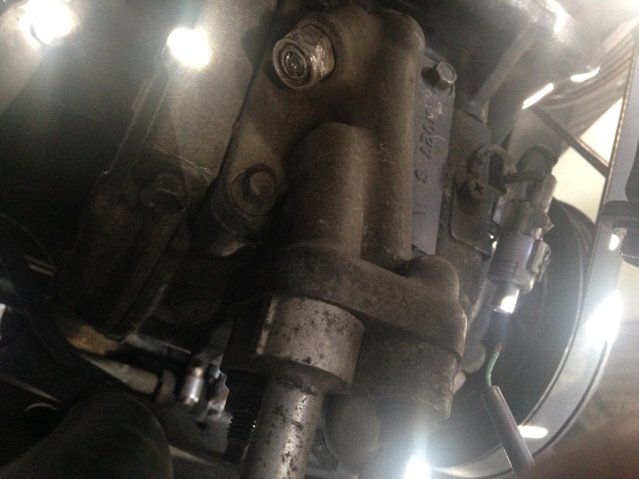

    Ac compressor not working.
    I found a wire disconnected, but I don't know where it goes. Took 2 pics and wonder if some one can help me to saying where it goes. I think this is the obvious issue why compressor is not turning on.
    First pic, where I think it goes.

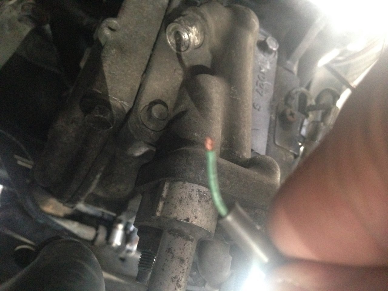

    Second pic, the wire in close up.

    yes that connector is where it is supposed to go... good luck... not a lot of room there.

    Thanks. This morning I took the cap and put the wire in and after some tries the clutch restarted to work.

    I'm guessing here, but is that the low refrigerant cut out switch.?
    If the A/C is low on refrigerant, the switch will think the pressure is low and not allow the pump to cycle.

    Did you actually splice it back in? The wire is supposed to be crimped to a terminal inside the connector. (When built it's crimped onto terminal, then terminal is inserted into connector and hooks in.)

    Gonna be tough.
    To replace the sensor, all refrigerant will be lost. Gonna need a pro to evacuate the system to do the repair properly.

    It looks like the broken wire is at the connector to the magnetic clutch on the compressor, so no need to worry about the low pressure switch.
