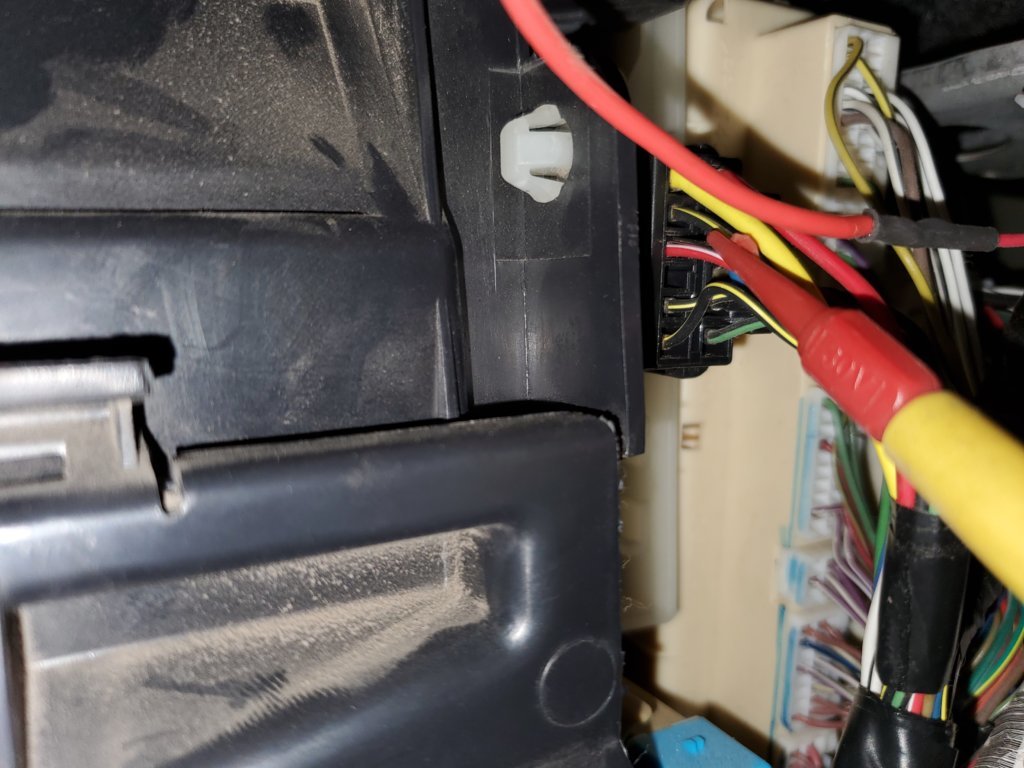

    If you have already replaced the Lock Sensor then you need to verify circuit integrity between the Lock Sensor and A/C Amplifier and check the Lock Sensor circuit for a short to Ground.
    It's really easy to backprobe the Lock Sensor circuit at Connector IH1 Pin 10 (Red/White) behind the glovebox.
