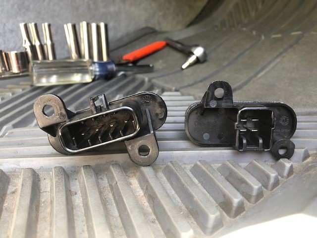

    the Toyota parts guy, stated there is a more recent update. so i bought the OEM stuff. it wasn't bad.
    i got a new harness, part number 82141-04Q80
    and the new Resistor part number 97138-04070
    it looks like the parts are from the 3rg gen trucks?
    here is the rub. the colors are not a perfect match. YAY!!
    the new harness has slightly different colors. is this right? is this how i match it up.
    (new)Blue (old)BLUE
    (new)green (old)GREEN
    (new)White (old)Grey with a pink stripe
    (new) Black (old)Black.

    I’d make sure the new resistor will even fit first.
    The only way I know to find the correct matching colors would be to do a resistance test between the pins. The more resistance the lower the speed. Then match the wire colors to the pins.
    I don’t even see a G/Pk wire listEd for the blow motor on any of my diagrams?
    Maybe I’m just over looking it?
    Maybe @Jimmyh or @Muddinfun know.
    I don’t have access to the plug/PIN number on a 3rd Gen.

    Yeah, see if it fits first.
    We’ll try to figure out the rest, if it fits?

    This may help:
    From here: https://www.tacomaworld.com/threads/fan-speed-switch-not-working.70275/page-19#post-23001342

    Yep, Jimmy's pic should be right. The consensus a while back was that you match white/black to white/black and then after that you match up colors but ignore the stripe color.
