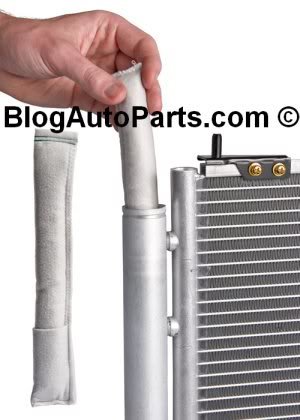

    ^^^ In that post some folks suggest the "A/C Dessicant Element" is possibly clogged and reference the part in the picture below.
