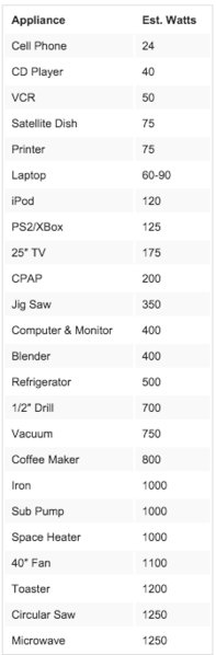

    must be a misprint on iPod 120 watts....more like 1.2 watts.
