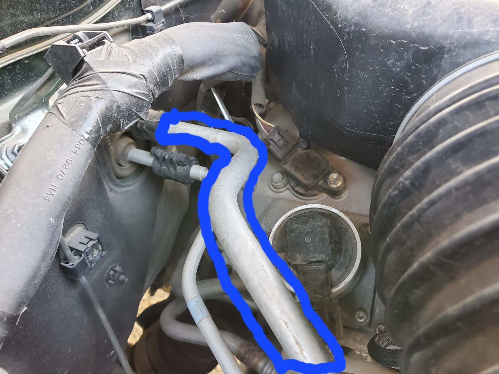

    check the high pressure side hose pipe. If its covered in road grime and oily looking I bet the rubber hose portion has a pinhole leak. Mine leaked from there and it was a very slow leak.
    this is the AC line that connects from the condenser to the compressor so it goes from a hard line off the condenser to a rubber line, hence the part name "hose pipe"
