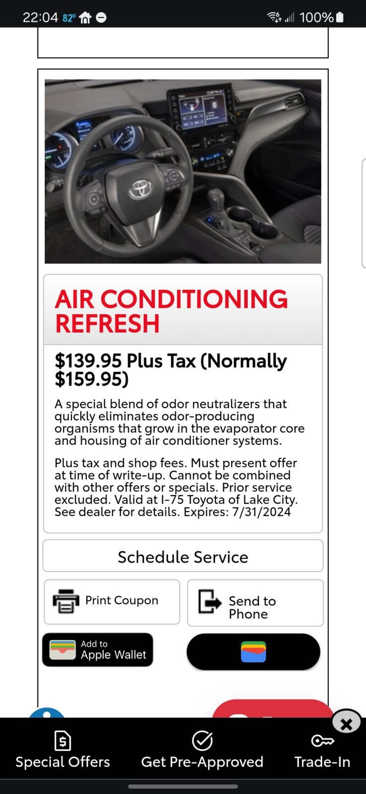

    Check this out
  12. Jul 11, 2024 at 3:12 PM
    #32
    Williston
    Williston Unknown Member
    Aug 21, 2021
    #374833
    2,680
    2014 Tacoma 040 SR5 4x4 DC SB V6 AT5 Tow Pkg Entune+ Mostly stock with a couple of non-OEM nods.M mods.
    Stock (99.999%) OEM Bed Floor Mat, Front Bed Rail Cargo Net and hooks, Auto-Dim mirror w/Compass and outside Temperature display, TRD Pro Grille, Uni-Filter air pump modification, WeatherTech floor liners f/r. (winter) OEM All-Weather floor mats (summer).
    I've seen YouTube reviews on this and it's a legitimate Toyota treatment kit, IF you are getting funky smells every time you initially start it up or run it for for a few minutes. It cleans out all the mold, mildew and other organics that can build up on the evaporator and closed-in housing over time due to all the moisture that forms. If it's draining ok (look under the truck for puddles) it shouldn't be an issue. I helps if you manually turn off the AC compressor and run the fan at full on outside air for a few minutes before shutting down. This heats everything up in there and helps to evaporate the moisture in there. 99% of the time I use the outside air setting so mine is good. If you're not getting the damp odors, you prob don't need to spend the money.
