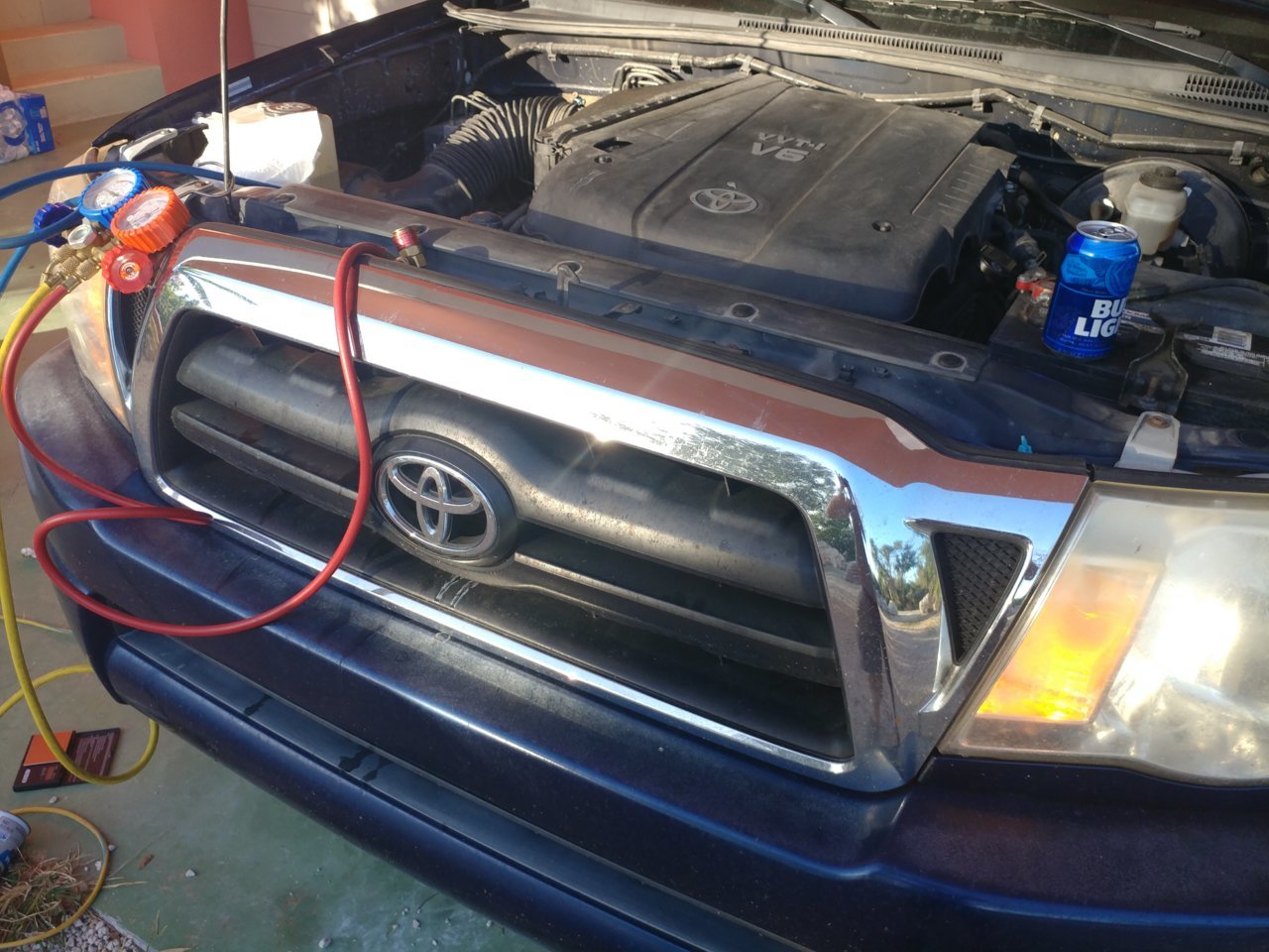

    Good deal, but don't let it sit overnight under vac. Let the pump run until you are ready to recharge the system. Won't hurt a thing, and you will get rid of every minuscule bit of moisture.
    Jimmyh likes this.
  2. Mar 25, 2019 at 4:40 PM
    #22
    CurtB
    CurtB Old Timer knowitall
    Dec 30, 2014
    #145266
    7,203
    Curt
    Kansas
    2010 Tacoma SR5
    To add, -25 ain't right, should be -30. But, analog gauge. Prolly not accurate.
  3. Mar 25, 2019 at 4:43 PM
    #23
    2007 4x4
    2007 4x4 [OP] Well-Known Member
    Sep 20, 2013
    #112869
    95
    07 4x4 DCLB SR5 and 06 Reg Cab 5 Lug
    Thanks CurtB - so basically no issues running the vacuum for 24 hours?
  4. Mar 25, 2019 at 4:59 PM
    #24
    CurtB
    Dec 30, 2014
    #145266
    7,203
    Curt
    Kansas
    2010 Tacoma SR5
    No, just sit the pump where it can get some cooling air. 24 hours is overkill, but won't hurt anything but the life of the pump, and the oil in the pump. The pump oil should be changed after every vac pull, so they say. ;)
    Jimmyh likes this.
  5. Mar 25, 2019 at 7:23 PM
    #25
    CurtB
    Dec 30, 2014
    #145266
    7,203
    Curt
    Kansas
    2010 Tacoma SR5
    I just watched this vid, wife is watching bs on TV. lol. Spot on, just a couple things I do differently. Just make sure you close the manifold valves before you shut down the vac pump. Burp the air on the yellow hose by loosening it at the manifold if no valve there like in the video.
    Ok, refilled to the proper weight? Close the can valve, then close the high side valve. Slowly open the low side valve to bleed the high side hose into the running system. This is the only way to get the exact amount into your truck. Does it make a big difference, no. does it make a difference, yes. It's maybe an ounce one way or the other. trust me, at 21 oz it matters.

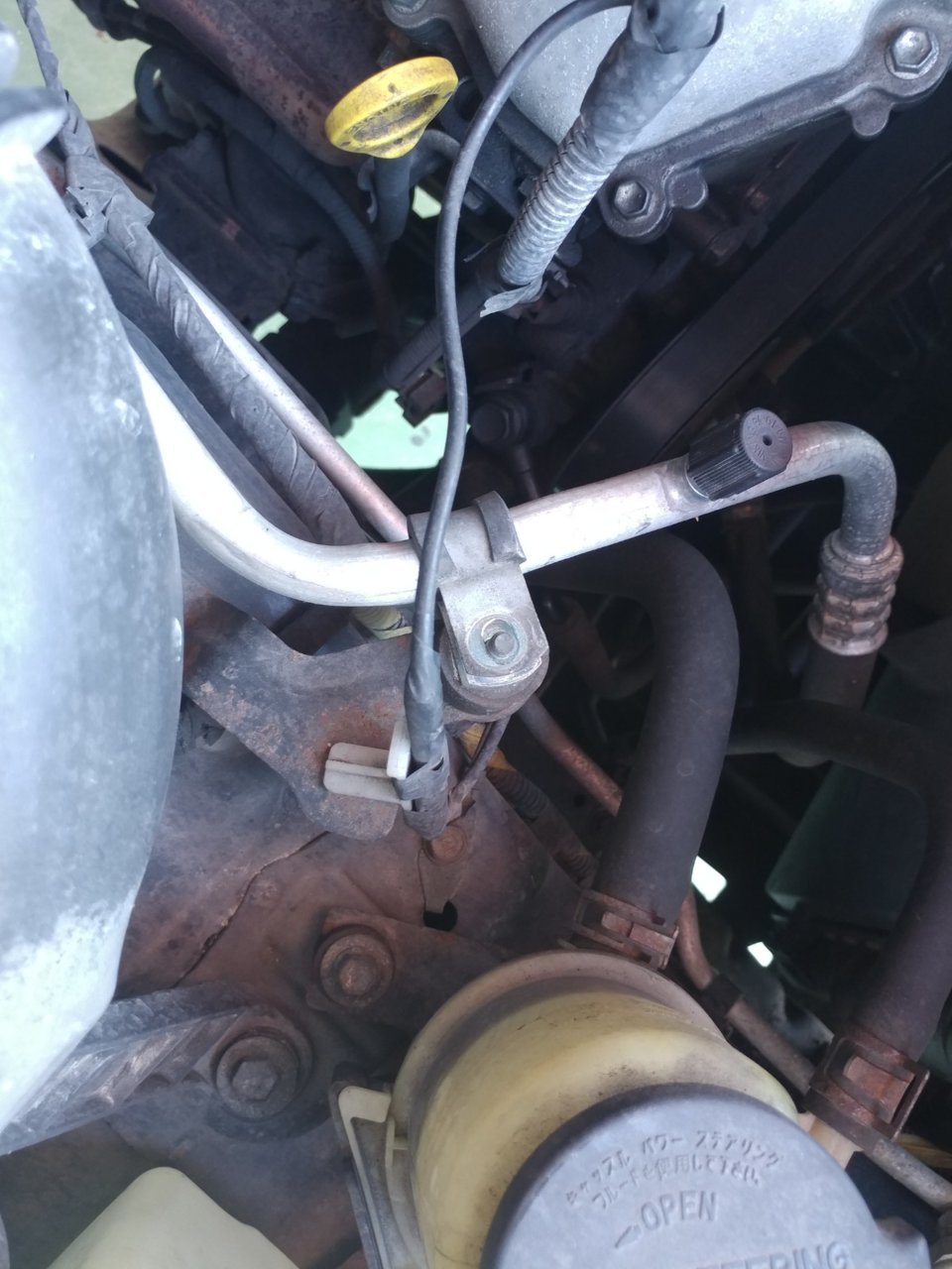

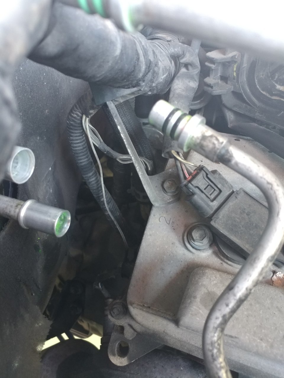

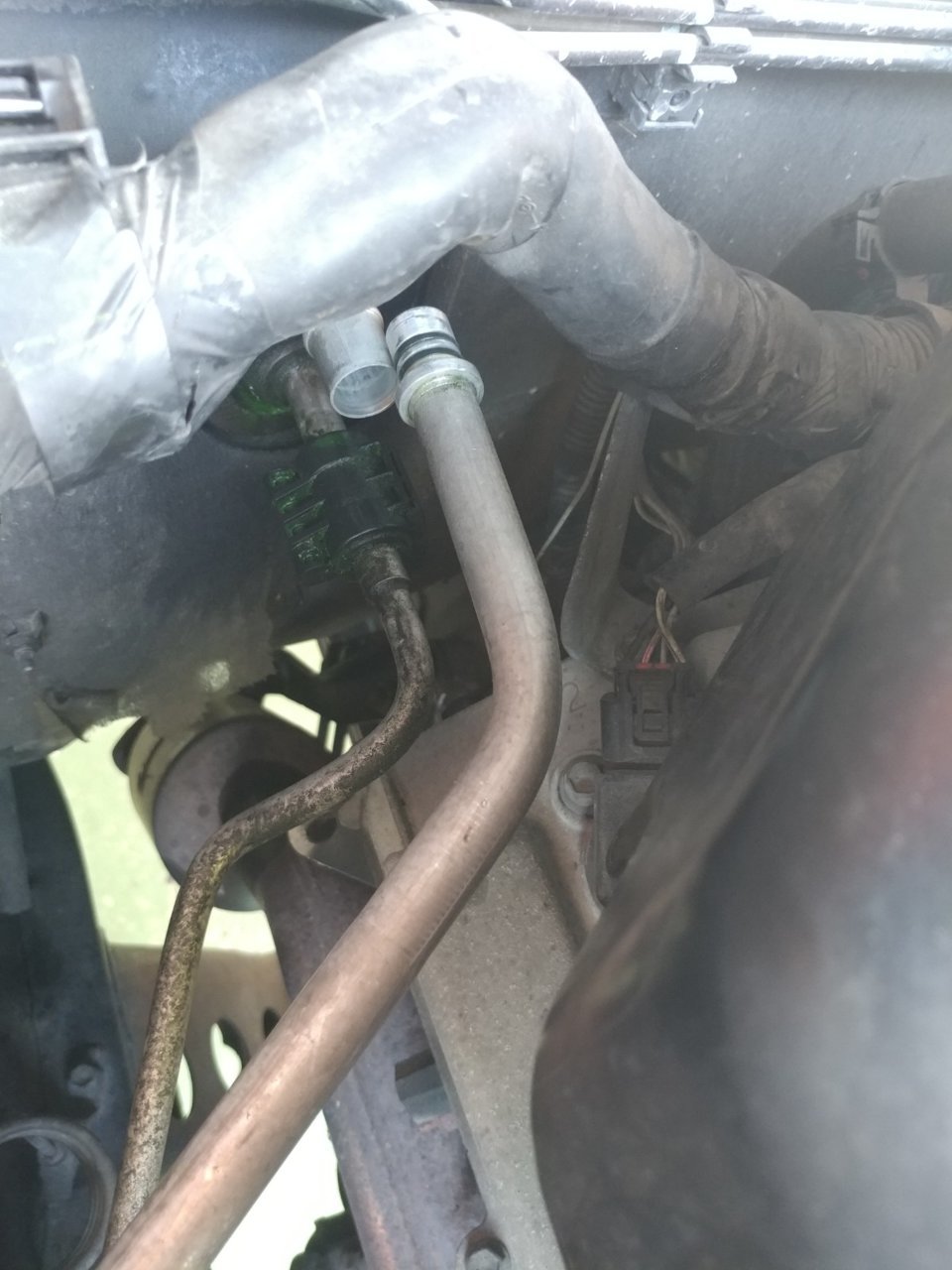

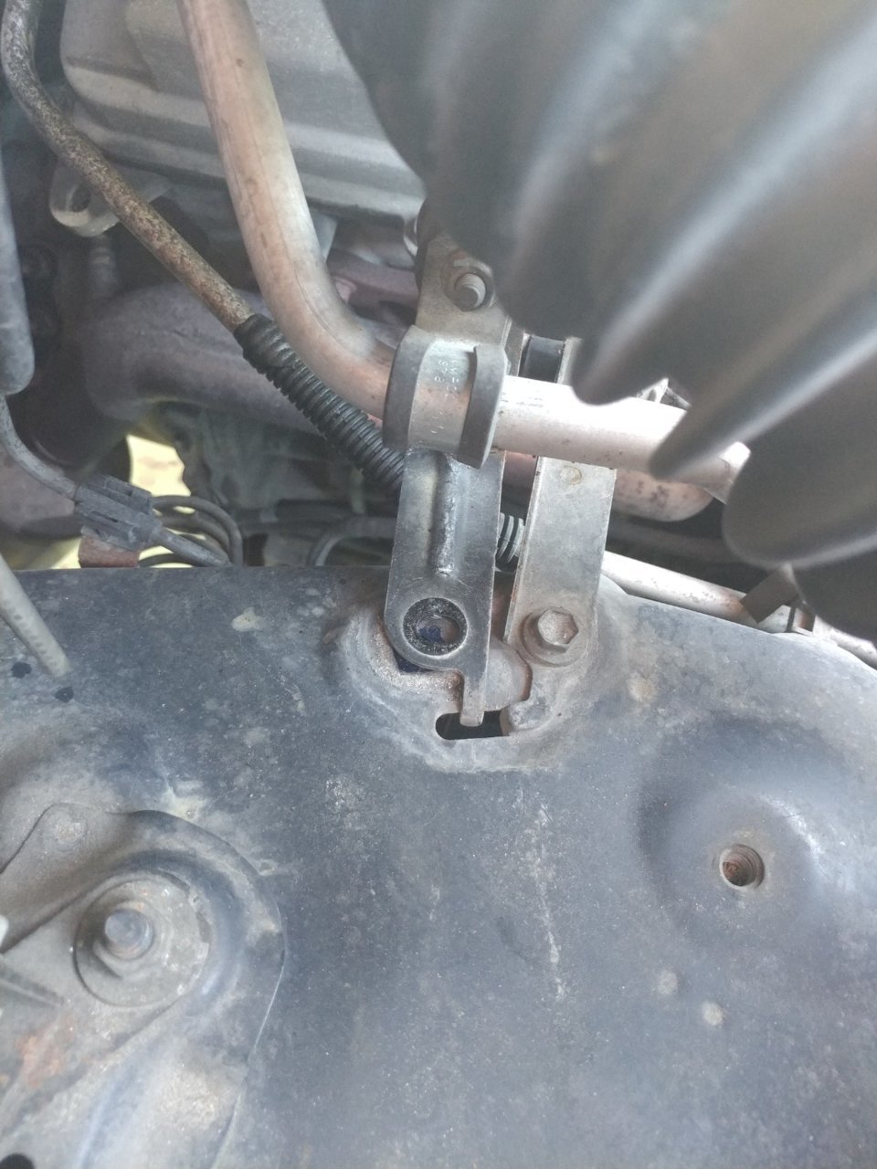

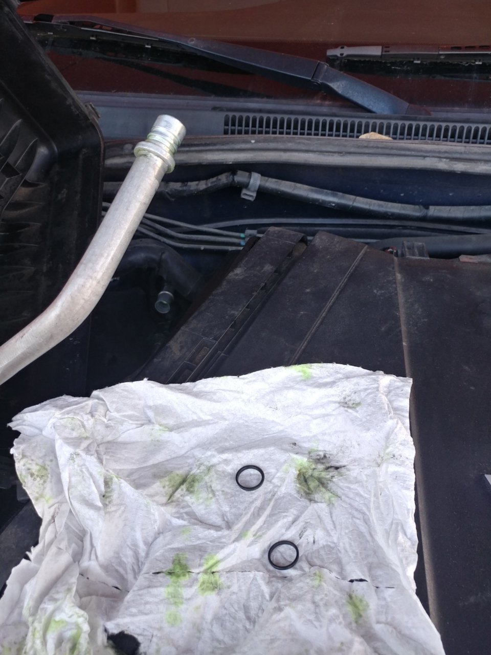

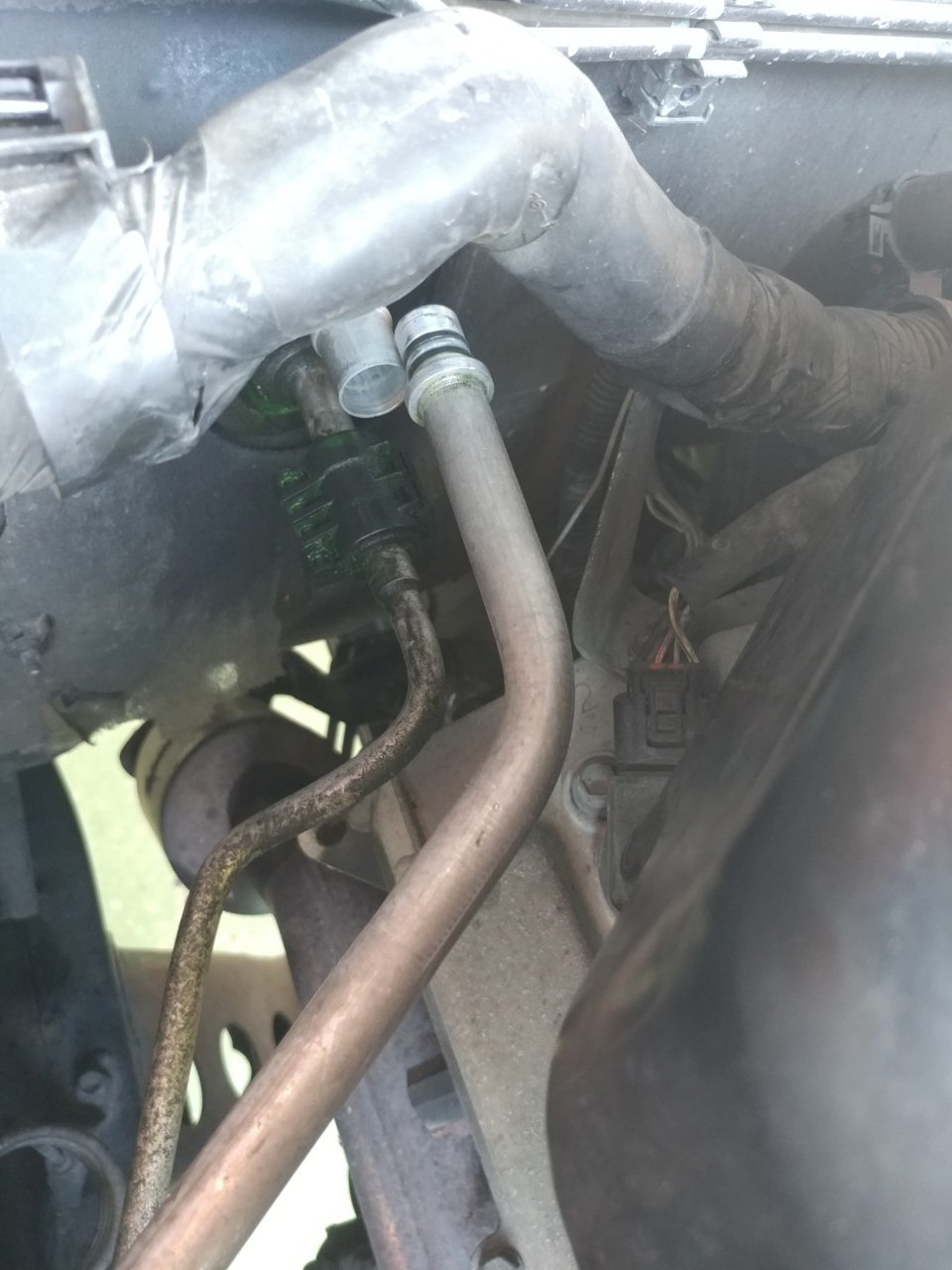

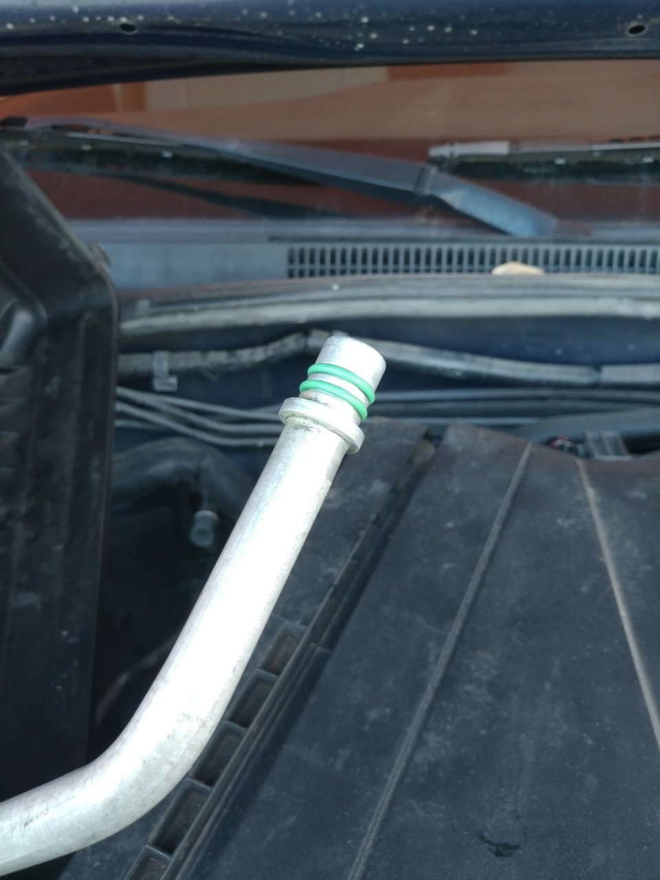

    Sorry for the late update guys. I went ahead and replaced the O-rings about a month ago, pulled a vacuum for a few hours, then recharged with 21 OZ of R134A. AC has been blowing damn cold and I don't see evidence of another leak. Infact my AC hasn't been this cold in years.
    Running off memory there were a few tips.
    1. To remove the clamps insert a small flathead screwdriver into the slots. This will pop the clamps open.
    2. You have to remove a 2 screws / clamps that hold down one of the lines in order to get the room to pop it out.
    3. You have to unclip the other line from a metal clip in order to get the room to pop it out.
    4. Install O rings - I added a little oil I wiped off the dipstick to the Orings before I slid them back in
    Pics below

    Oil off the dipstick for the o-rings???
  15. Apr 25, 2019 at 12:30 PM
    #35
    2007 4x4
    Sep 20, 2013
    #112869
    95
    meh
    It always says to lube up the o-rings when you change oil, I figured why not these. Plus the dipstick was right there and I just put Mobil1 about 400 miles ago so it was fresh
    AKA I was lazy

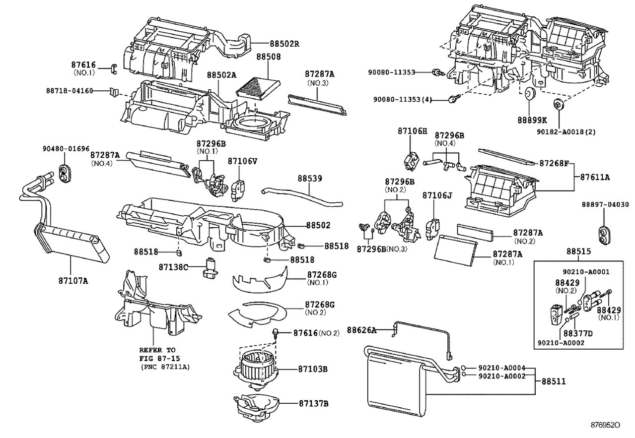

    Toyo schematic for 2006 (05-09) AC for o-ring part numbers if anyone needs them in the future.
    SR-71A, Failure2Comply and TireFire like this.

    Won't hurt a thing. I know you are 'supposed' to use refrigerant oil, but it's only a drop for o-ring lube. It's not going to contaminate the entire system.
