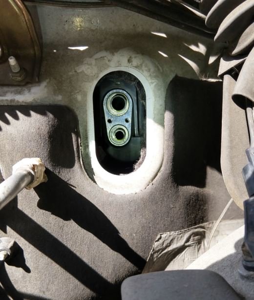

    Yeah, it was easy. I've included a better picture to show what the evap flange looks like with the expansion valve removed.
    My helpful-hints are to
    1) trim away the felt with a razor to get better visibility and reduce chance of something getting onto the mating surface
    2) stuff some paper towel inside of the firewall. If you fumble an O-ring it will prevent it from falling into the netherland and avoid an additional trip to the dealer...
    I had a very slight amount of metallic material in the filter I haven't re-charged yet since I found a potential leak area in the suction line from corrosion.

    I've had several people tell me it cannot be removed through the firewall, but they were incorrect. Thank you for taking better pictures of this so that all can see.
