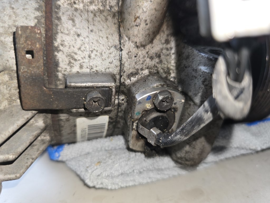

    Can I swap this?

    Wait I got confused, I thought you replced the clutch only with a aftermarket. I reread and you installed a whole compressor..
    Yes I'd try to get the old lock sensor installed into the new compressor. That may fix it
    Dm93 and Scott Rush[OP] like this.

    Hard to say without scoping the signal, 2nd gens have a digital hall effect sensor. I haven't really studied 3rd gens much.
    You can but not while the system is under pressure.

    Always, always, always keep the lock sensor from the old compressor. The one that comes with the aftermarket unit will never be as good as oem. They totally go cheap with that stuff on purpose. To keep the costs down
    I learned the hard way a few years back, Dm mentions it now and then
