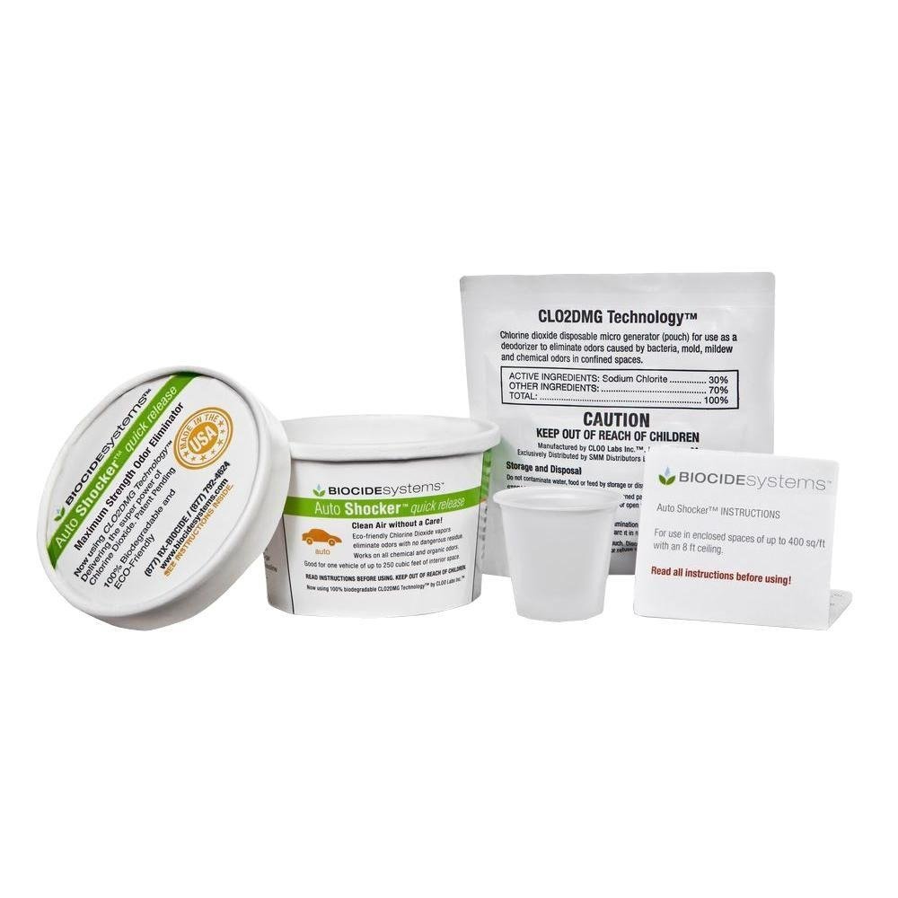

    biocide-systems-general-cleaners.jpg If you want to get real serious use this, it works, I've used it to clear out a house flip. We had home that was previously occupied by a chainsmoker. We used the Chlorine Dioxide on top of stripping everything. Carpet, paint, fixtures etc. Needless to say, the Chlorine Dioxide did the trick!
