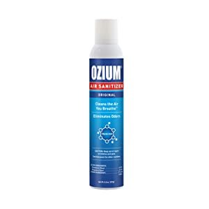

    Ozium is a hell of allot better than Lysol if you have never tried it.

    I have not seen a can of Lysol on the shelves at our local Walmart in 4 months at least. Was tickled I found a can of Ozium air sanitizer back in automotive dept.
