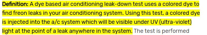

    Leak down test will let you know where the pig is leaking

    you add a dye to the system and run it. use a UV light to look for leaks.

    same thing... my brother is an HDR and he performs this test on equipment all the time... especially these days... Add dye, run the system, look for dye... my brother says its the best way to for sure find a leak... no false positives.

    lol call it what you want i dont care... thats what my brother calls it. Everyone is an expert on TW. figure it out lol
    *** Edit*** After looking it up, i see i forgot to mention "Dye Based"... guess my brother is a lazy piece of shit and doesnt want to say the full name... Like I said, everyone is an expert on TW... :facepalm:
