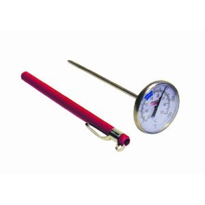

    Also, you can pick up a cheap thermometer with a metal probe end for checking air outlet temperature at your vents in the truck.

    Where is a good source for the metal one on top?

    That is just ONE thermometer. :) The piece on the bottom slides over the probe so that you don't get punctured when you stick it in your pocket or reach for it in the toolbox...

    I'd look at a local Air Condition / HVAC supply company or check with a Napa or other auto parts store.
