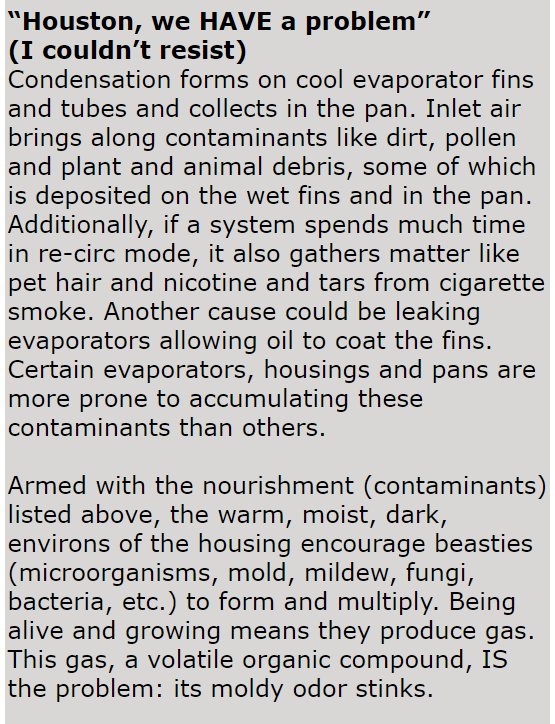

    truckclimbr00
    truckclimbr00 [OP] Member
    May 5, 2022
    #396525
    10
    Tacoma
    Odd. Maybe the sequence/programming of the actuators was reversed for you truck, Re-circulate button is actually fresh air intake.
  3. May 5, 2022 at 5:11 PM
    #23
    truckclimbr00
    May 5, 2022
    #396525
    10
    Tacoma
  4. May 5, 2022 at 5:11 PM
    #24
    Toyko Joe
    Toyko Joe Here for the pictures
    Sep 19, 2014
    #138654
    5,316
    Bring it in I bet the AC is not charged. Had this exact problem on my 2014 and there was zero refrigerant in the system, they balanced it and it smelled fine and worked great the rest of the time owning it.
  5. May 5, 2022 at 5:24 PM
    #25
    truckclimbr00
    May 5, 2022
    #396525
    10
    Tacoma
    If you remove the blower motor, you can sneak a bore scope camera up into the HVAC intake behind the dash and see if there is anything in there?
