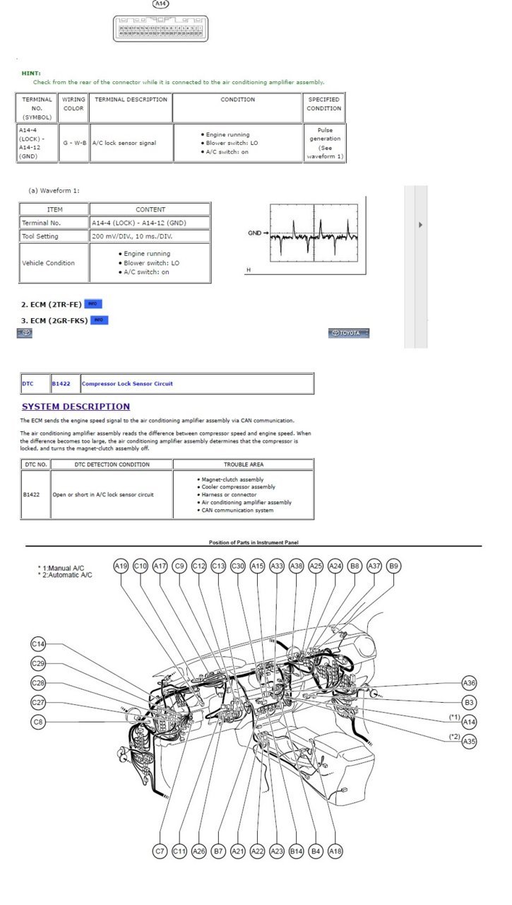

    That's where the A/C lock sensor is located...

    So it looks like the IH1 plug is very far away from where I was working, so im good there. Thanks for the diagram, there are like 50 plugs on the passenger side, nice to have a picture to show me where I should be looking.

    Were you working around A14?
    It's a CAN signal.

    Nope, just the mid range speakers in the dash. On the passenger side there is nothing even close to it, on the drivers side there is some stuff, but not much. Im thinking its just a coincidence that I was working on the truck and the AC stopped working. I think it might have more to do with not driving... ive done 238 miles in the last 50 days.
