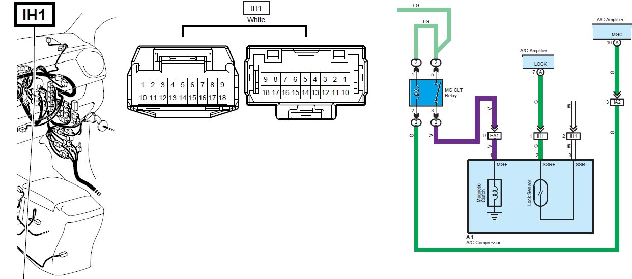

    Did you ever check the A/C Clutch Relay?
  9. May 6, 2020 at 6:41 PM
    #49
    05Taco4x4
    05Taco4x4 ToyotaHubs
    Jun 29, 2011
    #59085
    6,230
    2TR-FE Enthusiast
    FJ Tcase, Manual Hubs, 2017 Head unit, Mirror Riser
    MG CLT Relay in this diagram, under the hood.
