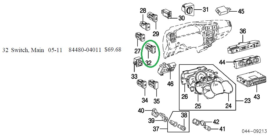

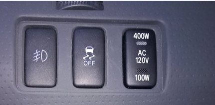

    Does anyone know the part number for the AC120V push switch? I am trying to replace the one on my 2018 Tacoma, which fits on the smaller slot, with this one so I can use the smaller slot for a different switch.

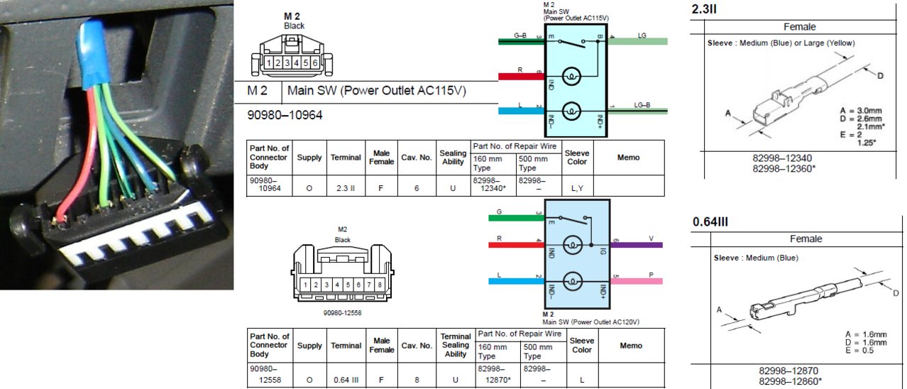

    connector and pins are different...

    Yeah you're right, I will have to figure something out. Do you think it would be too difficult to switch the housings somehow?

    The housing for the switch connection, not where it's placed....:rofl:

    You'd have to cut the terminals and crimp replacement sized ones. I haven't seen a male connector to mate with the truck side. Only in 2nd Gen.

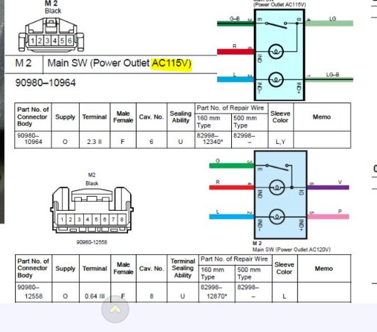

    Noticed your diagram was for the 115V, is there a difference to the 120V

    5 volts...

    Seriously, it's the switch...which completes the relay's function.
