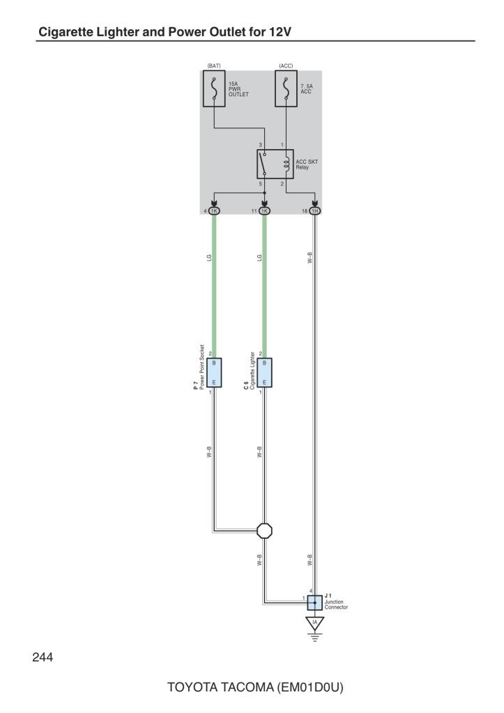

    I have a 2009 Tacoma TRD "Off Road" double cab. What do I need to do
    to keep the ACC outlets on when the key is shut off.

    It's pretty easy. All you need to do is remove and jumper the ACC SKT relay between pins 5 and 3.

    I can't finf the "ACC SKT" relay. I looked in the electrical box just behind the battery. There is nothing labeled ACC SKT. A internet post shows it in the bottom right quadrant oif the big fuse/relay box. There is a 100 amp fuse in the top left quadrant that looks like a relay. I pulled every relay one by one and checked to to see if the power went off, it didn't. There are more fuses behind the little drawer driver position knee height but no relays. there is a smaller relay box behind the main box with one relay for the DC to AC outlet.
    Wher is the ZCC SKT relay?

    just make a 2" jumper with male ends and fold it in half and install in 3 and 5.
    This way you don't ruin the relay and can reinstall if necessary at a later date.

    Get a 2" piece of 14 gauge wire. Add 2 male connectors. one on each end
    Fold it over double and insert into 2 of the slots where the relay goes...
    .3
    .5
    1 2
    3 and 5 are the two slots you need.

    Oh, I see what you mean now. Well, that would actually be a lot more difficult to do. See, I can barely pull the junction box out just enough to get a good enough grip on the relay to wiggle it out. There's no way I'd be able to get the box out far enough to be able to see what I am doing.
    I think in my particular case I am better off just trying to jam the relay more effectively. What I used the first time was a tiny piece of duct tape folded a few times over and stuffed under the contacts. I suppose maybe the tape sort of 'settled' and squished enough to allow the contacts to separate. I'll just have to use something more effective. I suppose if I wanted a permanent solution I could just solder the contacts together, but... probably not gonna do it that way.
    Oh, I have another question, though. Would it be reasonably unsafe (for me or the vehicle components) to try to do this without detaching the battery? Every time I detach the power, I have to redo all the stuff for turning off the truck's beeps/chimes/honks for the seatbelt and keyless remote, etc. I don't recall having to actually touch any bare wires or contacts, but since I'm not as familiar with this stuff, I'm not sure if that matters.
