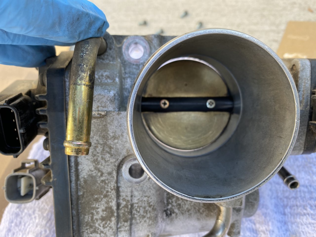

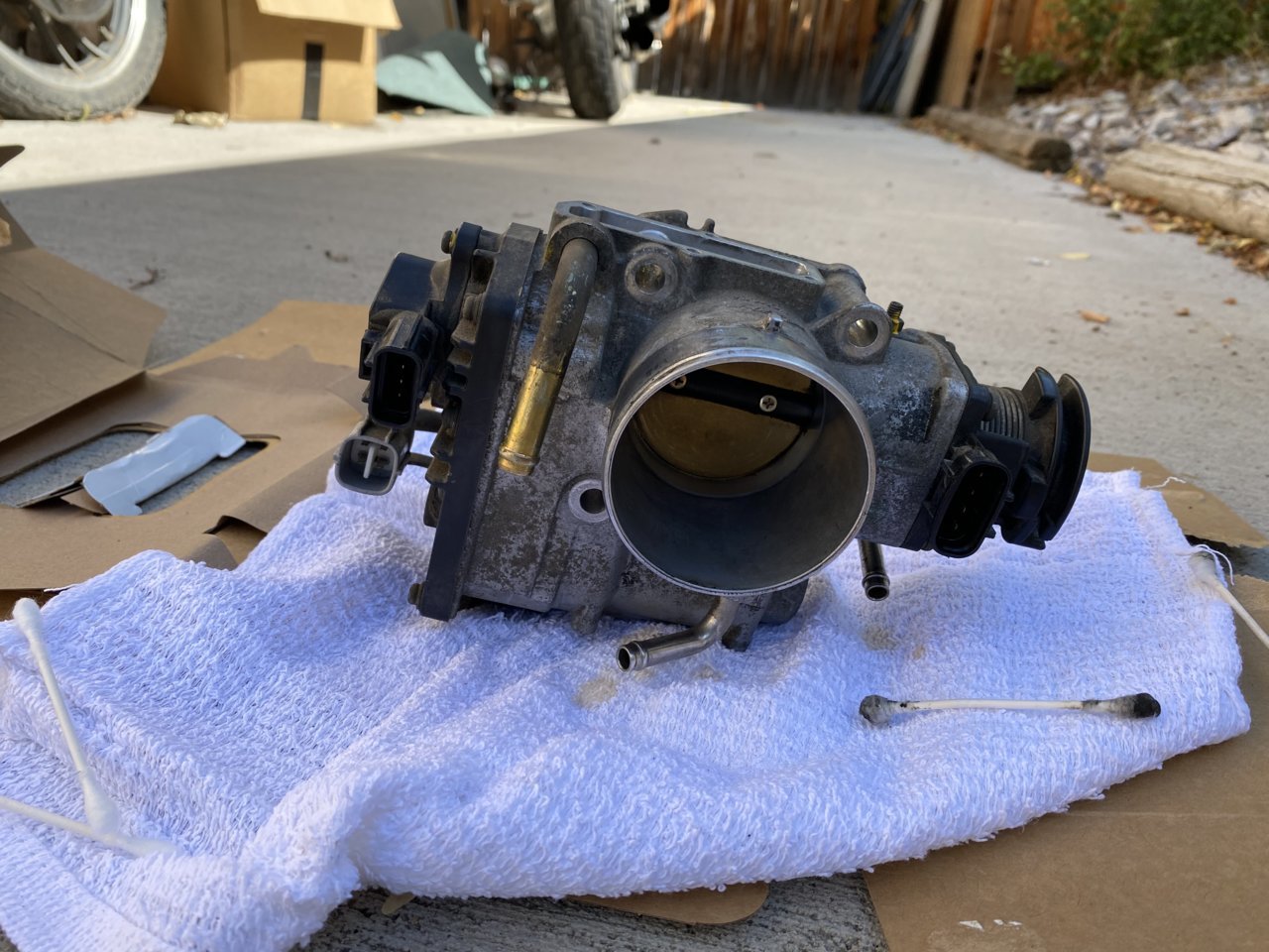

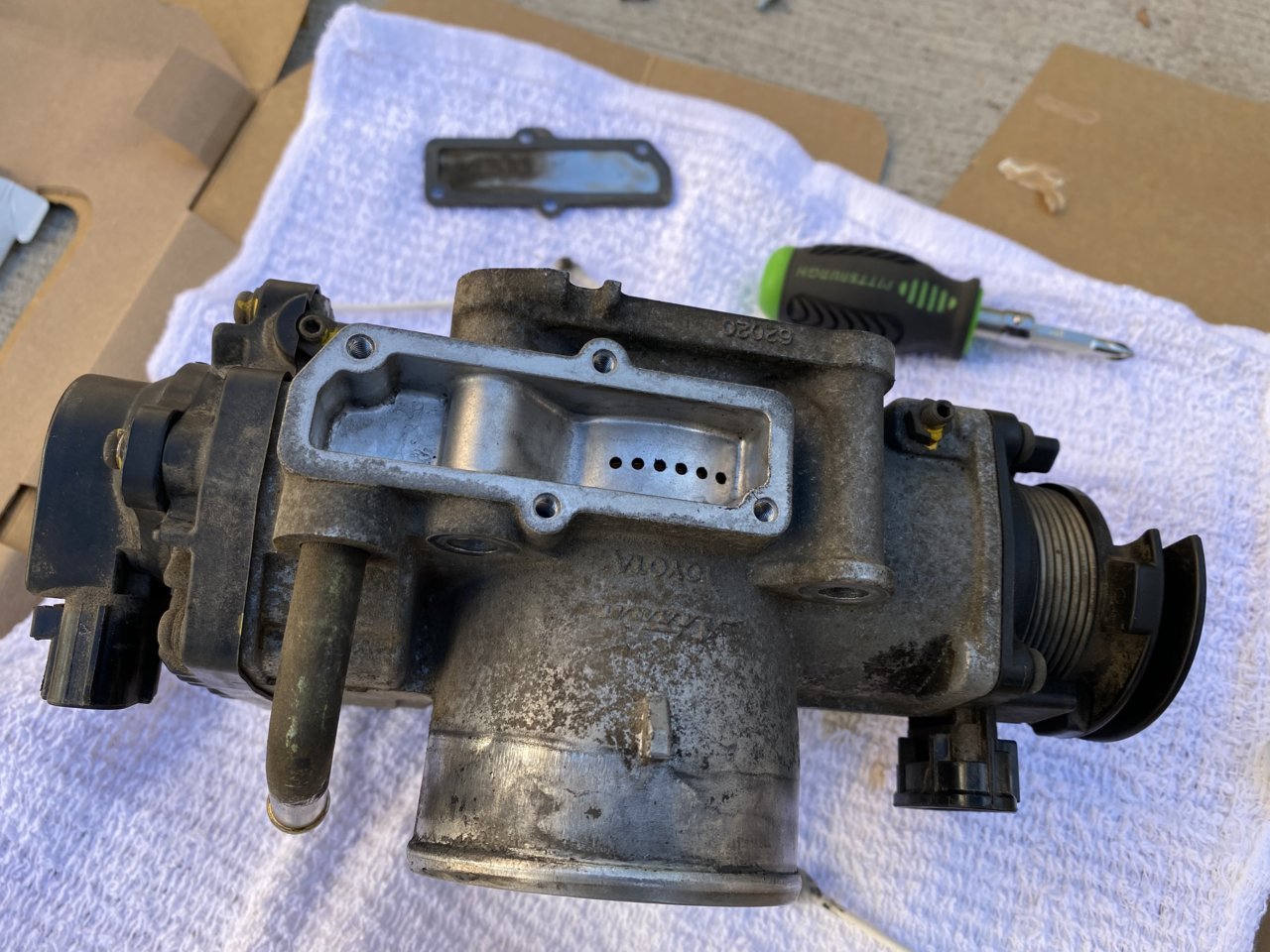

    Here’s couple TB pics after it was cleaned.

    @Pithy is correct. the 03-04 do not have a separate IAC like the 95-02. These are electronic TB.
    That gap would cause higher idle but it definitely should cause stuttering.
