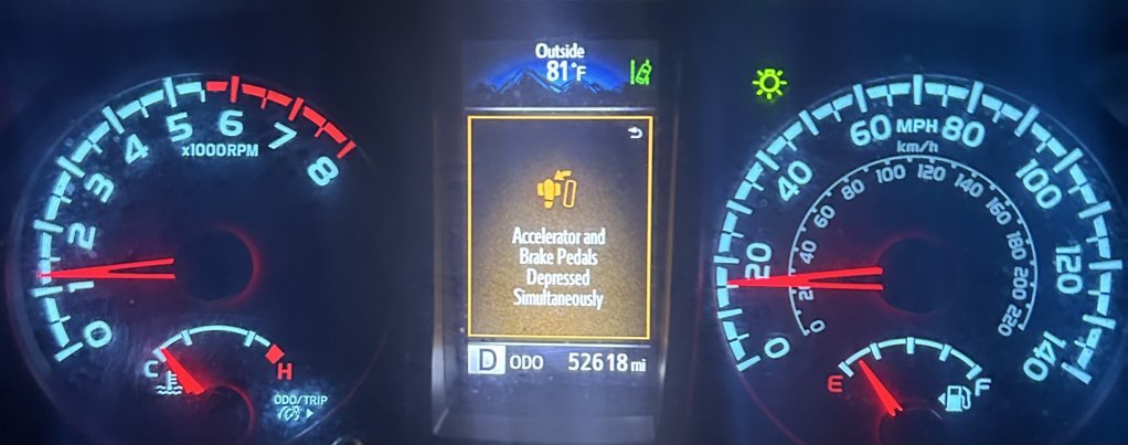

    Need help!

    where are you that it's 81 degrees in the morning?
    Seriously though here is what Google says:
    If you press both the accelerator and brake pedals simultaneously in a Toyota Tacoma, the Smart Stop system will intervene to slow the car and reduce acceleration, potentially triggering a "limp mode" and reducing speed.
    Maybe it's the ESS system or battery? Do you have one of the traction control methods selected? I'm curious to what you find.

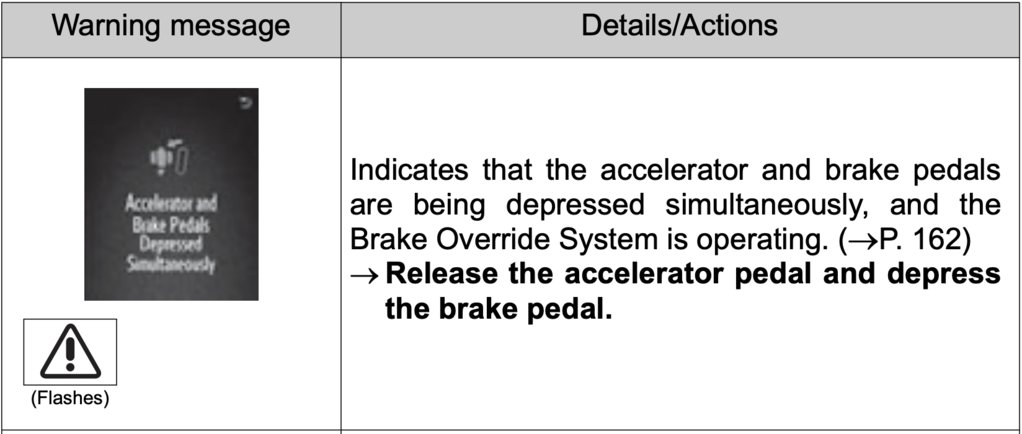

    I'm guessing this was an accidental press. Looks like you can clear the warning without issue though.

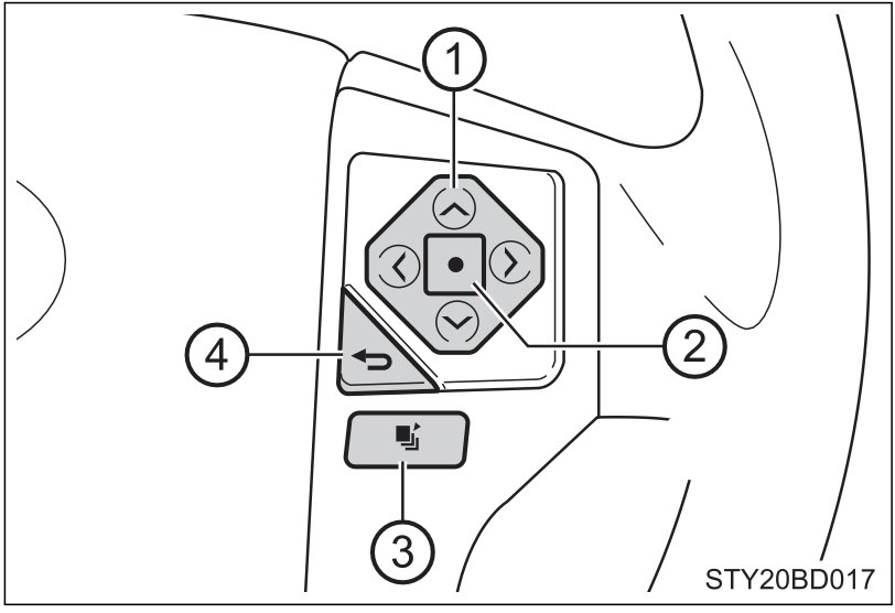

    Push #4 on the steering wheel...and the obligatory RTFM
