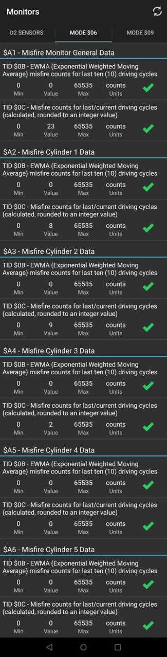

    Is this count on the tuned or the stock?

    If you see high knock (like 50 , 100+) occurring at high RPM then thats not healthy. Low RPM knock is usually noise and typically harmless unless load is part of the equation. There is no way to get rid of all knock if the sensitivity is set to high no matter the octane typically. Cliff notes - low knock count and low rpm is nothing to be concerned about here.

    #23
    RustyTacoVT
    RustyTacoVT [OP] Well-Known Member
    May 13, 2019
    #293177
    109
    Stock

    Fuel pump recall? Too high for the stock.

    Why do you say that? We have a few other people in this thread saying it's normal, and a couple of others have seen the same on their stock trucks. I've also seen the numbers remain about the same between tuned and stock on my truck.

    B04 calibration on my truck was within 0 to 10 range. I have been monitoring this stuff before I used the tune. And once you start paying attention, you will be able to tell if the engine had a misfire.
    Techstream is a good tool to start logging the data. Pay attention to startup, slow driving on the cold engine and under the load.
    You mentioned rough running. I would look into crank position sensor, fuel pump recall, running a compression check, check all connector under the hood.
    Have you tried the last 2.0 release?actually it fixed all mf issues and even improved the stock #s for me.

    The tech stream was counting misfires, but just like you, I could never actually feel them. This is what I meant to say

    +1, apparently it's a thing on these trucks lately. And I like this guy's low-key wisdom delivery after a thread full of noise :hattip:
    Not to ruin anyone's panic, but there are situations where the ecm will show misfires and they never really occurred. The same with knock counters.
    Direct injection engines skip way more than people realize, especially on cold starts. That's one main reason our trucks have both. (And emissions, and performance via DI accuracy and you can't very well do port injection if you shove air back up the intake as part of the atkinson cycle.)
    Now, for OP, you say your truck "runs rough", well is it dead-skip rough? Don't know? Unplug a coil, you'll know and have a comparison. Alright, now that you have that sorted out, if the answer is "no, not like that" then pay less (less but not zero) attention to the counter. It looked to be more with one cylinder. The usual coil and plug swapping is in order. If you've done all that, nothing found and its still running rough, maybe the vvt is off a bit for any number of reasons. The demon I just found in my wife's crosstrek regarding its rough, hot, in-gear idle was oil contamination in the exhaust cam phaser connector causing it to short the signal a bit and the cam wouldn't move quite as much to match the tune for the immediate conditions. $50 part, redesigned so they won't weep oil, two 12mm bolts to change. Ain't that some shit? It drove us nuts for 15,000mi.
    My silverado did the same thing with the misfire counters, I got concerned when I first saw it too. Then I noticed it would happen on decels, when the injectors weren't firing. Ah ha, that makes sense. So if you're going to keep watching the monitors, watch when it happens or start plotting a few things like load, timing advance, throttle position and MAF g/sec or MAP pressure along with torque converter lockout condition and you'll start to see patterns.
    My taco has a less-than-perfect idle at times, the injector cleaning cycle has a little to do with that i think but I'll very happily deal with it to never have to deal with the typical DI demons.

    Not all misfires are detectable by the ol ass-o-meter. Different “class” of misfire. i agree with the above posts regarding further exploration
