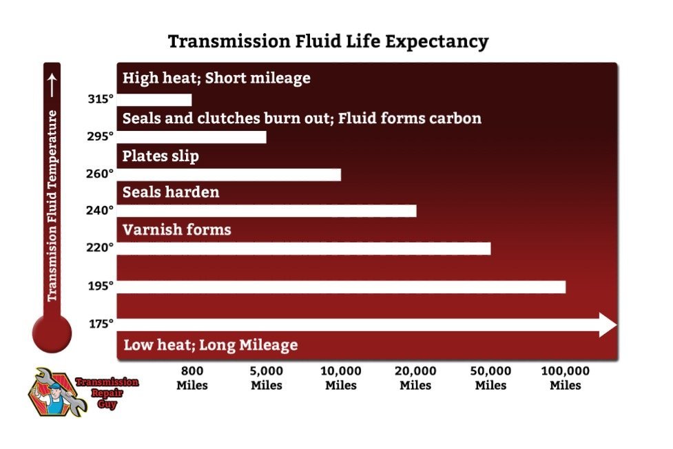

    195* degrees the tranny thermostat should open and start circulating. I try to keep it 220* or lower. Fluid starts to really degrade at higher temps according to charts I have found.

    That chart is IF you run the temps for 1 hour straight! Hitting higher temps for a few minutes is no big deal. I have seen 245 at the TQ and 230 at the pan for a few minutes towing an 5,000 lb trailer over passes. And yet according to TW the universe should have imploded. Yet we are still here.

    I was not trying to imply that if you hit temp x the fluid is toast. The chart shows higher temps degrade the fluid faster. By monitoring temps you have a better sense of how hard you have run that fluid.

    I understood that for sure. Have see that chart so many times without context.
