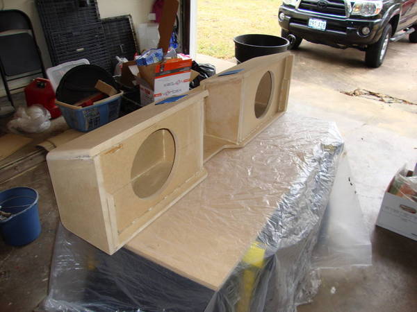

    I haven't seen anyone make a box like this before, so I figured I would post some pics.
    I started with:
    -4x8 sheet of 3/4" MDF
    -bottle of gorilla glue
    -2 cans of black krylon fusion and some clear (very bad choice!)
    -speaker terminals (another bad choice, but live and learn, right)
    -screws for blocking and mounting the subs
    Final Product:
    Updated final install:

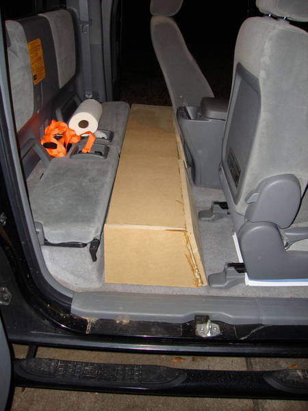

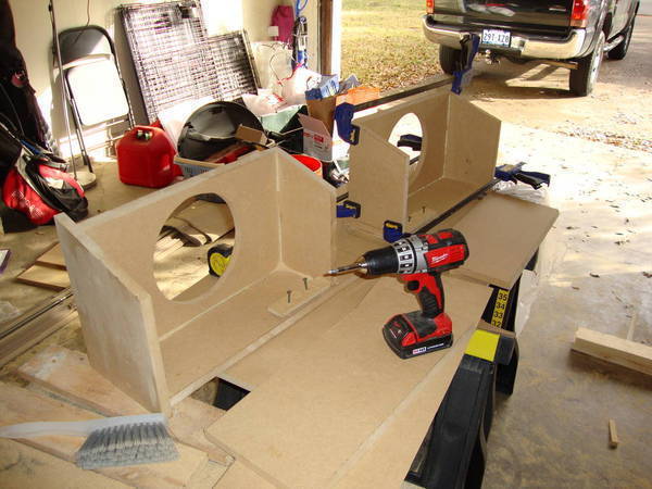

    I started out by making a cardboard template to get all the dimensions right. I'm 6'-3" so i didn't want to loose any space at the steering wheel, and I wanted the top of the box level with the jump seat and still be able to get to the storage under the seats.
    The right dimensions for me are (these arn't exact, I'm just remembering off the top of my head. For exact dimensions you will have to go measure yourself:notsure:):
    jump seat length-51"
    seat height-8 1/2"
    box depth @ floor-12 1/2"
    box depth @ top-8 1/2"
    box angle 17.5 degrees

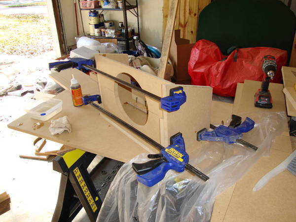

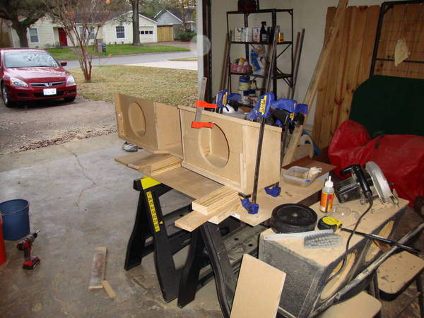

    After I made my templates I cut out all of pieces from my sheet of MDF, and started gluing it all up. Quick tip, a 4x8 sheet is actually 49" in width so you can rip all of you long pieces first and then put the side panels on to get really close to 51".
    I screwed in some blocking pieces to clamp against, I took those out once the glue set. I use gorilla glue because it expands as it sets, so there's no need put sealant on the inside of the box afterwards unless you're an extreme audiophile or just a little anal. Plus this stuff gives snapple a run for their money as being the best stuff on earth.:headbang:

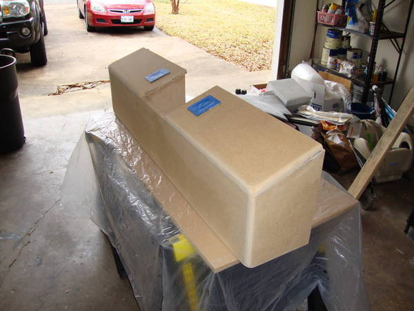

    All glued up and ready for a test fit.

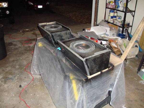

    Now that the hard work is out of the way, all you have to do is sand and finish it, wire the subs in, and install all of it in the truck. Easy, right.:laugh:
    I did the majority of sanding w/ 60 grit and finished off with 100 grit.
    Sanding done, ready for paint. Rattle can was a STUPID IDEA:facepalm:. I've seen others do it and it never comes out looking good, but why should I learn from that? I'd rather be a momentary moron, MDF+rattle can=:crapstorm:.
    After painted,

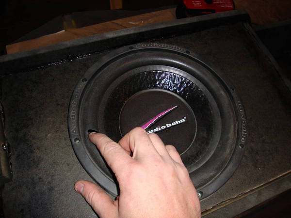

    I put the speakers in, but I was really tired at this point and my drill slipped when i was screwing in one of the speakers
    It was a blessing in disguise b/c the terminal for that side of the box from rapioshit didn't enguage the speaker wire. All of the components are old, so a busted speaker isn't that big a deal. It's just more annoying than anything else.
    The system sounds really good with only one 10, but I can't wait until my Audiobahn ALUM10n's and Hifonics HiFi1500 show up so I can fix all of my screw ups:yay:.

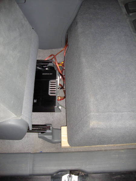

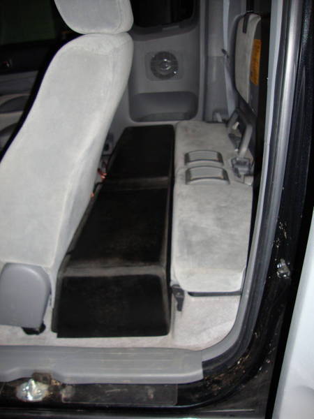

    Got some pics of the final install, it sounds great once i did some fine tuning to the amp.
    Final install in the truck
    The sub face plate was too tall for the recess in the box so my quick fix was to throw some 2x4's under each end, i'll fix it permanently later
    It was a tight fit
    Had to take some carpet out to get the amp to fit under the seat

    The end result looks very good.
    How do you like the sound of the 10s firing downwards?
    Also, nice job on the carpeting - color match and workmanship. Is it pretty straightfwd to do?

    This is my third system, but the first one that i've done with downfiring subs. It sounds the best by far. There are a lot less parts to rattle when the sound waves are traveling up and down vs front to back.
    The carpeting was surprisingly easy if you keep the seams on the ends. It's just run of the mill automotive fabric from Wally World.

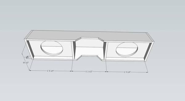

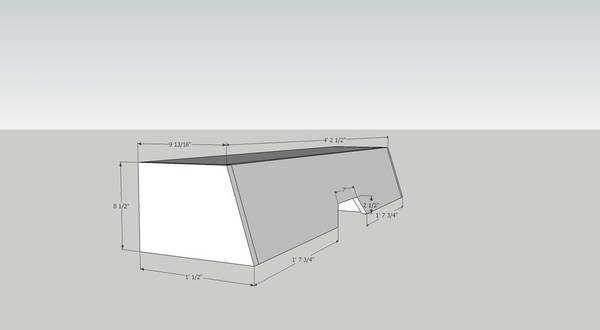

    Got some more requests for dimensions so here ya go, hope this helps:
    Click on the pictures to enlarge them and actually be able to see the dimensions.
