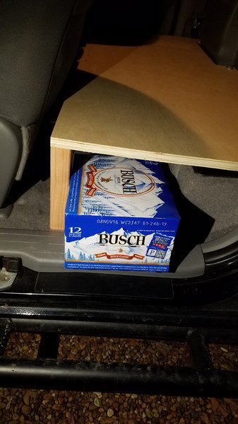

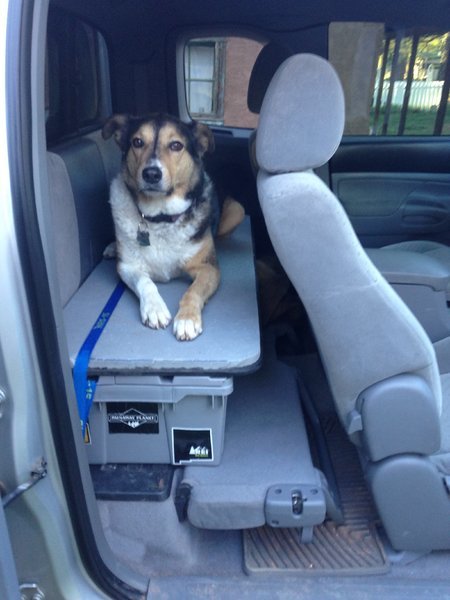

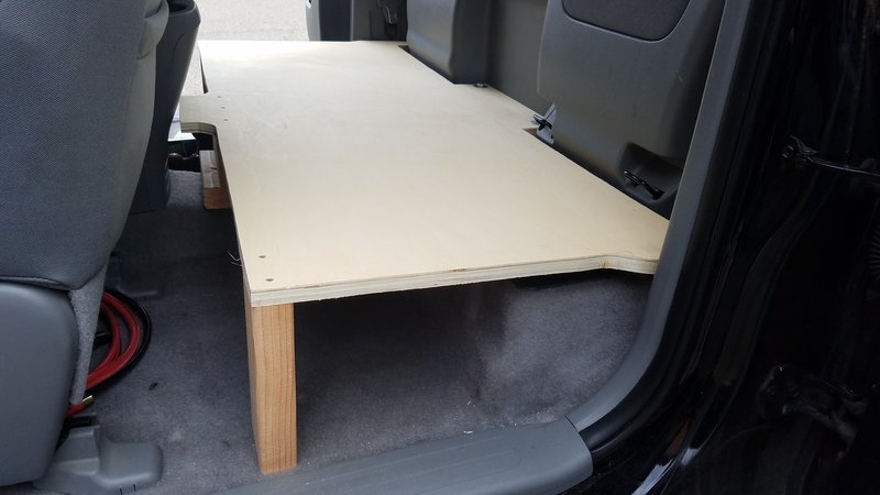

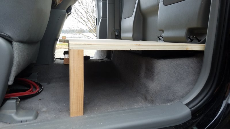

    I finally got around to building my own dog platform. Used some ideas from you guys but ended up making a custom template to make sure it fit just how I wanted it to.
    I actually used the bolt holes from the seats to secure my platform with longer M8-1.25 bolts which is not something I had seen done on here yet but I doubt I'm the first person with that idea.
    I still plan on adding some hinged doors to access the storage compartments and carpet over the entire platform.
    I am tall so I still needed the seat to slide all the way back but had to make sure at least a 12pk would still fit...
    He immediately jumped back in the front seat but hes warming up to it.

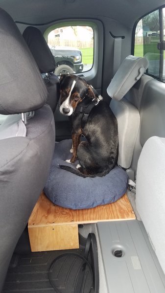

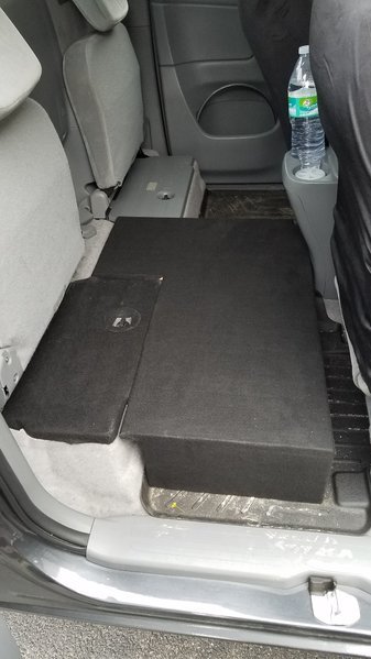

    So i've had my tacoma for around a month now and I was looking for better ideas for my dog in the back and stumbled across this thread. I took some of the ideas here and made my own version.
    The requirements were:
    • Platform had to be removable easily
    • Still wanted access to the storage compartments
    • Dog has plenty of room without moving passenger seat forward
    • Able to still use one of the back seats if needed.

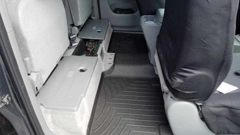

    Here is how much room he had before I made the platform (he wasnt happy with it and I had to move the passenger seat all the way forward):
    The build:
    I took out the stupid center console in the back because it really didnt hold anything I wanted in it and took up a lot of room. Only 2 bolts held it in place.
    I then decided that I could use that extra space for the dog platform and still use the other seat if needed. Also in order to use the storage compartments that are not removable, I had to make the platform the same level as them. So a bunch of measuring and checking the fit as I built each piece I came up with this. There are only 2 supports and it is solid.
    He has plenty of room now and can see out the window and I still have access to the storage compartment. The only thing left to do was cover it with felt so he doesnt slide all over. I also might remove that seat to give him a little more room. Not sure how easy that is though.
    Here is the finished product covered in felt. Leaving the storage compartment uncovered looked funny so I covered that too. Dont mind the patch I made over the latch, my first cut wasnt pretty. It was a learning experience covering it with felt material :)
    The platform lifts right out no problem and fits into the truck perfectly.
    Today I will get to test it out when I take him to go mountain biking!
