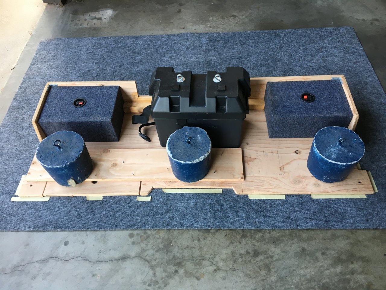

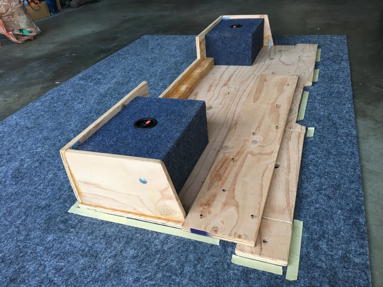

    Grey will go well with silver. Good luck. I’m half way through the carpet installation. I did the top and the front tonight. I think I used too much of the spray because it’s almost gone. I wanted to make sure it was going to hold but I hardly have any left. I bought a staple gun today at Harbor Freight. That helped a lot!!! Pull the carpet tight and staple underneath to frame members.
    I layed out the carpet in the garage with the good side down and then positioned the platform on top of it. I market the perimeter of the platform with masking tape and then rolled it back so I could apply the spray adhesive to both wood and underside of carpet. After waiting about three minutes for it to get tacky I rolled the platform back and lined it up with the tape lines.
    I stood on the underside of the platform and then put weights on it to apply pressure while the adhesive set up. Then I sprayed the front side, the one that goes against the back of the seats, and stretched the carpet over and stapled it down to the underside of the speaker boxes and platform frame. Going to finish it tomorrow.
    I have to trim out the speaker openings and cut in the access panel for the jack. Then I can install the hinges and put the speakers in.
    Hopefully I can make a pleasing looking cut to fold in the side panels. Hope I have enough adhesive left for the side panels. This has been a huge project but I’m happy that I could complete it.

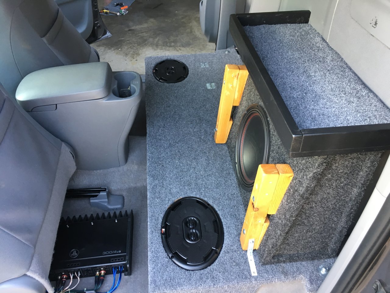

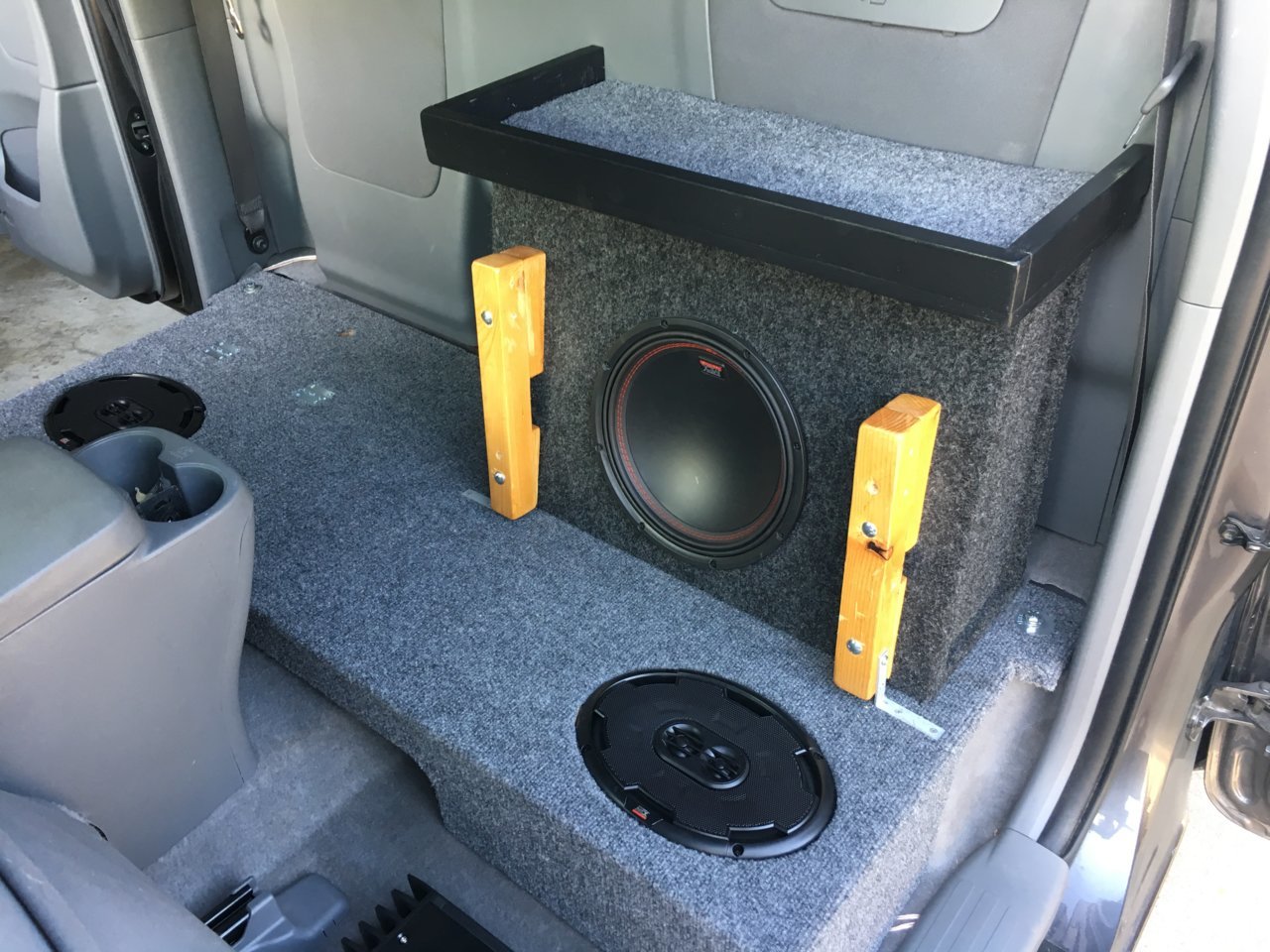

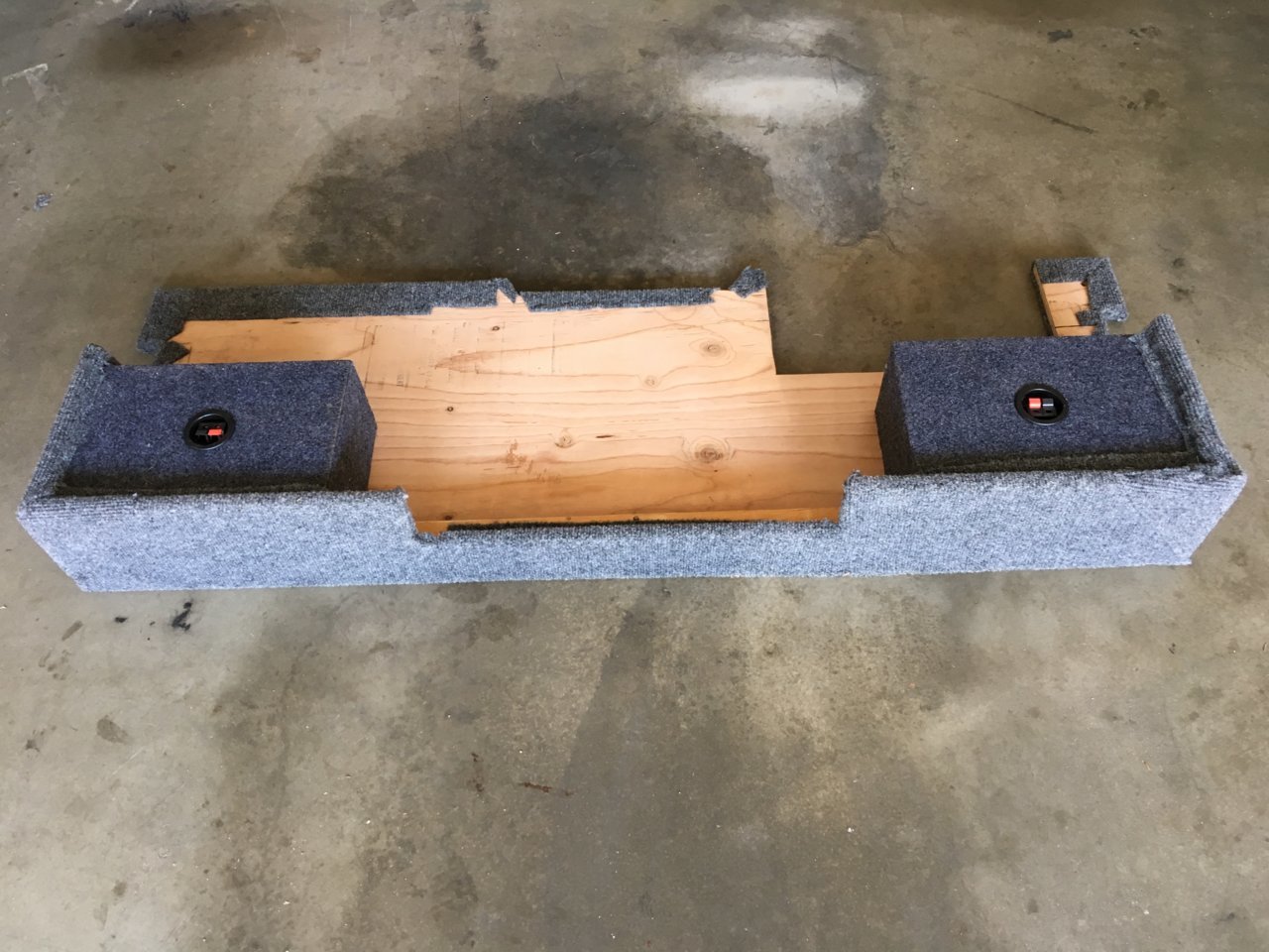

    My platform project is complete! It was a lot of work (Three full days) but now that it’s done I’m pleased with the results. The doxies are going to be surprised the next time they ride in the truck. They will have a lot more room now.
    Heres some pics showing the carpet installation. I also built a small shelf to go over the subwoofer which is held up by 2.5" corner brackets that are mounted to the top of the back of the sub box and the bottom of the shelf. I also lined the shelf with some of the excess carpet. (The sub box was originally positioned to fire downward. That's why I had bolted the angled 2x2 blocks to the front. It didn't sound as good that way so I turned it upright. The blocks now serve to protect the speaker.)
    I utilized one of the stock jump seat mounts to bolt down the subwoofer with a back strap made out of a corner bracket with one of the holes enlarged so the seat bolt could go through.
    (I nailed a scrap piece of plywood over the back of the access hatch for the jack that made the carpet easier to lay. Once the 3M Super 90 dried I used my utility knife and cut out the hatch, and also installed the hinges.)
    The opening for the transmission tunnel was purposely made extra wide so I could reach inside on either side to get to those areas. Seemed like a good place to hide valuables, or small stuff.
    I did everything myself, but I have to say my carpet skills need improvement! Fortunately there is no glaring mistakes. The rear speakers really do add a lot to the sound. I had to fine tune the JL Audio 4 channel amp to get the level correct. Rear fills should not call attention to themselves over and above the front sound stage, but add to filling out the sound to make a nice blend. It does that well.IMG_0647.jpgIMG_0648.jpgIMG_0651.jpgIMG_0656.jpgIMG_0666.jpgIMG_0667.jpg

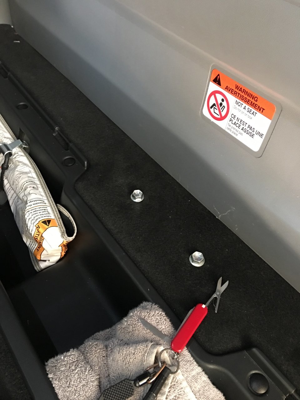

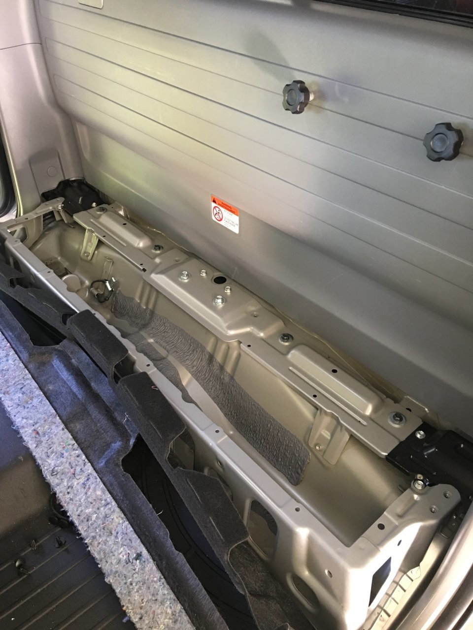

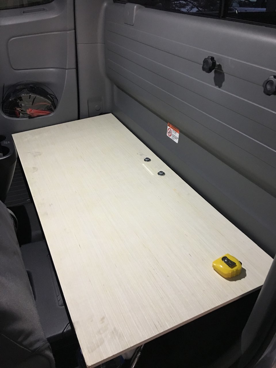

    So I ended up getting my two holes drilled and installed slightly longer bolts to secure it.
    Couple things:
    When snuggled down the platform slants downward, I’m not sure how I’ll adress this once I cut my legs out.
    Because if the back seat delete I’m dealing with a slightly different arrangement.
    I could remove the entire metal piece you see that has all the bolts in it and start there.
    Which I just may do this weekend.
    Anyways, pics are for comments or ideas.

    Can I ask why the extra board running the width of the cab back there?
    You may have given me an idea...

    Hey brother we have the same trucks, sort of!
    Can I ask to see more pics of that rear 2x4, your is a very simple and good looking design.
    Does it just sit back there with gravity’s help?

    It’s actually an awesome product called FX(?) I get it from my local plywood supplier, Fessenden Hall. It’s a plywood core with a 1/16” mdf veneer on both sides, I use it for painted cabinets cause it’s smooth and consistent like mdf but holds screws like plywood. I wanted to use 1/2” but I had this extra sheet of 3/4” laying around.

    Ha, flattered! And stoked cause I’ve gotten so much inspiration from this site. Feels good to give back. I have also gone to depot with a picture in hand looking for advice on many occasions.
    I think I went as close to the back of the center console as I could, it’s so low that I can still get the seats pretty far back, not sure if it’s the full extension or not, but plenty for my 6’2” frame. I think I have 24” at its widest in the center, 21/22” at the sides. Roma(pup) is so happy about it, she lays down right away, used to be she’d stand the whole time or get up at every bump, I feel bad I didn’t upgrade sooner. The cushion helps a lot.
    Would love to shove some speakers in there or a small woofer, getting my truck to bounce is on my list. Upgraded the door speakers but haven’t jumped on a headunit yet due to city life. One day...

    Can you just shim underneath the platform with plywood strips to remove the slant? I know I had to shim in a few spots due to an uneven surface.

    Looks like you used the seat belt bolt locations. I bolted mine down to the holes that were from the jump seats. You’ll notice there are two holes in each of the far corners. I used one of these in each side, because I wanted to leave the seat belts to connect the dog harnesses. Are you going to use 2x4 legs or build side and front panels out of plywood ?
