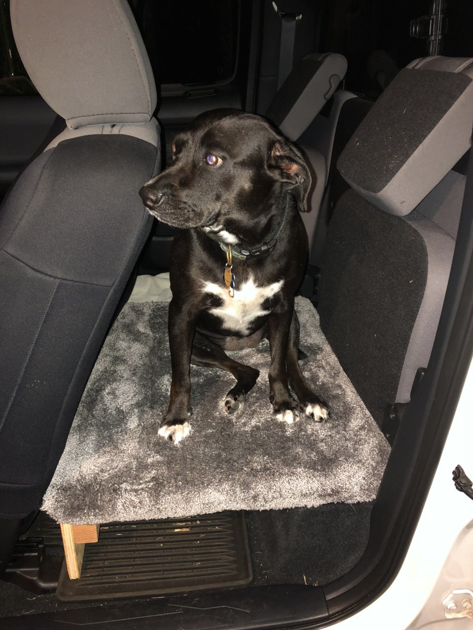

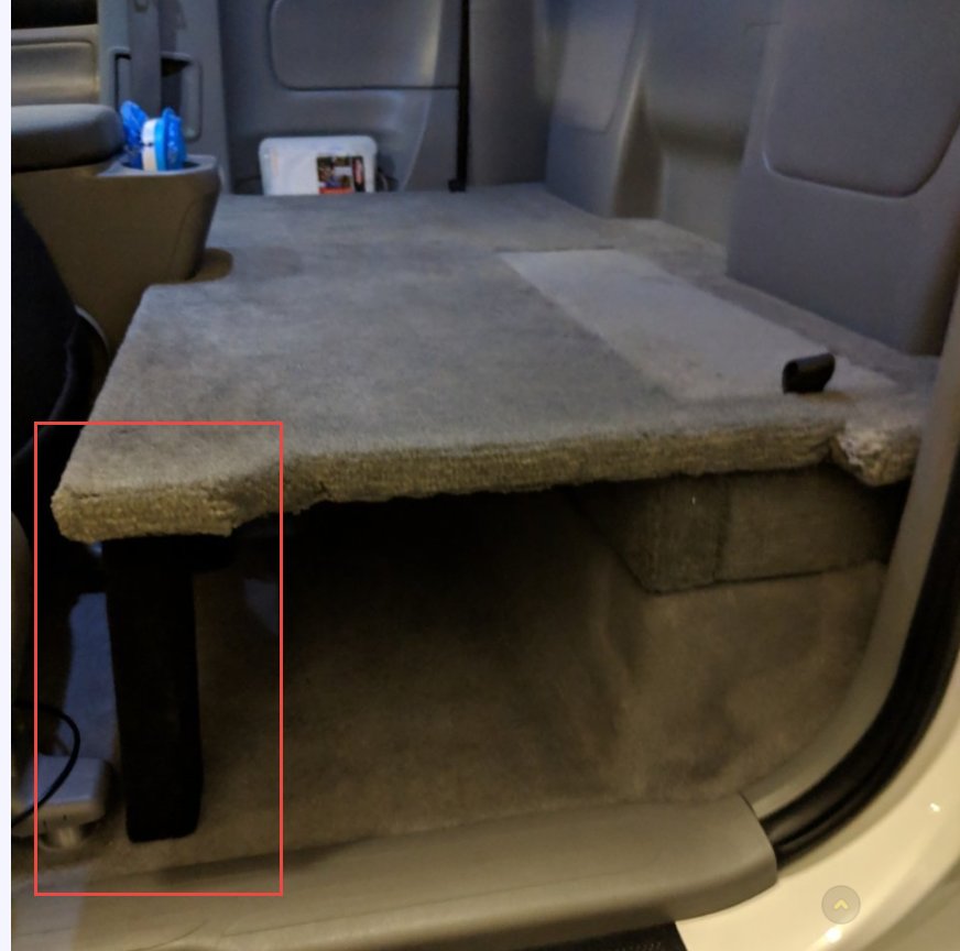

    I decided to give it a go. I made a central console for support and storage, and to allow both sides to allow a passenger by removing a panel. I made the legs removable for easy storage, and padded the top. I have a hammock on order to contain the dog hair, so we’ll see how that works.

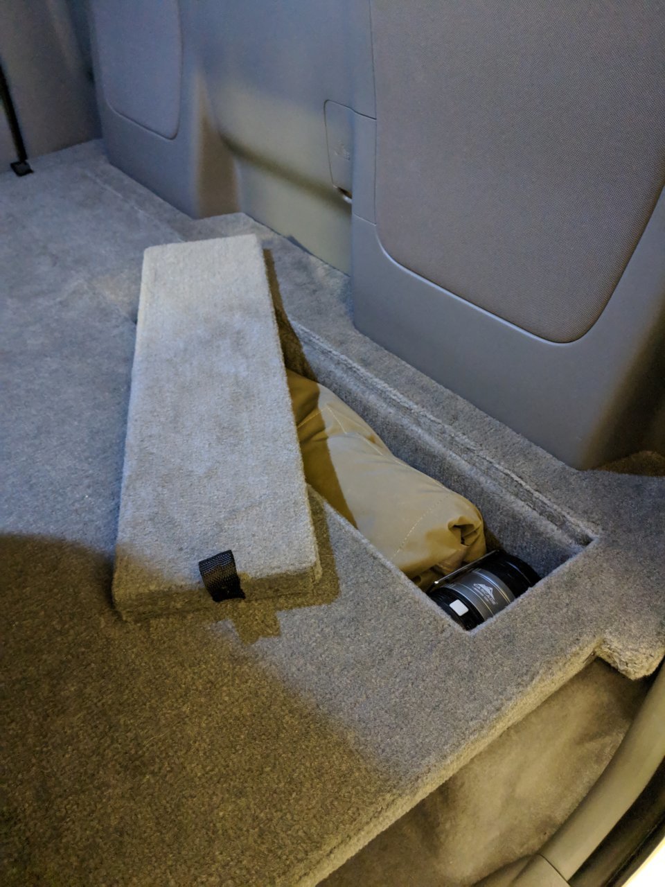

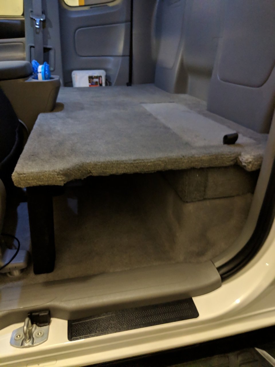

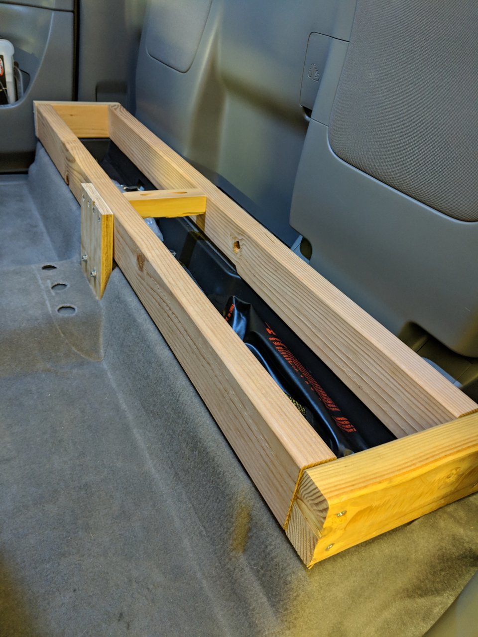

    I recently updated my dog platform from the original design to something more permanent. Initially I wanted something easy to remove in case I had passengers OR needed to get into the cubbies for tire changing tools. Since I have had zero passengers back there in the 8ish years I have owned the truck, that reason no longer applied.
    Here is the old platform:
    I found some great inspiration from this thread. I decided to build a platform with access to the storage bins. To do that, I would have to extend the height on the bins to platform level. Heres the first mock up I came up with. I wish I was better at woodworking and had a proper workshop.
    That tab in the center bolts to the truck using the rear center console bracket bolts.

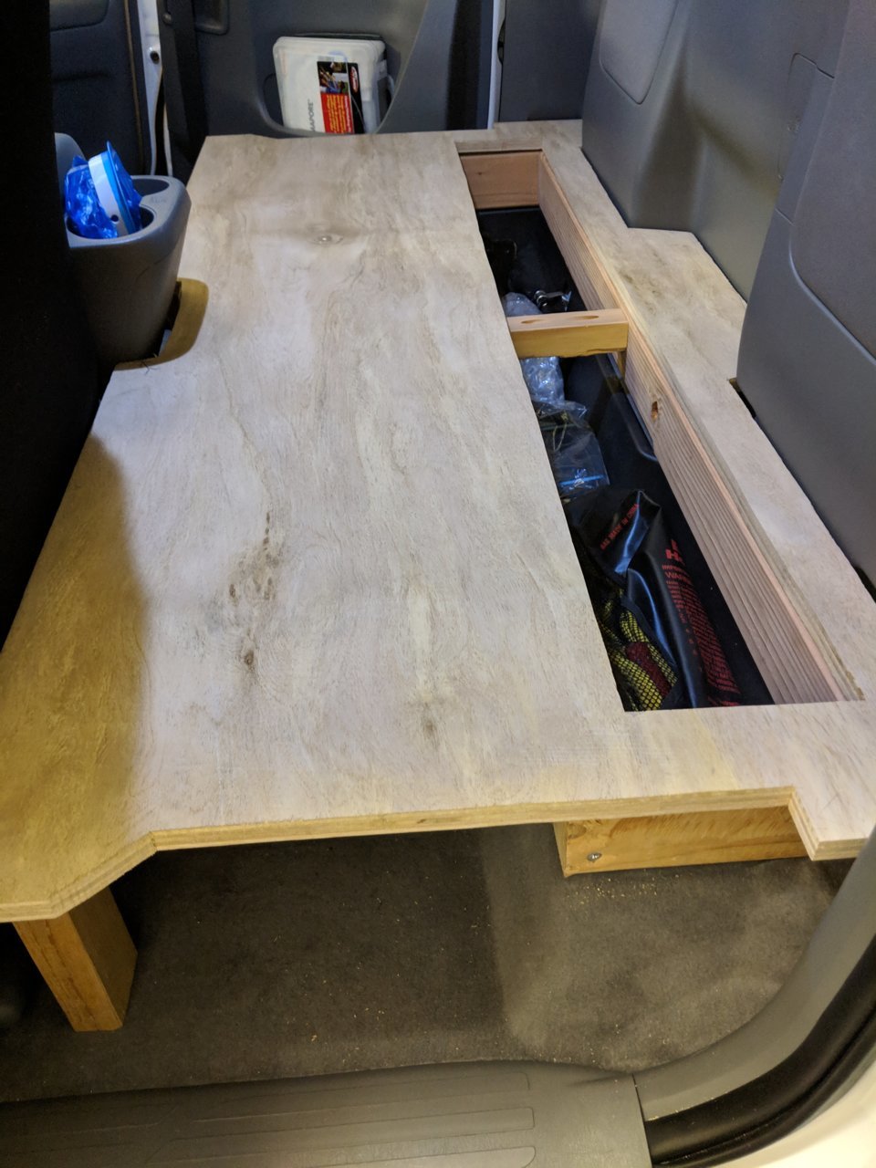

    I went with 3/4" plywood this time and whatever scraps I had lying around my garage. I cut out the plywood using cardboard templates and lots of trips back to the truck to check fitment. Here is the final piece before carpeting.
    I went to my local upholstry warhouse and found some carpet. I am not thrilled with how it frays when cut but it will work for now. I am happy with the end result and I know my pup is excited to try it out on our next trip!

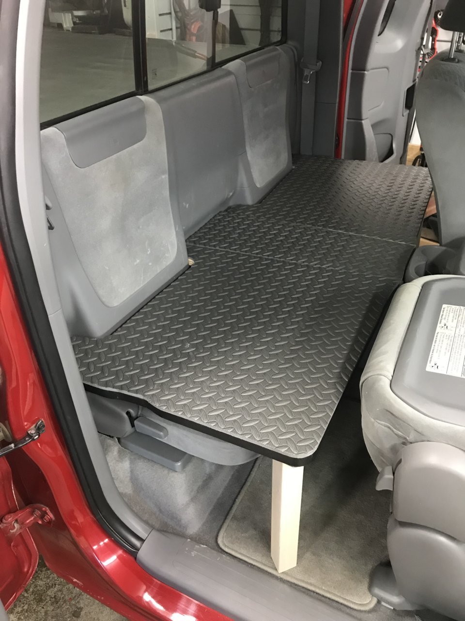

    @WSMFP Mine is similar to that one, so these dimensions might be close...
    More pics of it in my media gallery.
