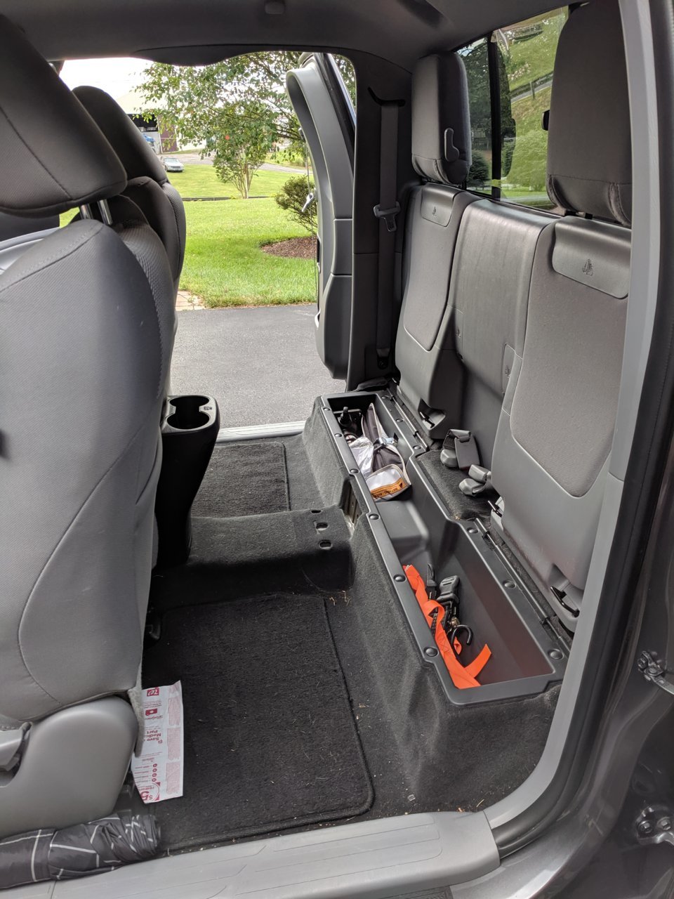

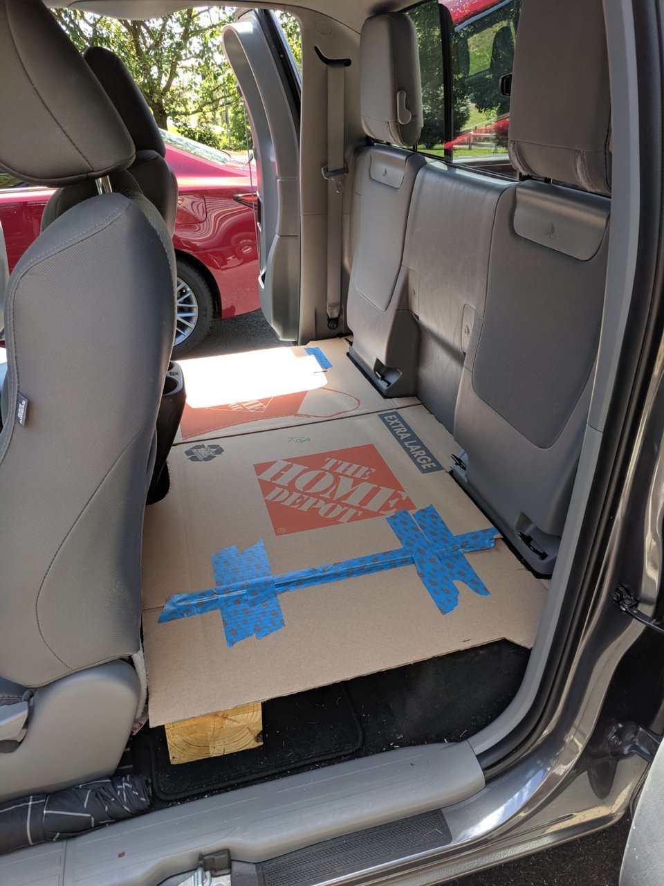

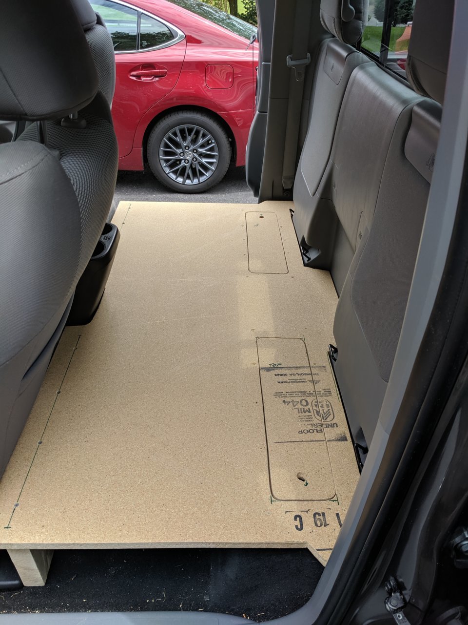

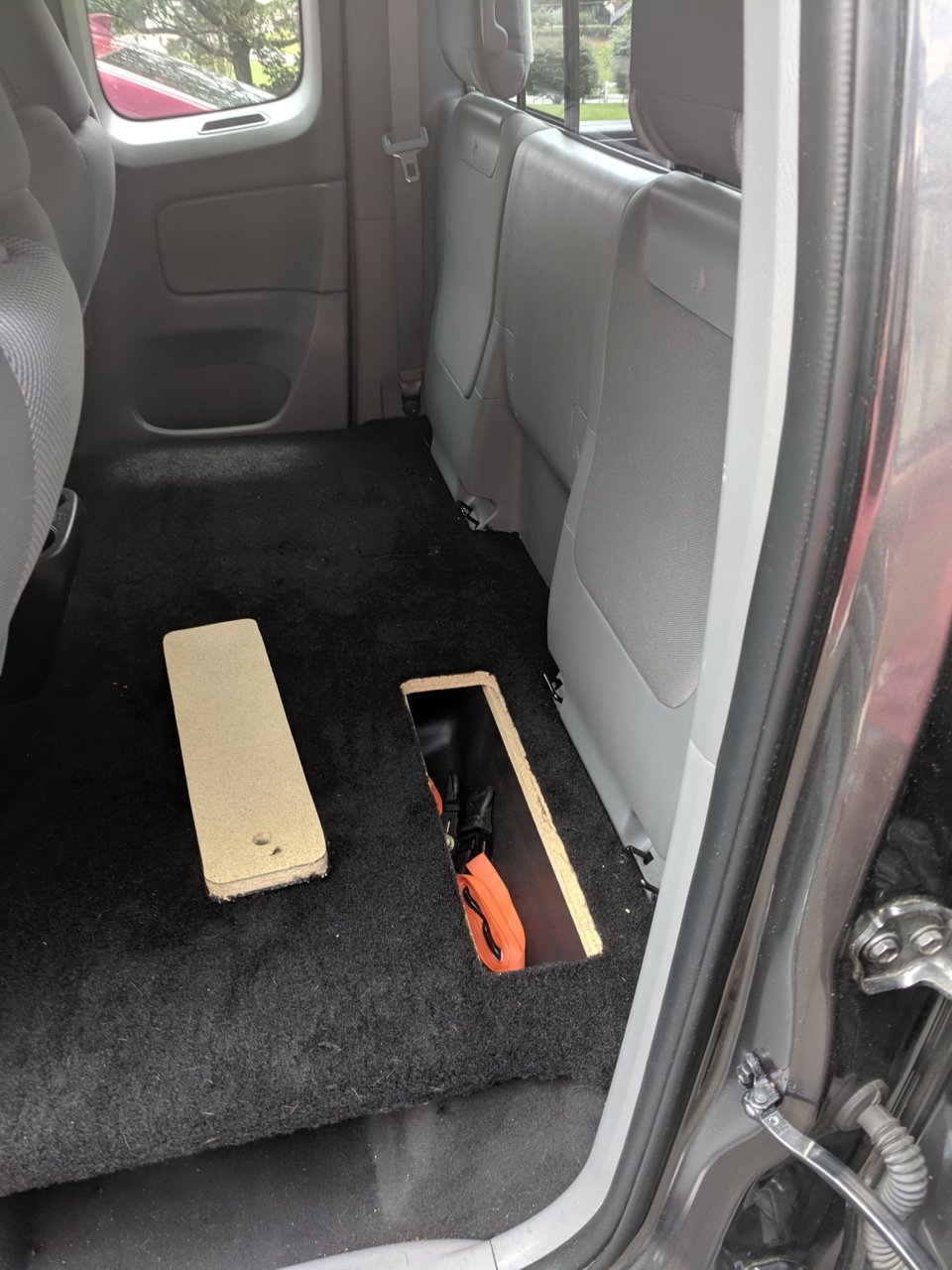

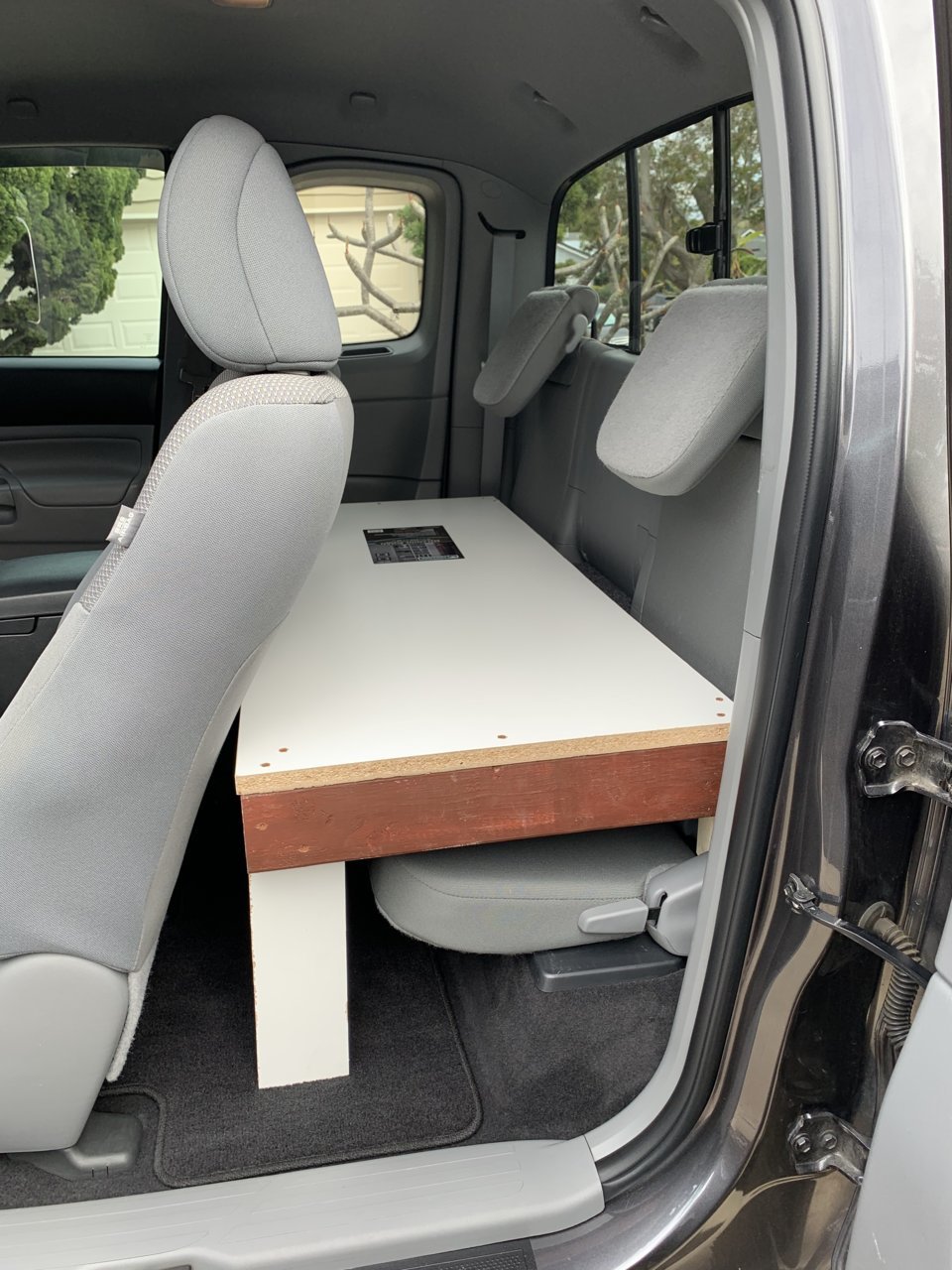

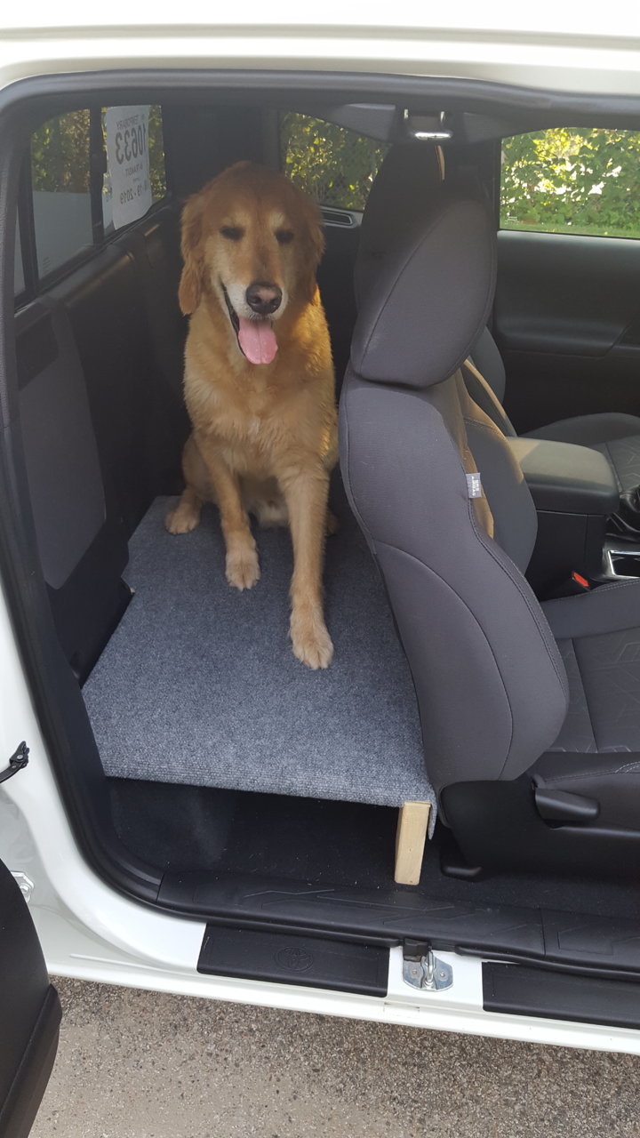

    Made the platform for the dog this weekend. Removed the seats and the center cubbie. made a cardboard template and went to cutting. used 3/4 MDF and used standard 2X8 for the front support and that worked out well. just made some plunge cuts with a circular saw and a jig saw for the openings to access the storage underneath. Ordered the carpet material from an online store. glued the carpet with 3M Super 77 adhesive, and stapled everything around the edges.

    Thanks for this thread everyone. It sure helped me out!
    Still need to add carpet to the platform legs but came out great.

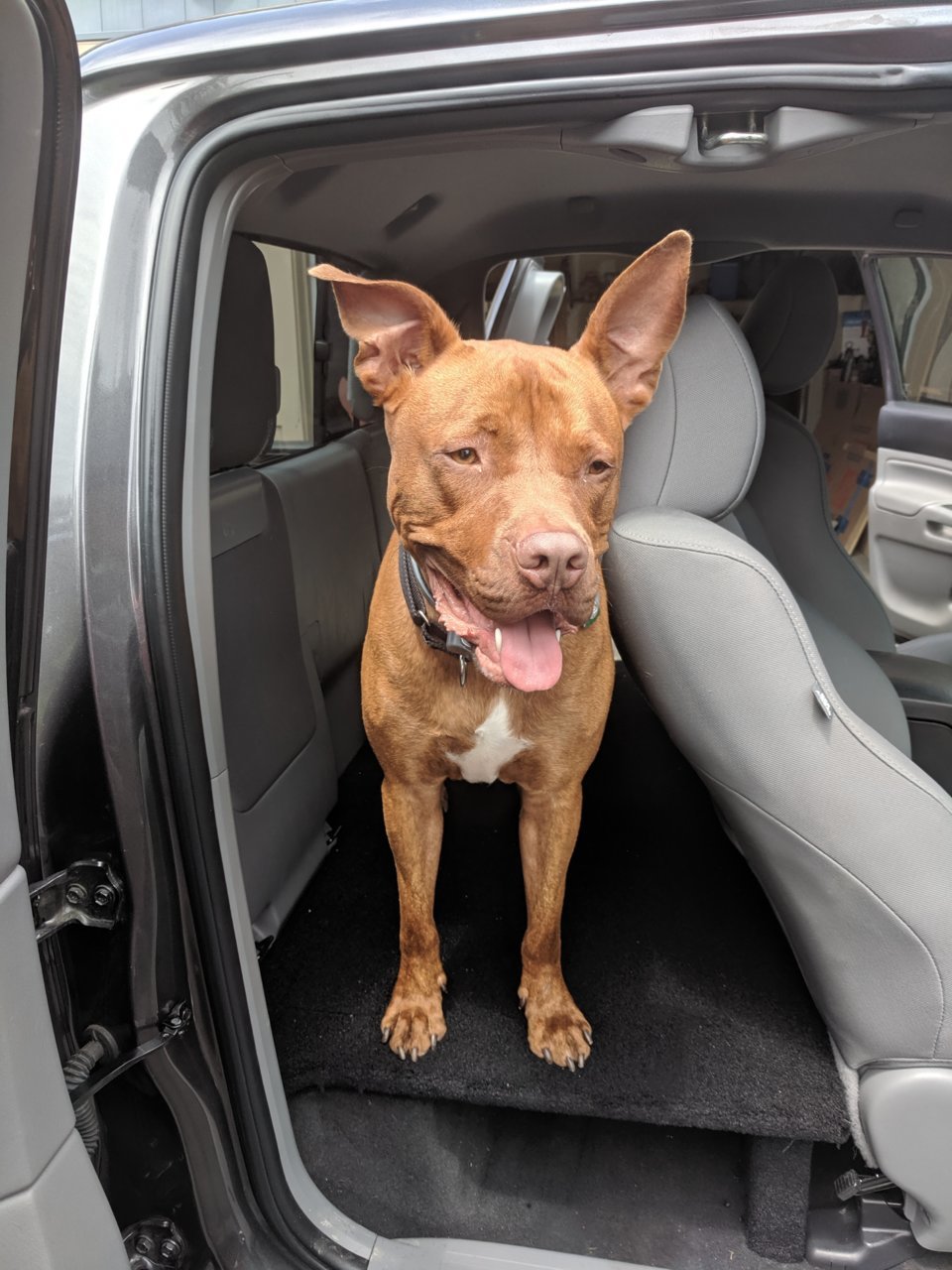

  14. May 16, 2020 at 10:40 PM
    #354
    TacoNoVeggies
    TacoNoVeggies Well-Known Member
    Mar 29, 2020
    #323309
    374
    San Diego, CA
    '20 Off Road ACLB Quicksand
    Stock

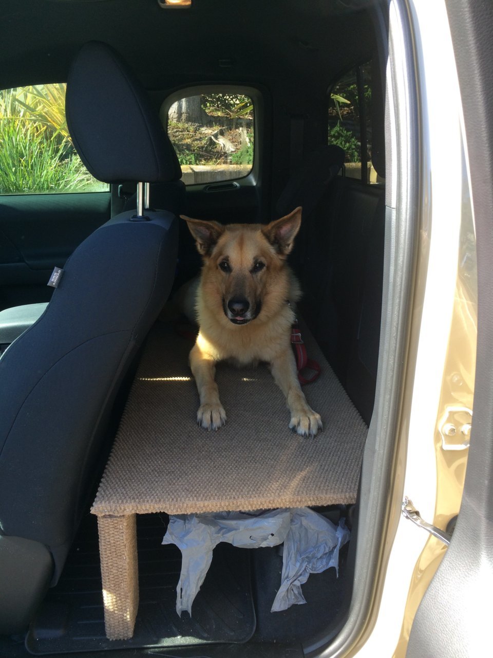

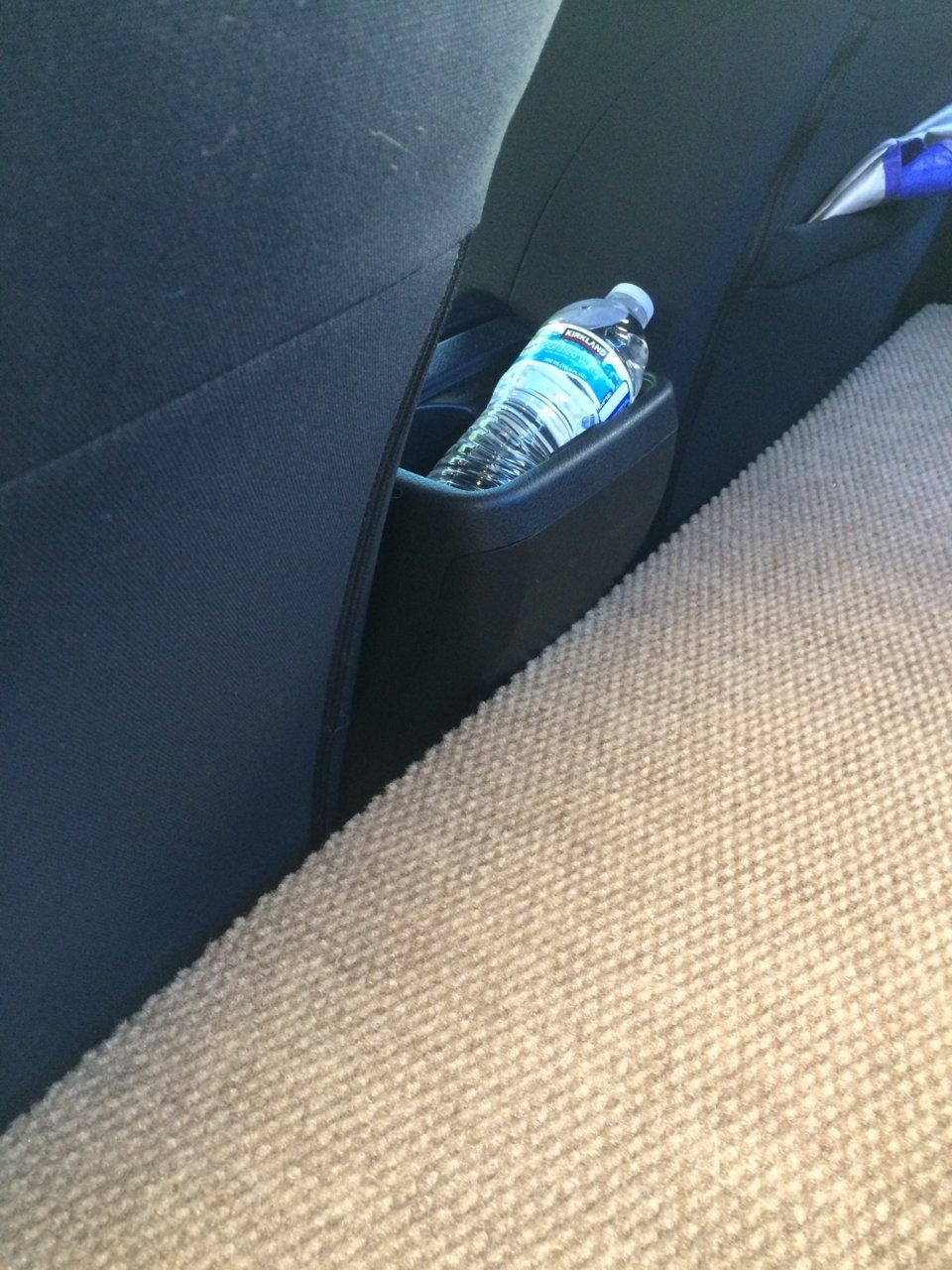

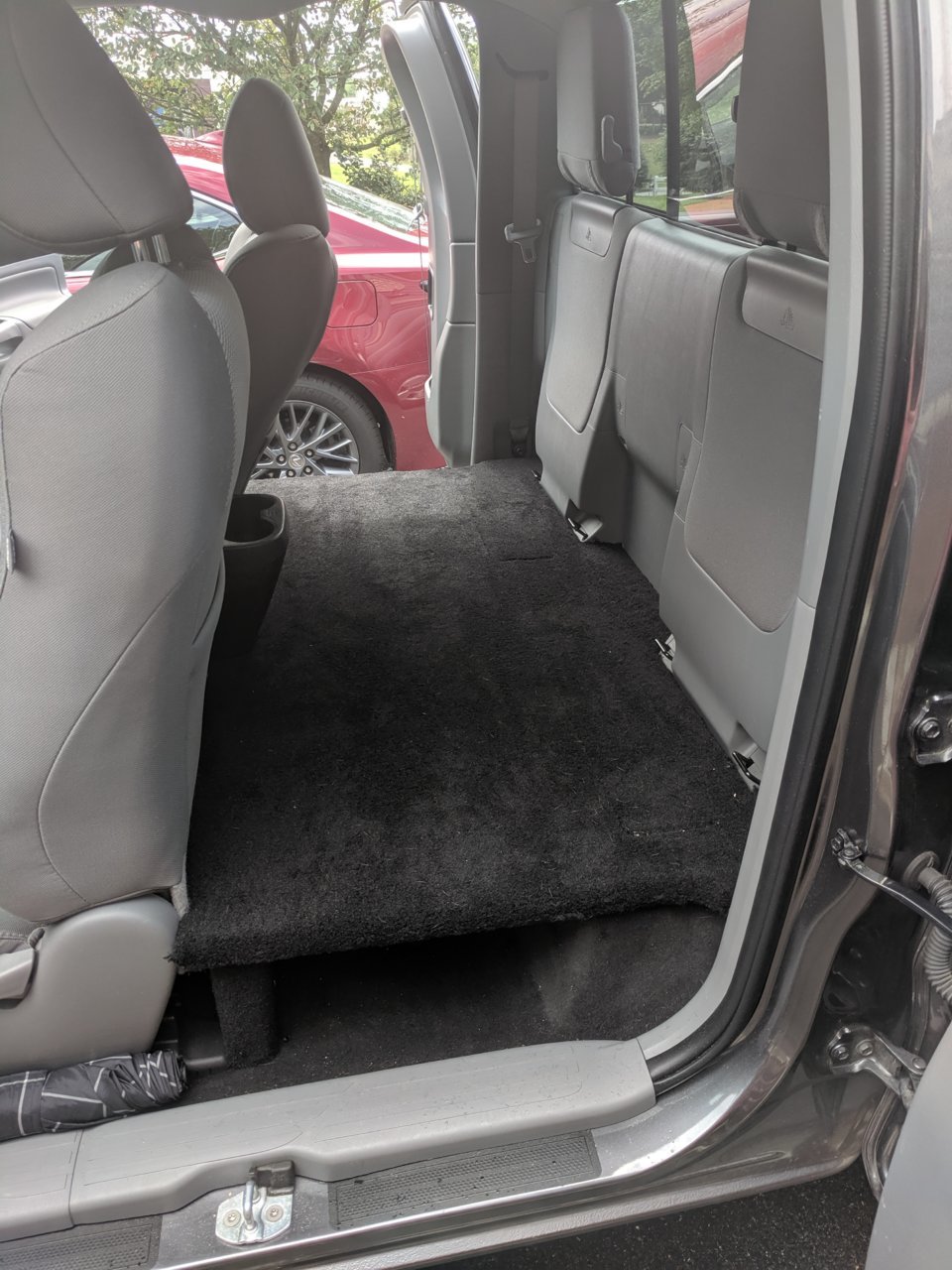

    Finally got around to importing the pictures. Wanted to keep the rear jump seats in. This was supposed to be the practice run, but didn't turn out too bad, so might be a keeper.
    I'm no handyman, but I have heard measure twice, cut once. I measured all cuts twice, wish someone would have said to measure the back seat more than once. That being said, the limiting factors in the cuts were how far back the board "sits" when laying on the seats and where the board contacts the center console.
    After two additional cuts, the platform came out to 20 3/4" with the carpet installed (EDIT: just saw I have about 1/4" gap as the platform wasn't pushed all the way back in the picture. You might be able to get by with 21"). This requires you to put the platform in straight up/down near the console and lay it back towards the seats. Putting it on the seats first and laying it down hits the center console. The length was only cut twice and came out to 51 5/8" with carpet installed. Legs are 10" long
    I'm 6'1", and I have more than enough room to put the seat back as far as I need to for an A/T (this model didn't come in M/T). I might need to put the seat back another inch or two if I was driving stick.

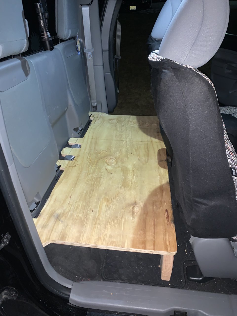

    My platform. Paint to come

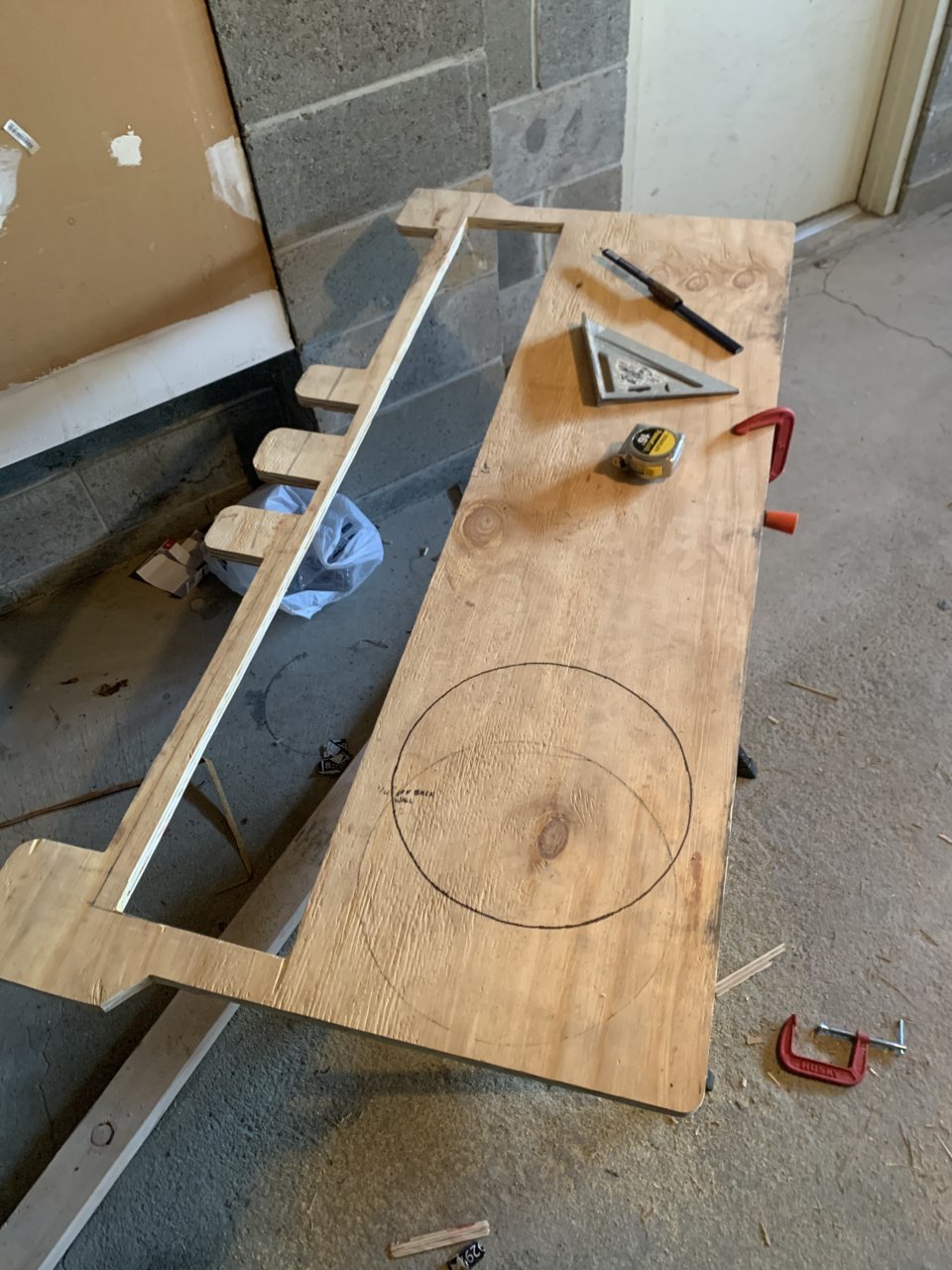

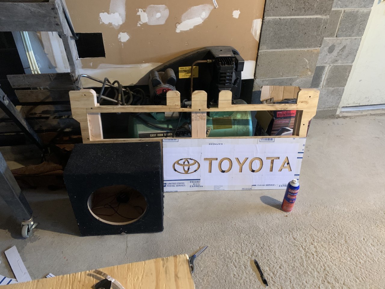

  19. Jan 31, 2021 at 5:54 PM
    #359
    Joeyourbro
    Joeyourbro Well-Known Member
    Jul 19, 2020
    #334945
    327
    Joe
    Vegas
    2015 2.7 5MT
    This thread was a great help. I’m gonna have to post pictures of it done tomorrow so long as I have off work to put it together. The support is better now than the uncarpeted pic and it still needs some pull handles for the cubbies. Was trying to fit my 12” sub with a box there but it didn’t work out.
