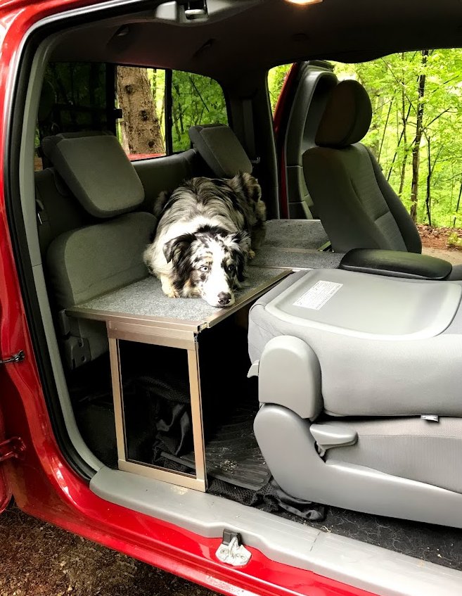

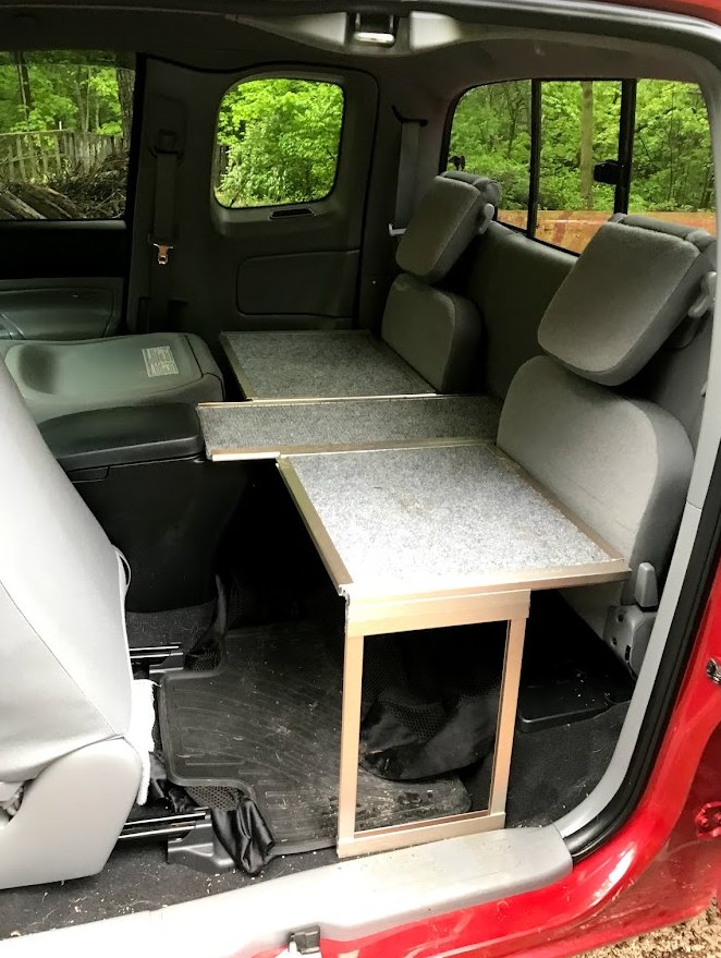

    this..
    becomes this...

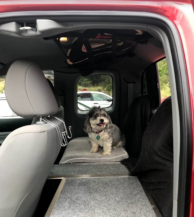

    The center panel is stationary, locks into the cup holders of both center consoles. The outside panels both hinge off the center. On the drivers side, it hinges down, resting on the storage cubby, and makes a ramp for the dog to climb in the truck. On the passenger side, it hinges up 90 degrees and slides forward to be completely removed so that the passenger can recline for sleeping. Weighs next to nothing. 3/16" MDF covered in indoor outdoor carpet, inserted into aluminum shower door channel.
    Throw a black fabric shower curtain over the seats to keep hair/mud off. dude is riding in style.
    My 60# Aussie loves it, and is able to see 360 degrees while laying down. But even my girlfriends toy mutt can see out the windows.
    his standard disposition

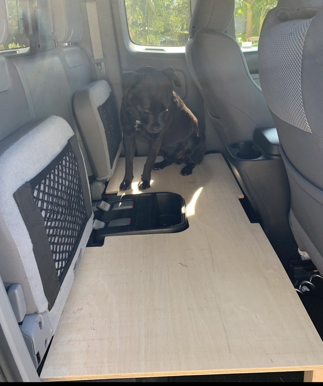

    2012 Black Tacoma TRD access
    First thing I did.. some plywood and a dog bed.

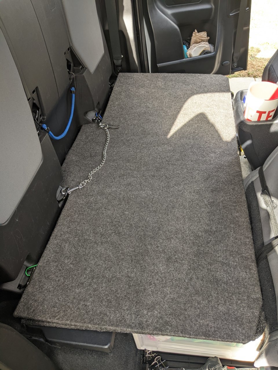

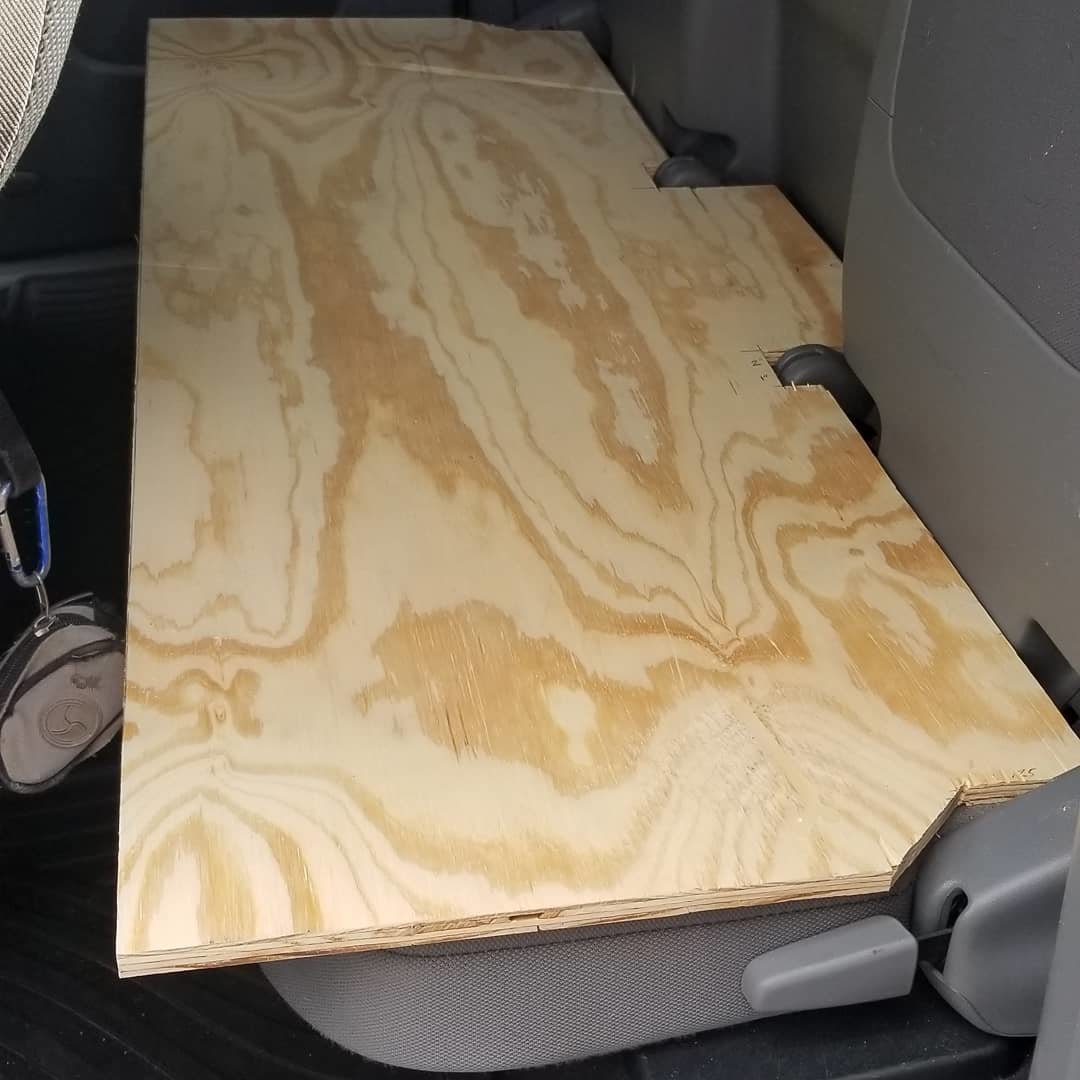

    Lots of good stuff in here, feel obligated to share how I did mine. Wanted as much vertical as possible so elected to cut out the center.
    final version got the carpet treatment similar to others.
    dog loves it. no longer begs to ride shotgun or in a lap.
