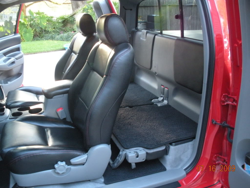

    Very nice additions for any dog.
    This was one of my first mods. Since I am 2008, much easier. I just needed carpet.
    dash! likes this.

    Clazzio seat covers,
    No question ... the full fold down seats were ideal ... not sure why they (Toyota ) changed it ... although now with the offer of no rear seat they may have seen the error of their ways ...
    My solution ...
