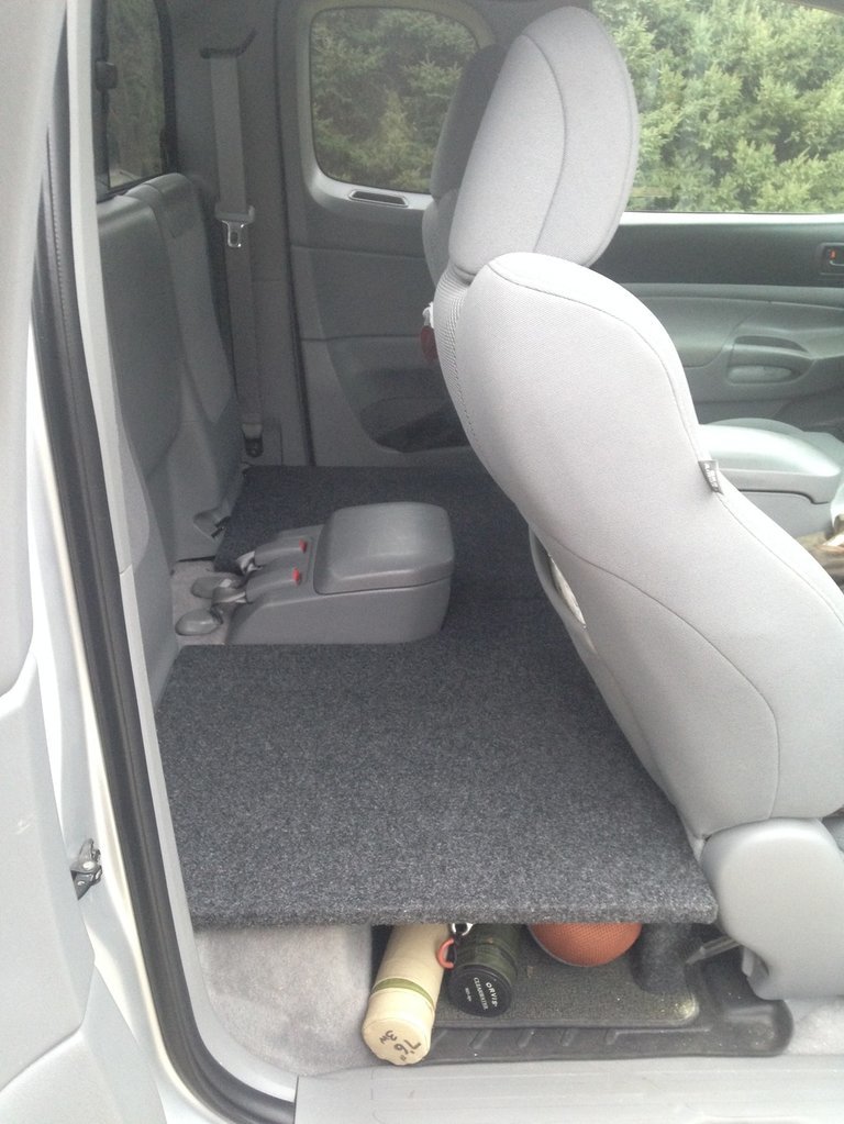

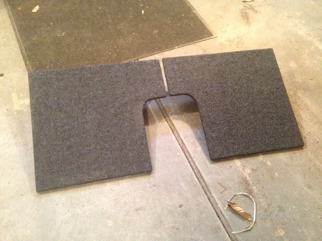

    So I made my dog platform pretty much the same as everyone else.
    I used some left over 3/4 plywood and some scrap carpet I had and one 2"x3" about 45" long.
    I cut the 2"x3" into 4 legs the same height as the folded seats so that the platform is mainly supported by the rear seats but I still wanted them there incase I need them. It just so happens that I can still slide my ammo cans in perfectly under the platform.
    I made it as tight of a fit as possible so no paws can get stuck anywhere and I can use the rear seatbelt to clip in a harness strap for my pal to prevent him from flying around.
    I made it as sturdy as possible because this is my pal Lou, he is almost 7 months old and about 70lbs, and he is nowhere near finished growing.
    I also removed the lids on the compartments under the seats, so with nothing on the platform I can tilt it up, flip up a seat and have easy access to whatever I need.
    Sorry for the pics being sideways.
