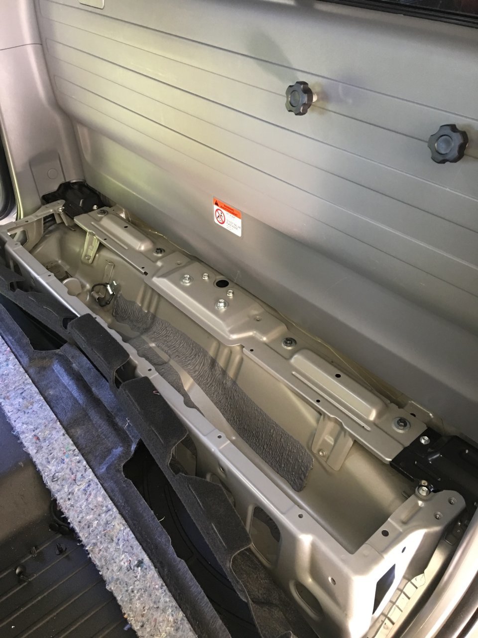

    Did you cut or hinge anything to get to the storage bins.
    I'm doing this mod soon after I find more time. Our trucks are twins...

    This is the bolt(s) arrangement underneath everything.
    Missing is the corner pieces that support each rear corner. My truck is a utility package so no rear belts or seats. If you look close you could also capture the very strong nut that holds the webbing reel to the rear seat belts. You would have to remove the rear set be,to to do this though. Not sure if that much work is what you want. You can see the two large bolts towards the middle, those are you buckle securing bolts. I may try to use the corner reel bolt location since I don't have anything there, I'd should work great to secure each rear corner as I might want to secure items to the platform and not worry about them coming o ear on me in a crash.
