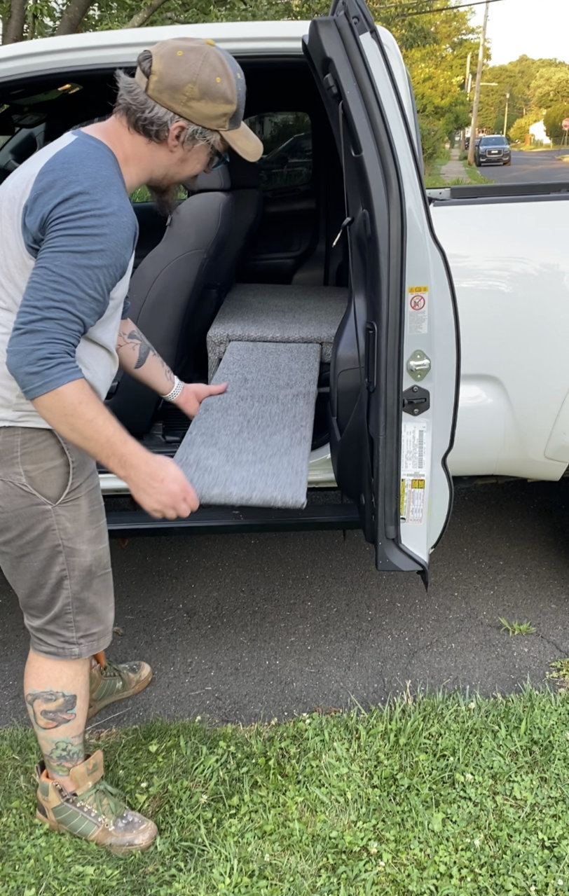

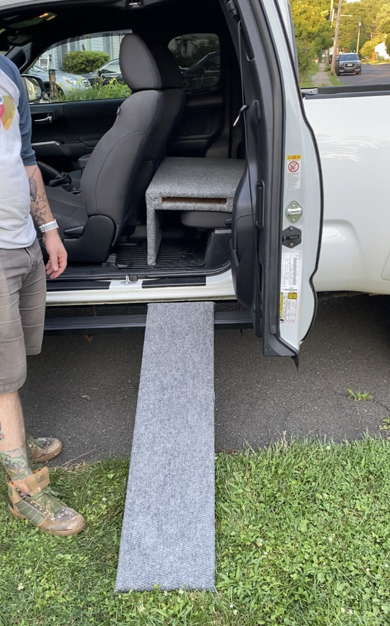

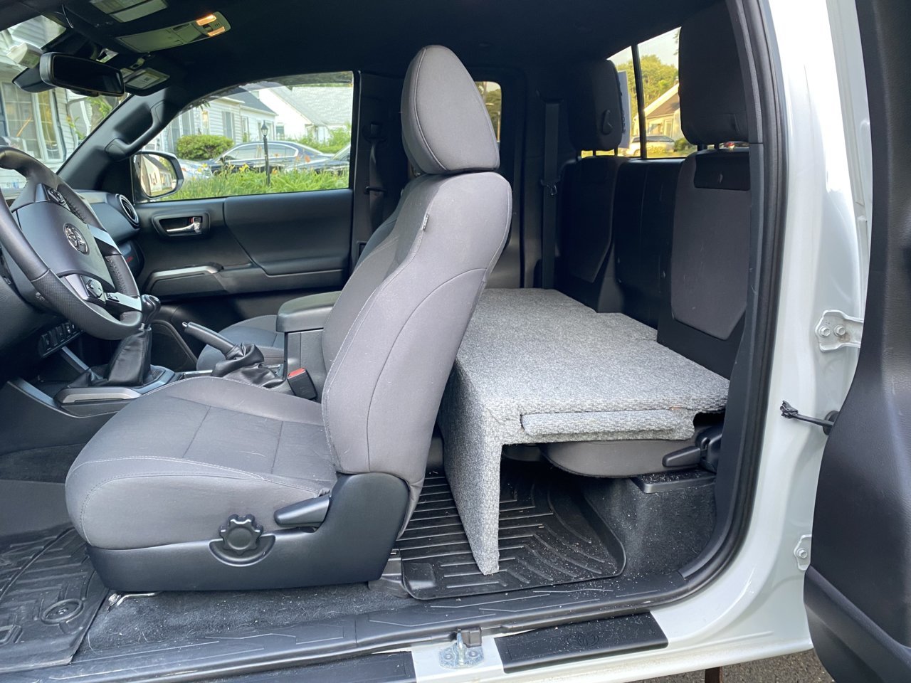

    Hey all—new Tacoma owner and new to the board. One of the things I didn’t like was how un-dog friendly the access cab was. So I decided to do something about it and I made a platform with integrated ramp for the dogs.

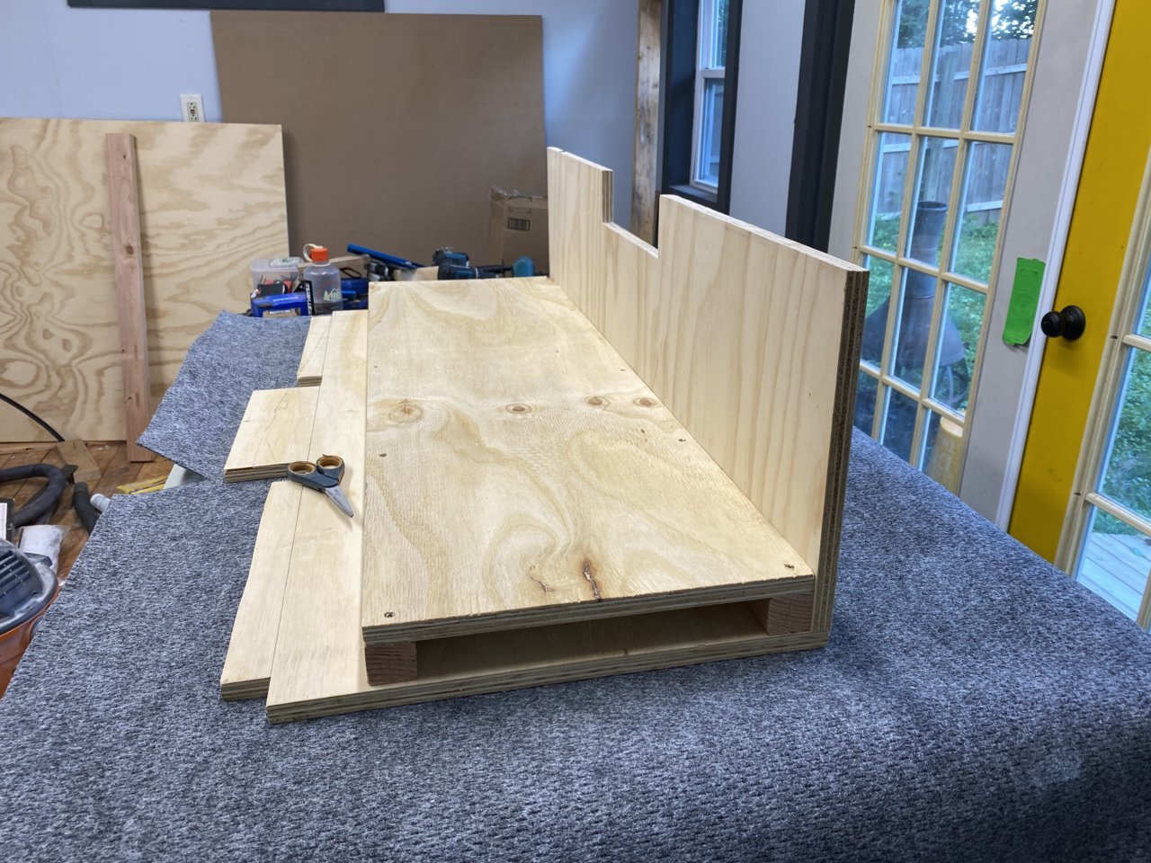

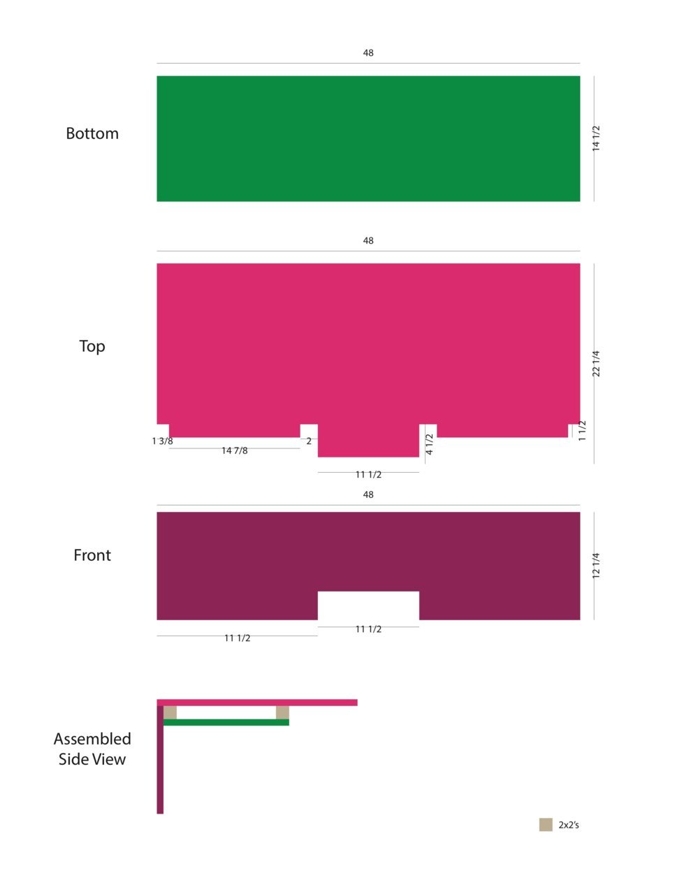

    here are my rough plans. The rug was just a cheap $20 rug from Lowe’s.
    the ramp is just cut to the width of the opening.
    oh also made with 3/4 inch plywood and 2x2s
