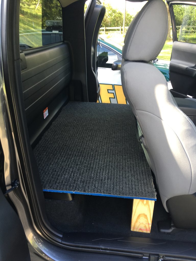

    I have a 2017 access cab with the "rear seat delete".
    After looking at several threads on here, I decided to make a dog platform for mine.
    I bought a sheet of plywood, a 2x4, an outdoor area rug, and some spray adhesive. I had wood screws as well.
    The platform measures 51" x 26". The 2x4 feet are 7 1/2" long. Plenty of room underneath to stash guns, gear, etc.

    So are the seats all the way back?

    No, they are in the position I use though. I'm 5'8".

    Great idea and execution. You may want to consider adding a hook or loop to clip your dog into. I recommend using a car safety harness for your pets, I've seen nasty accidents with pets flying after a crash or even taking out the owners.
