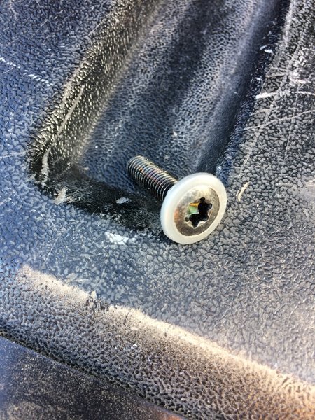

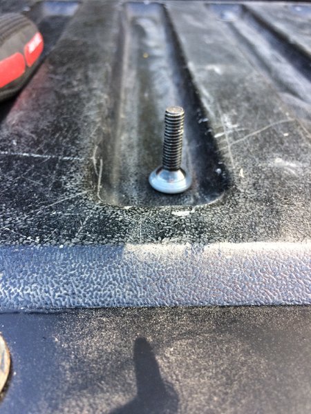

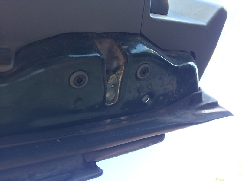

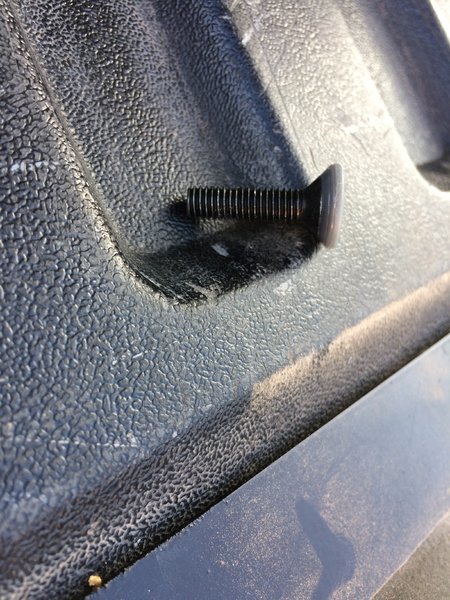

    Bringing this thread back to life because i need some help and couldnt find it with a search. Today i looked at the rear doors on my access cab because the passenger side was making a terrible rattling noise. Turns out, 2 out of the 3 bolts holding in the striker at the bottom were missing with the third 75% of the way out.. does anyone know where i can get these bolts at or have a part number for them?
    They are a T30 torx head with some sort of plastic/nylon near the top, which im assuming acts like a nylon lock nut.
    Any help would be greatly appreciated, heres a few pics below of what they look like and the area that they came from (lower striker/latch on access cab rear door)
